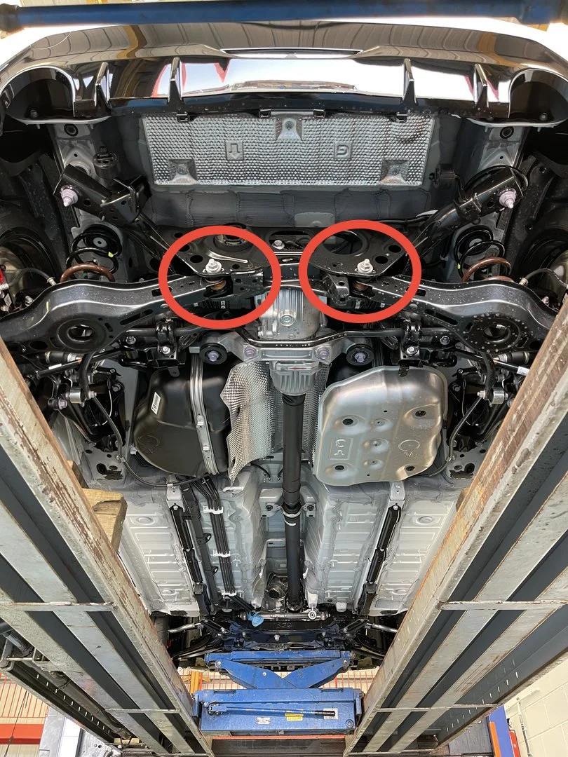

my car is quite ok for road but neutral on track. Although occasionally it breaks into mid corner oversteer if pushed. I'd say on track you can run more aggressive setting whereas on road as its more uneven and surface changes too aggressive can bite you if not aware. just be cautious.
On stock suspension @Michael Knight? What geo settings are you running?
yes stock. 2' 45min front, 2' 30 rear (neg camber). slight toe out front (was it 0.06 or so) and rear small toe in.
If I'd adjust I'd add front camber to 3 or even to 3'15 and maybe reduce rear camber a click.
How Is your tyre wear across the tread with your current settings? I don’t expect miracles on a geo tweaked setup regarding even wear but I can accept that as a trade off for something that has awesome handling 😊
