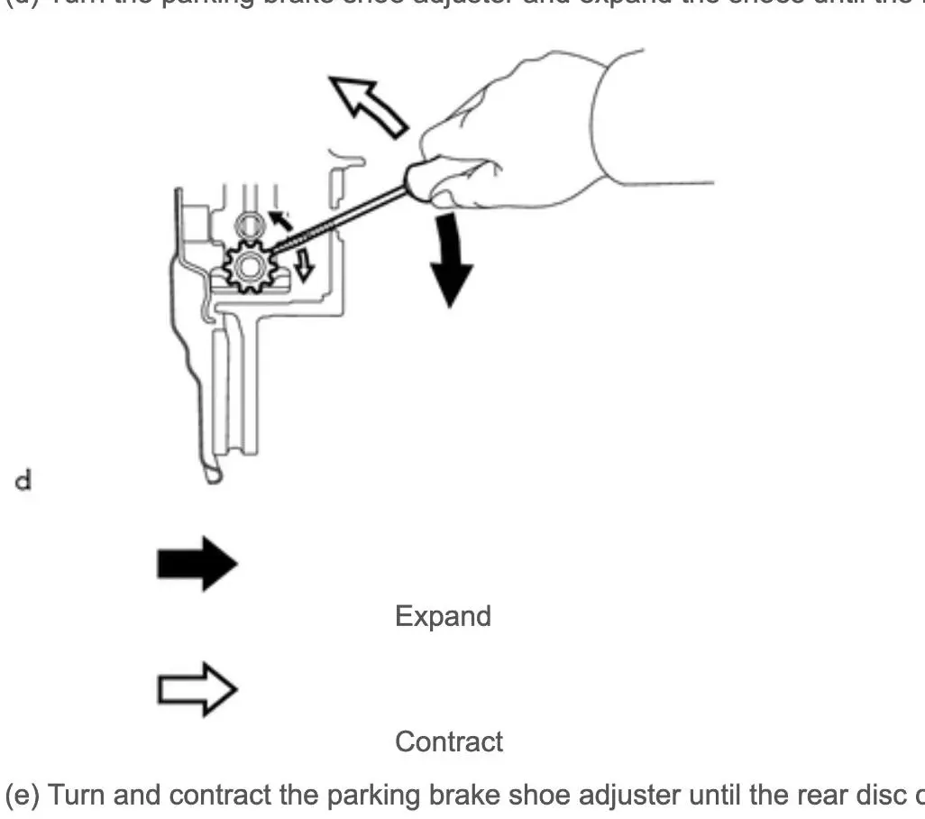

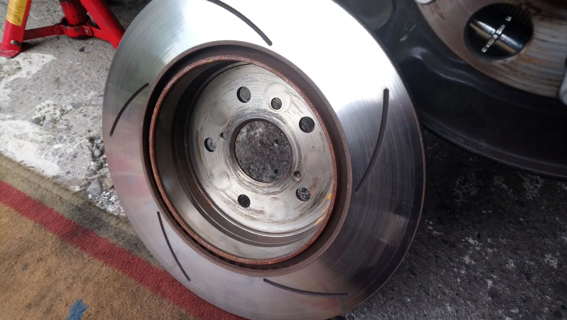

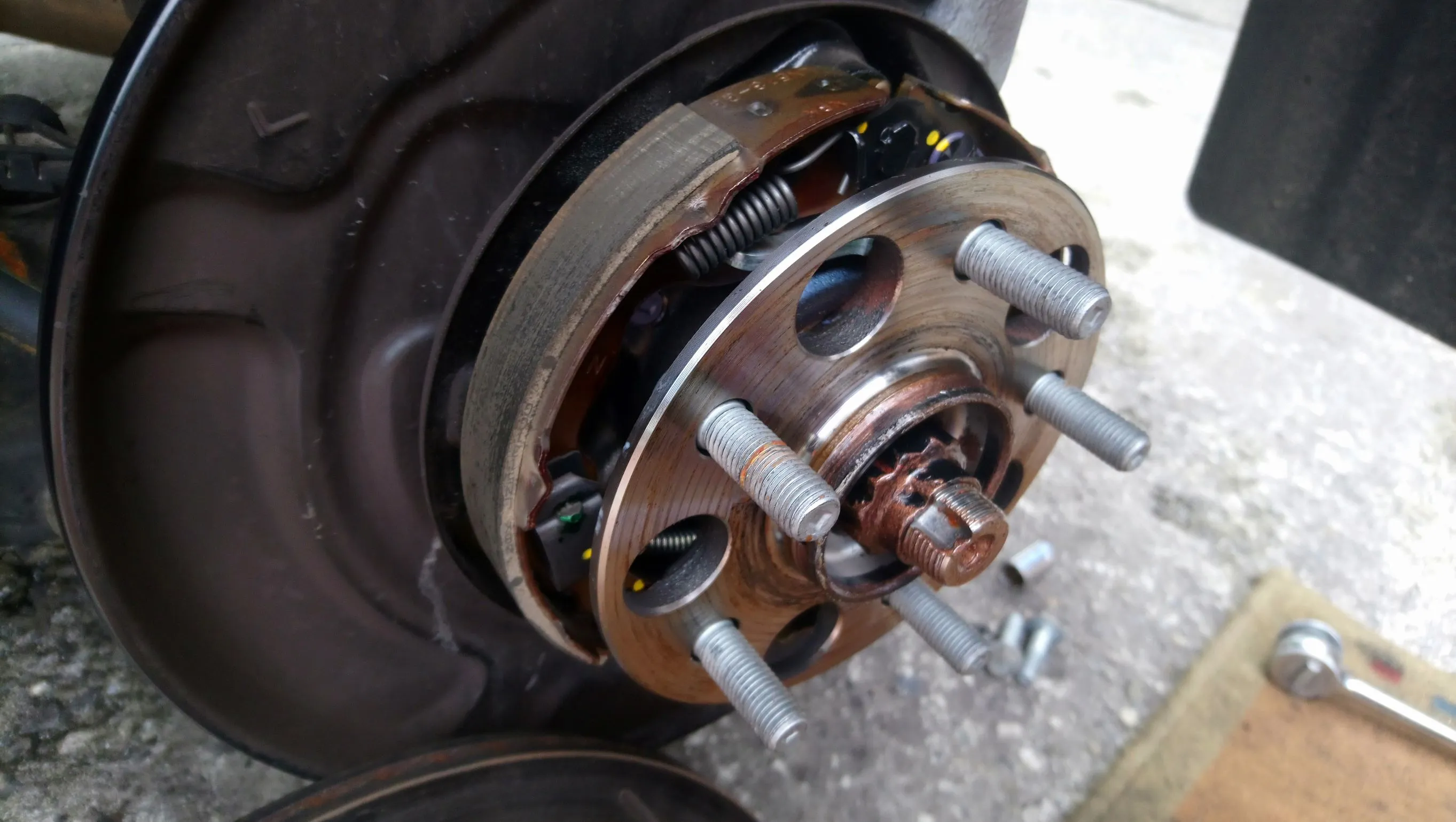

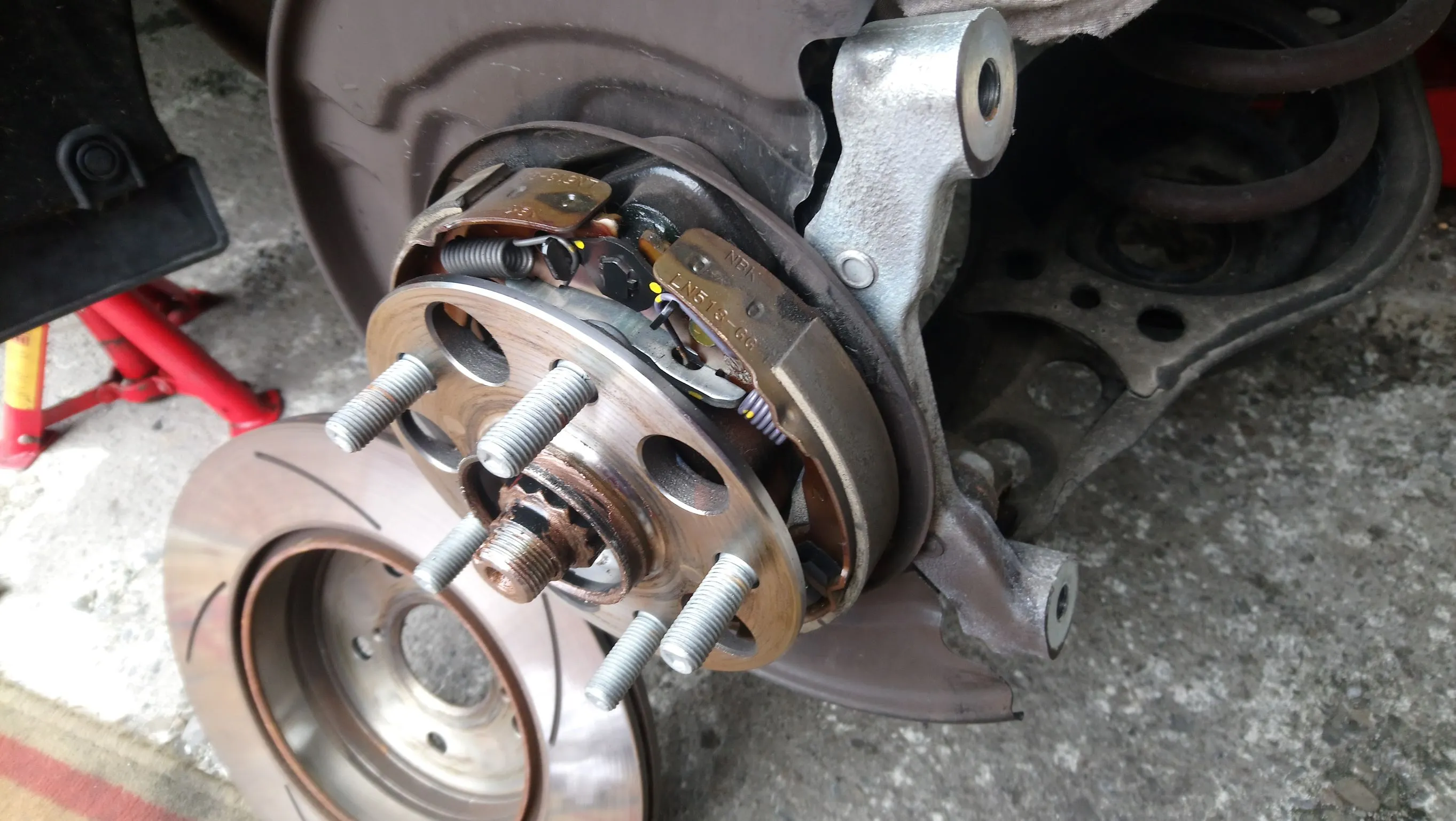

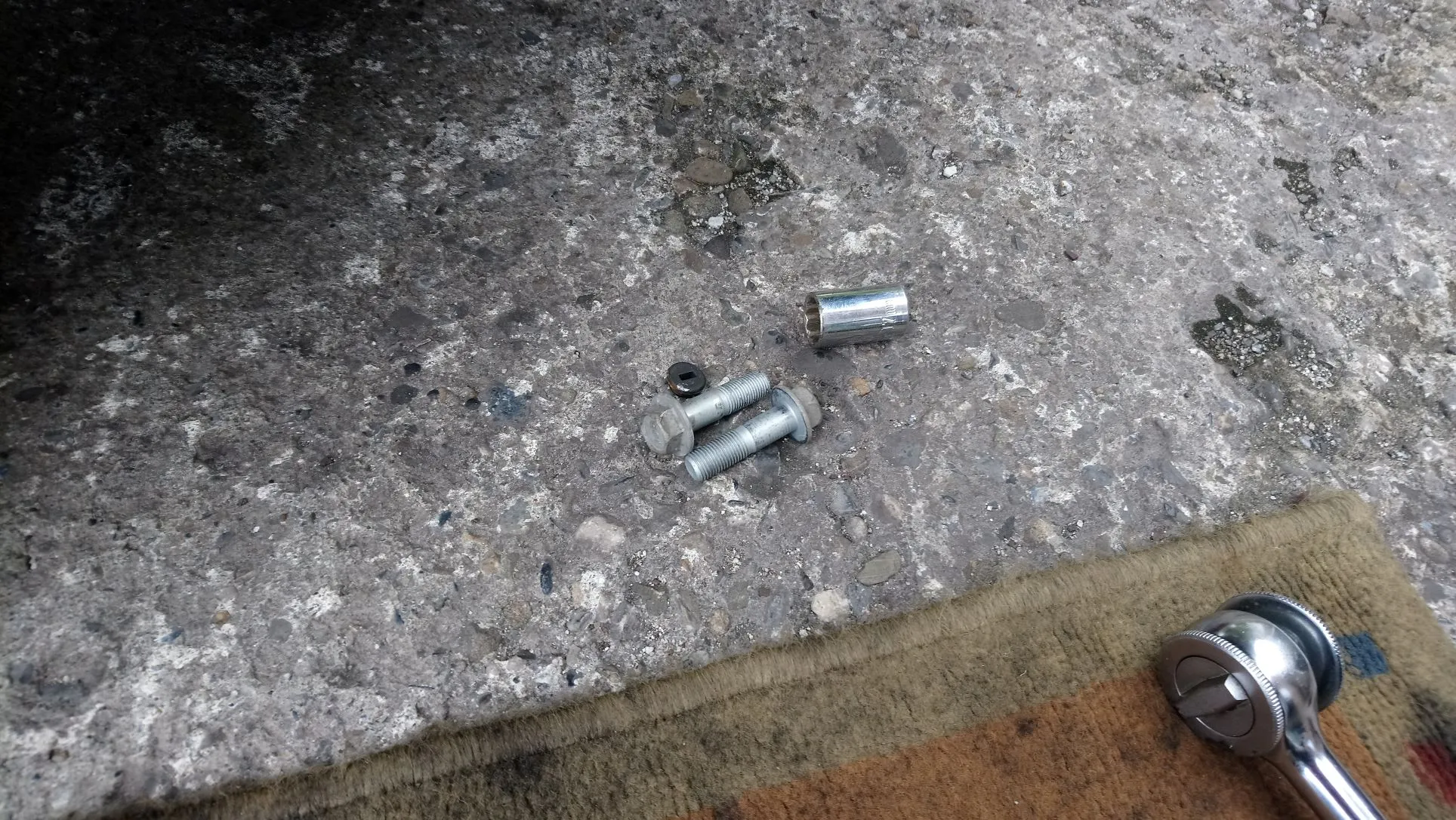

2x 17mm bolts rest caliper on top suspension arm
remove rubber bung from adjuster access hole
click adjuster back so disc will come off
de-dust shoes and drums - clean surfaces
rebuild in reverse order

Foxspeed can you remember which way to back off the adjuster for drum removal.
Is it flick the wheel upwards ?
Is it the same for both sides ?
That’s what I usually forget when I’m sat in front of one.

Do our hand-brake drums have self-adjustment capability, like regular rear drums usually had? With those, any time you hit the brakes while traveling in reverse, if the shoes were too far from the drum they'd move far enough to actuate the adjuster.
If we have that, activating it would require engaging the hand-brake while travelling in reverse-- not something that's going to happen often of its own accord.
