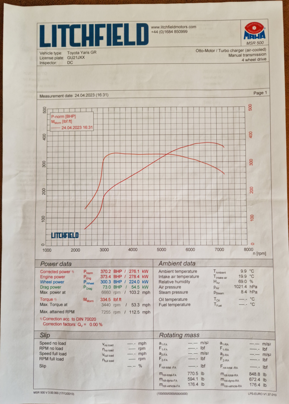

Wanted free access to the maps and Litchfield lock theirs. Also the Litchfield map, although very punchy, was a little snatchy low down as you can see from the graph. Also SRD are closer to me.

Nothing against Litchfield, Ian was great to work with but locked maps on a stand alone ecu defeats the point. Basically if I wanted to tweak the maps with another tuner, I had to wipe & reboot as the Litchfield maps are locked to them. Kind of defeats the purpose of a owning a standalone ECUI see, makes sense. Thanks for the info.

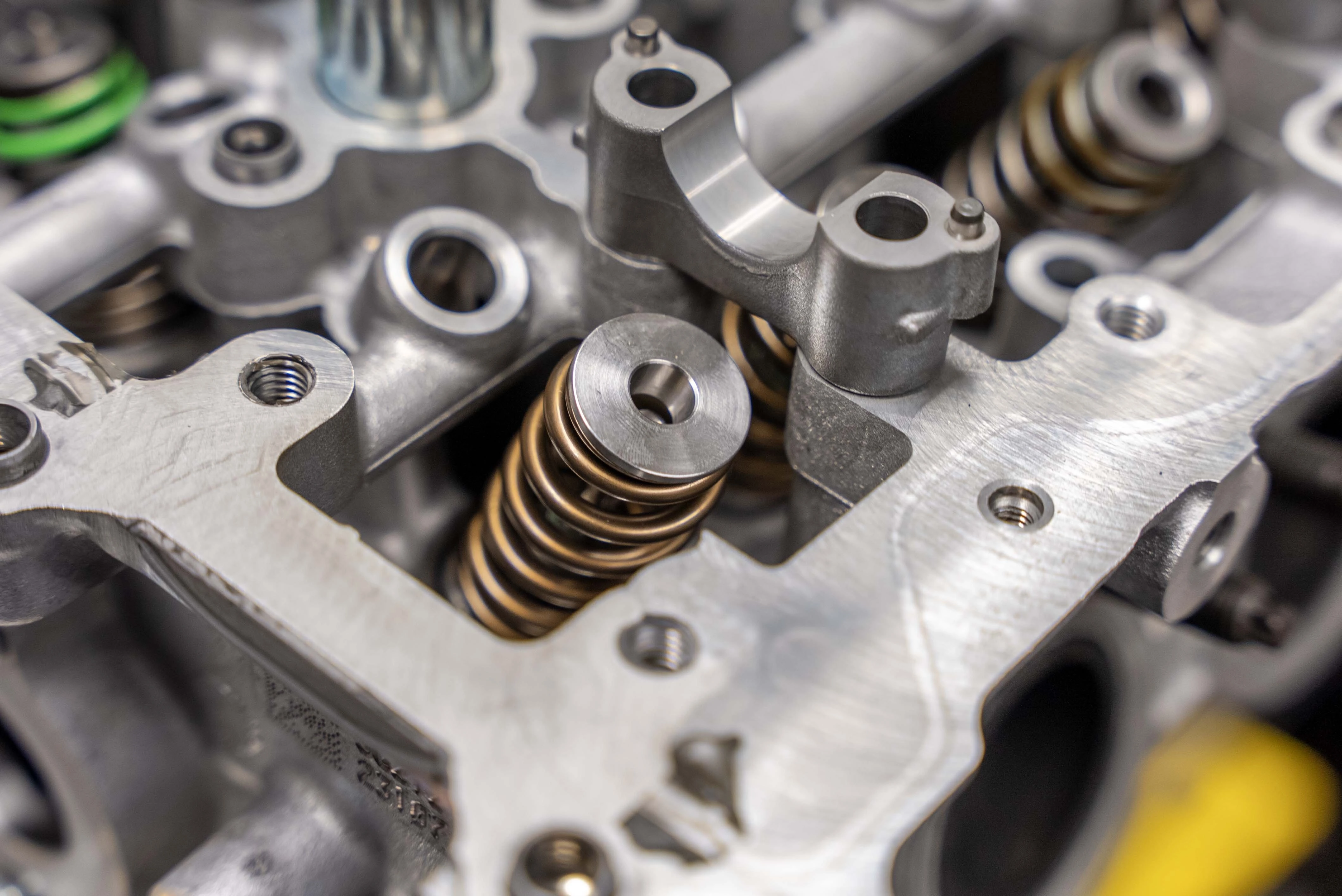

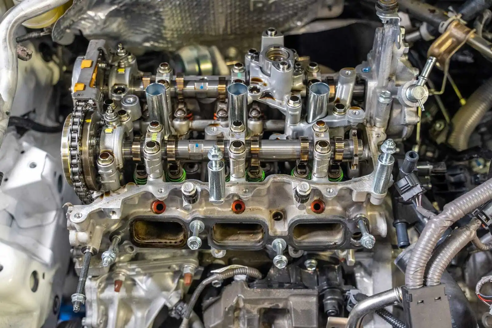

Had been running DTUK stage 2 and breathing mods only for the best part of 2 years of ownership but recently decided to throw caution to the wind and pull the trigger on Kelford cams, valve springs, decat downpipe, Syvecs and get it properly mapped.

Happy to report that following the build work and mapping at Litchfield, she's now making circa 380bhp and 450nm with launch control, flat foot shifting, rolling anti-lag and Syvecs advanced traction control strategy all engaged.

Kelford A-profile Cams
Kelford Springs & Retainers
HKS uprated Head Gasket
Lamspeed H13 Headstuds
