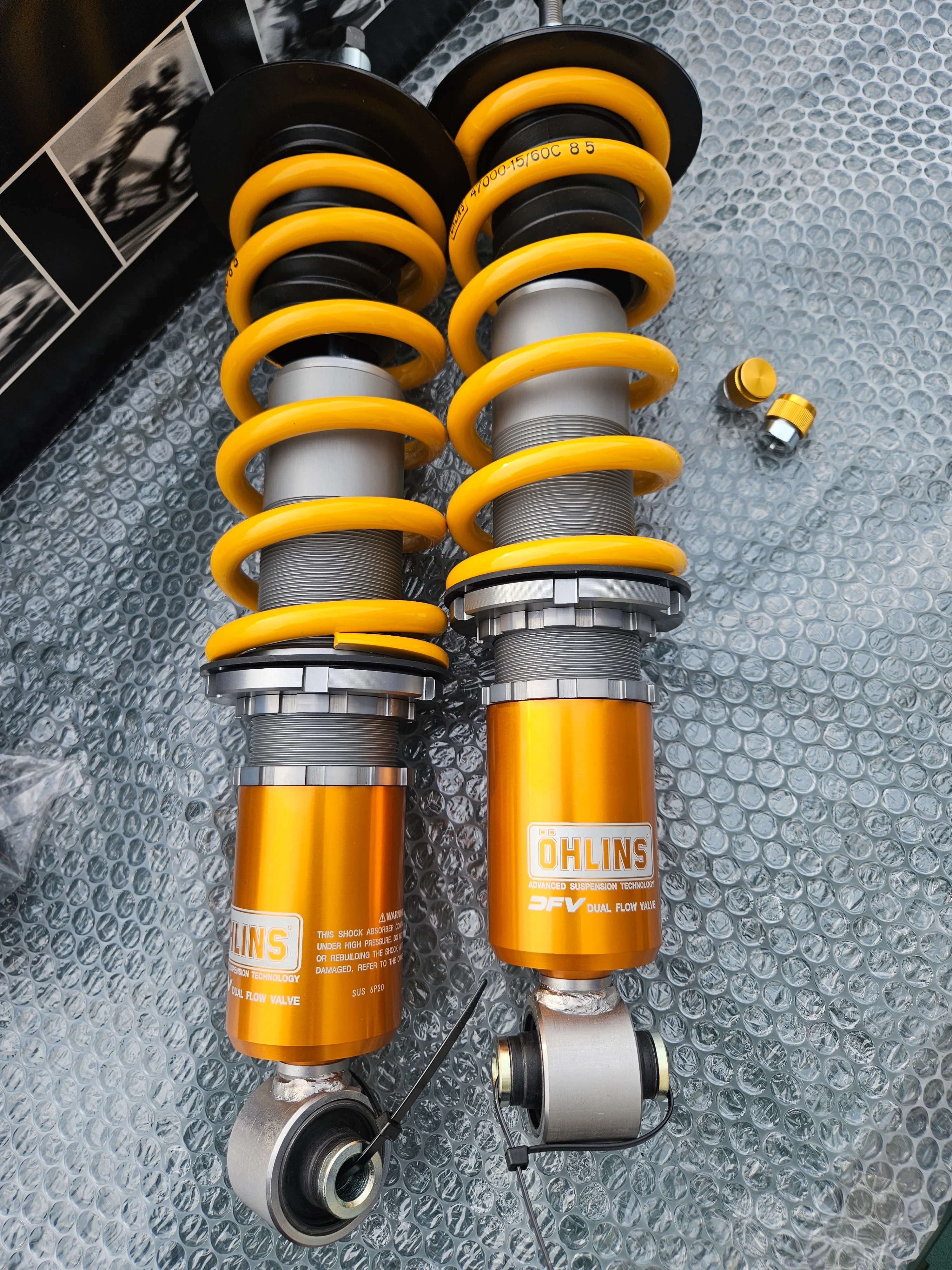

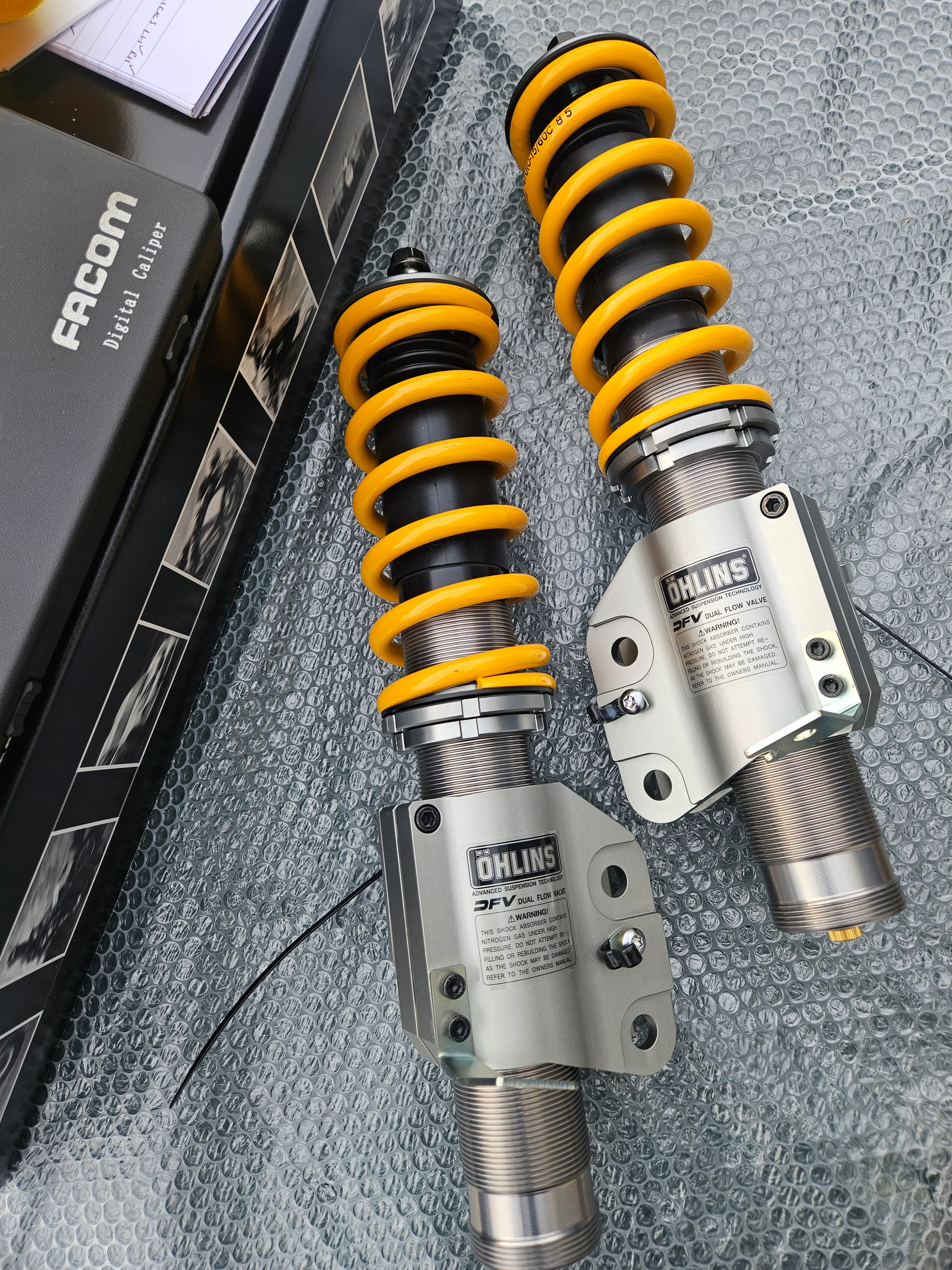

To avoid any unwanted surprises during the install week, I completed the kit assembly on the Saturday ahead of our customer drop off. I was able to complete the front and rear damper assemblies, all except for the top mounts. Ohlins do offer adjustable camber top mounts as an additional cost option. However, for this customer application, we used the OEM top mounts and Eibach camber bolts for the front.
There is zero camber adjustment available from the factory, front or rear, so it is important to plan and factor in any other supporting hardware you require to achieve the target geo settings.
So, this was as far as I could go with the Ohlins assembly until we receive the car and remove the OEM dampers. It's then a case of removing the OEM top mounts and transferring across to the Ohlins, and that's the Ohlins ready to install on the car.
Once on the car, spring preload can be accurately set (Ohlins recommend a significant amount of preload, especially on the fronts). We ended up going with a different spring preload given the owners brief to us for his intended application. Then, I set a base ride height on each damper, which I hope will give our target ride height following a road test to settle the suspension. Back into the workshop, measure ride height versus the OEM ride height data we took before commencing works. Adjust as necessary. The car is then ready for a full geo set up.
GR86 Ohlins DFV assembled dampers minus top mounts shown below

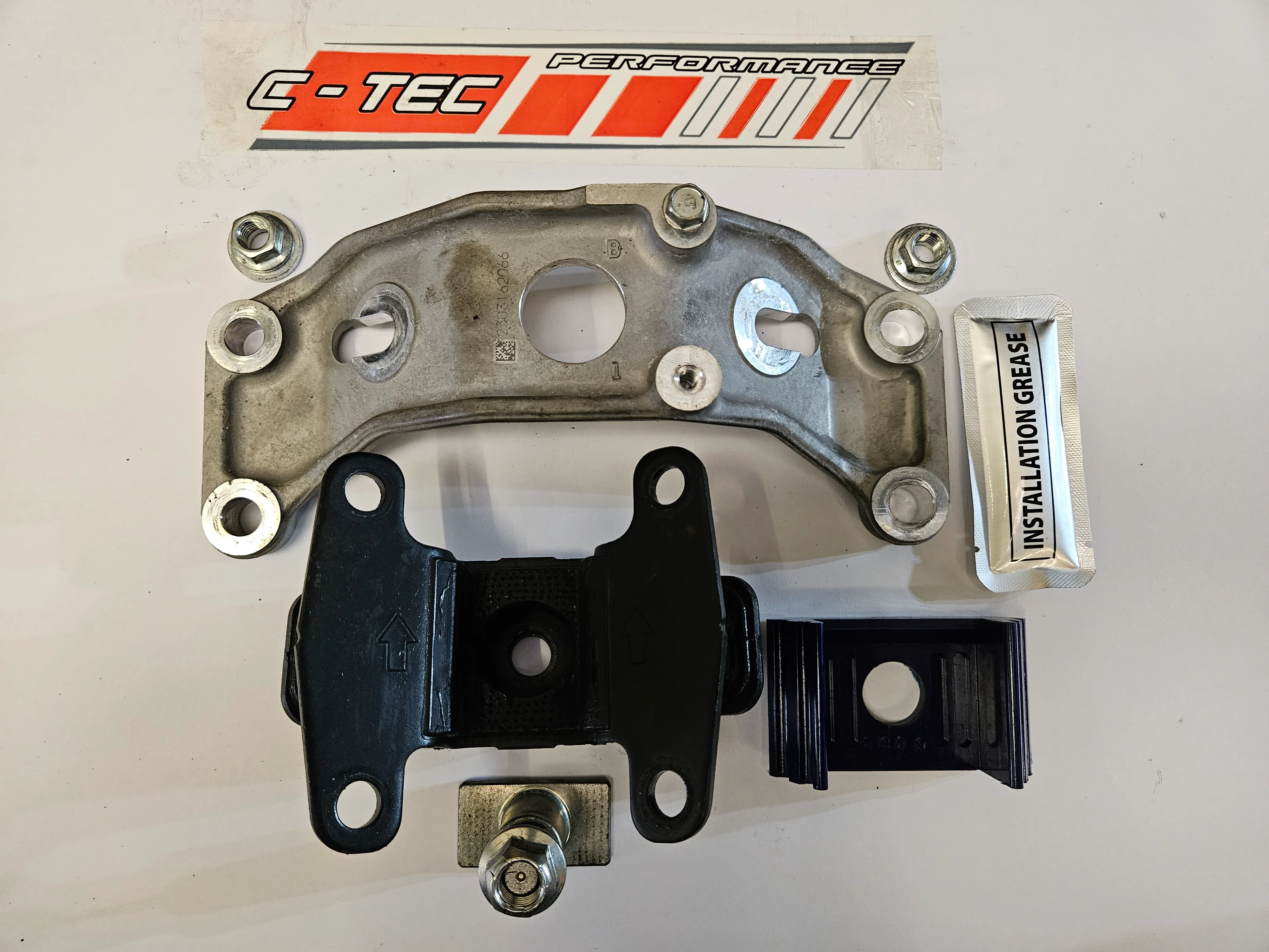

SuperPro gearbox torque mount bush insert
Whiteline rear diff bush mount inserts
MCA Traction Mod kit

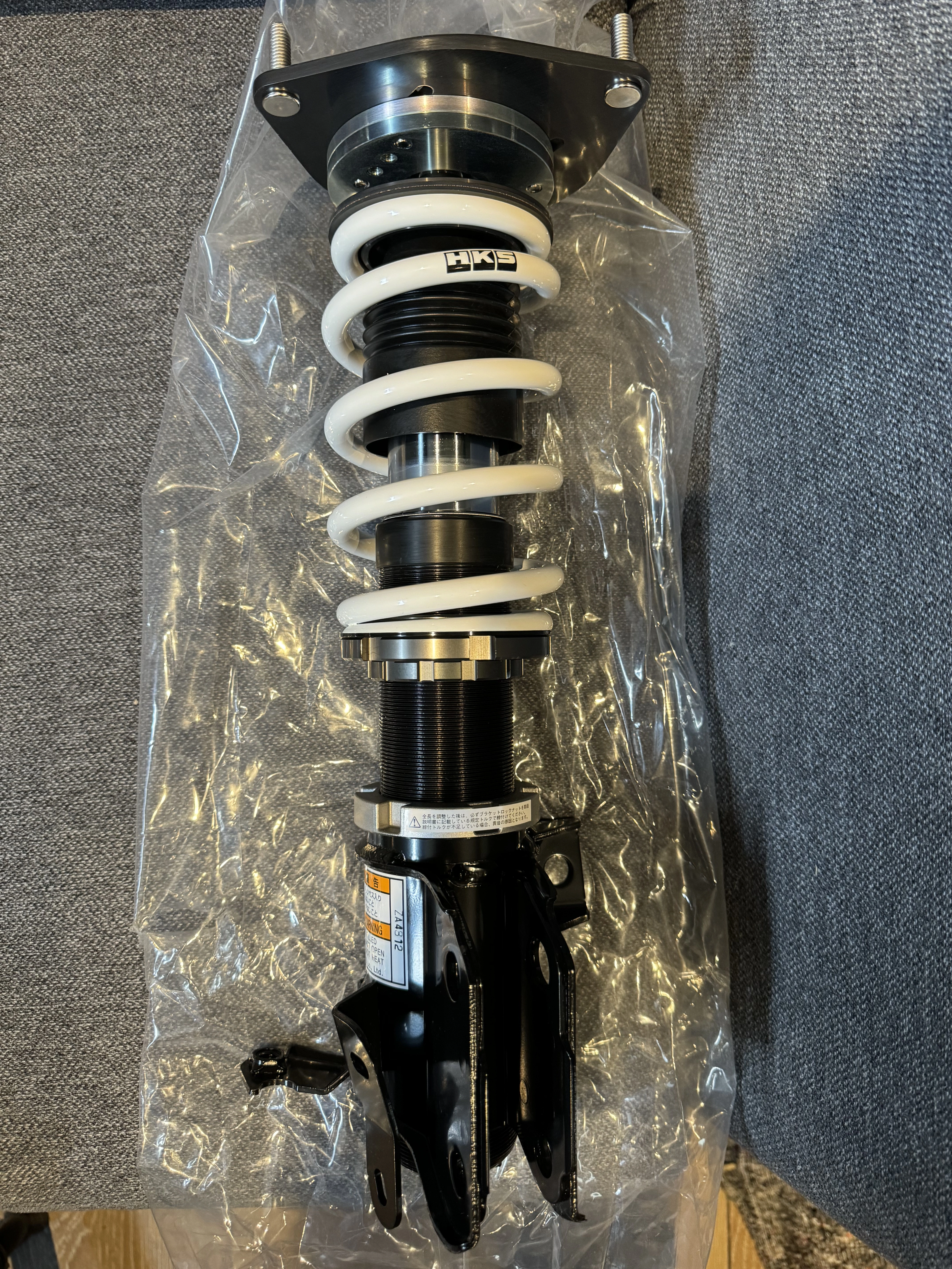

Very nice. I got impatient and went HKS which come with the added bonus of coming pre built and corner balanced. Overall v happy but looking forward to hearing your thoughts on the Ohlins setup.

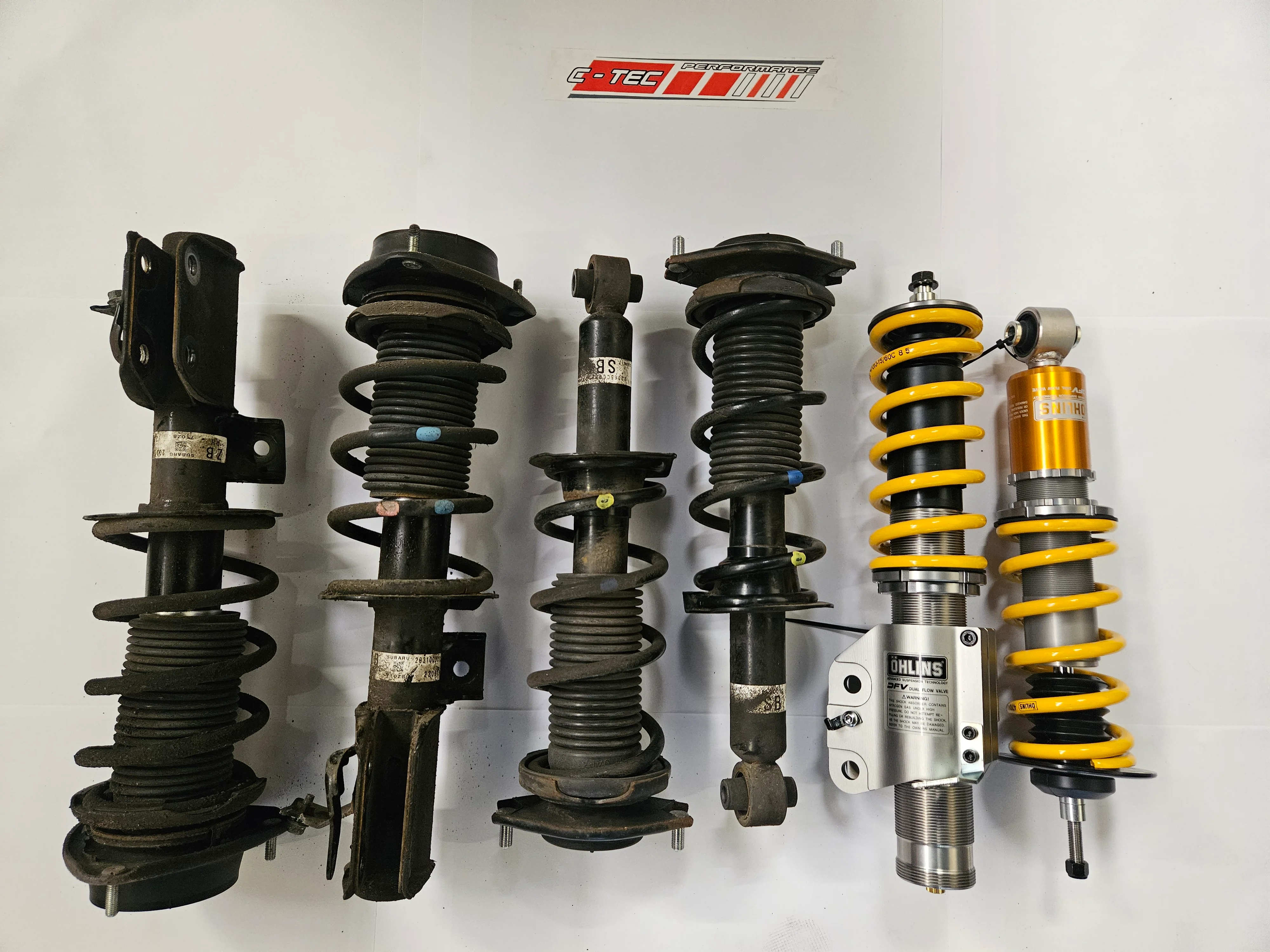

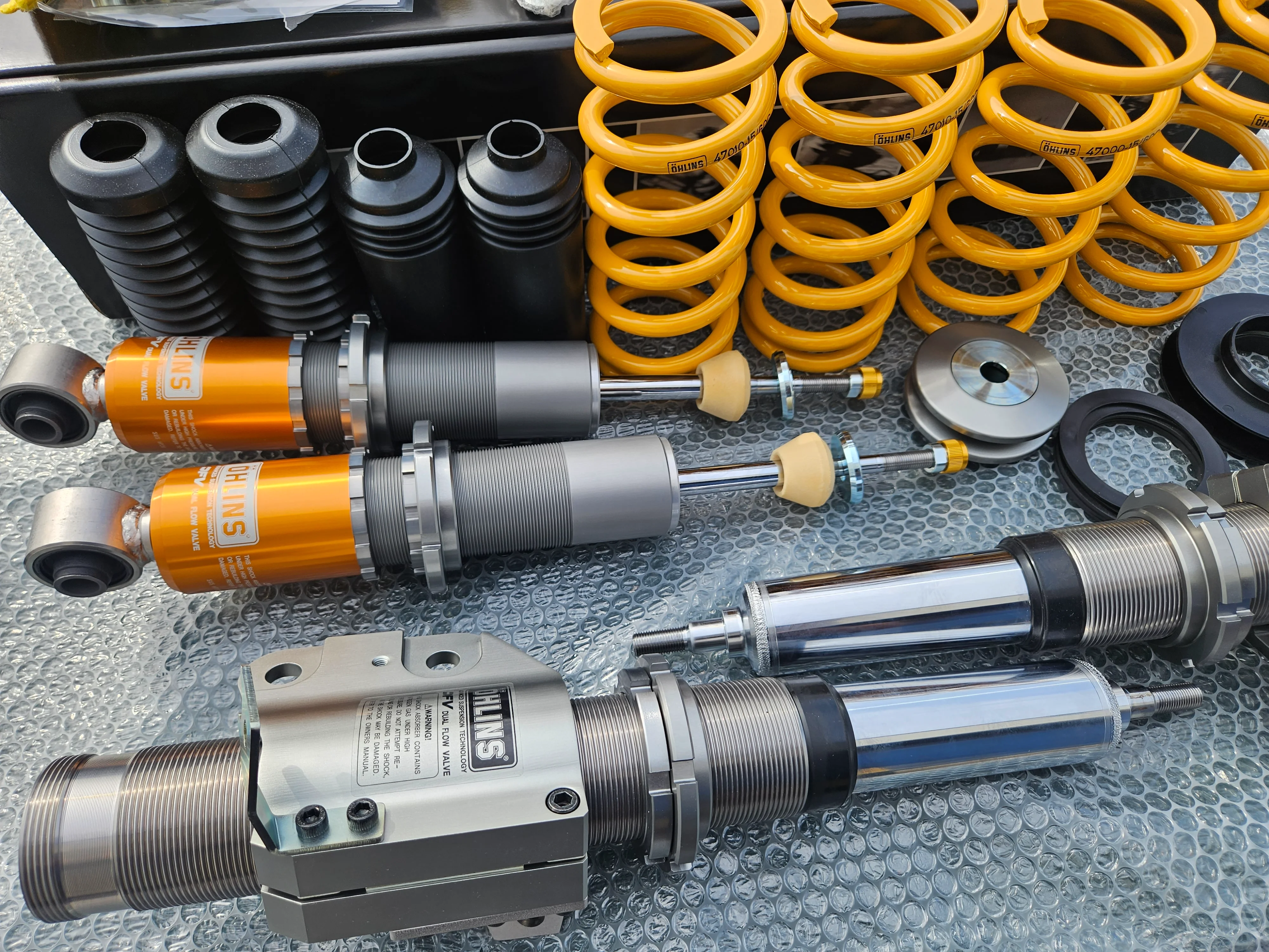

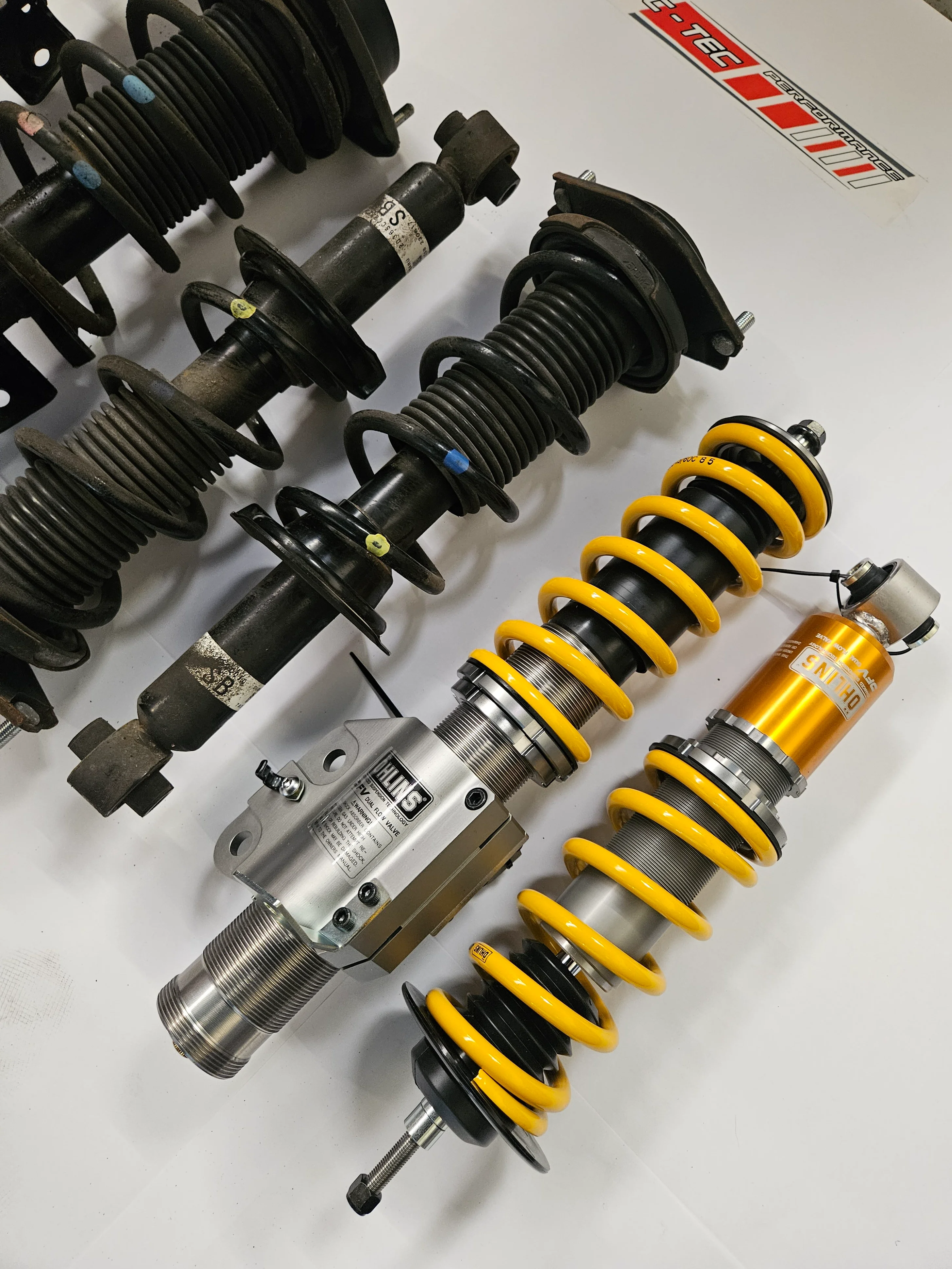

Back to the star of the show, the Ohlins DFV dampers. To be expected, the fabrication quality is exceptional. Granted, at just over £2,100 + Vat, these are hardly budget spend territory, but the closer you inspect, the more impressive they are. Ohlins have clearly acknowledged the class of the GR86, and these DFV's handle/mirror the little OEM details such as drop link mounts and ABS sensor brackets perfectly.
The Ohlins in their striking brand Gold colour is clearly aftermarket, but they look so perfectly at home at each corner of the GR86. You just know that if Toyota didn't have to keep production costs under control, they would surely bolt a set of Ohlins DFV to the 86.
GR86 Ohlins DFV and OEM GR86 dampers.

HKS Dual PVS is similar to DFV, it certainly 100% solved the occasional traction issues on the stock suspension despite the spring rate being considerably higher.

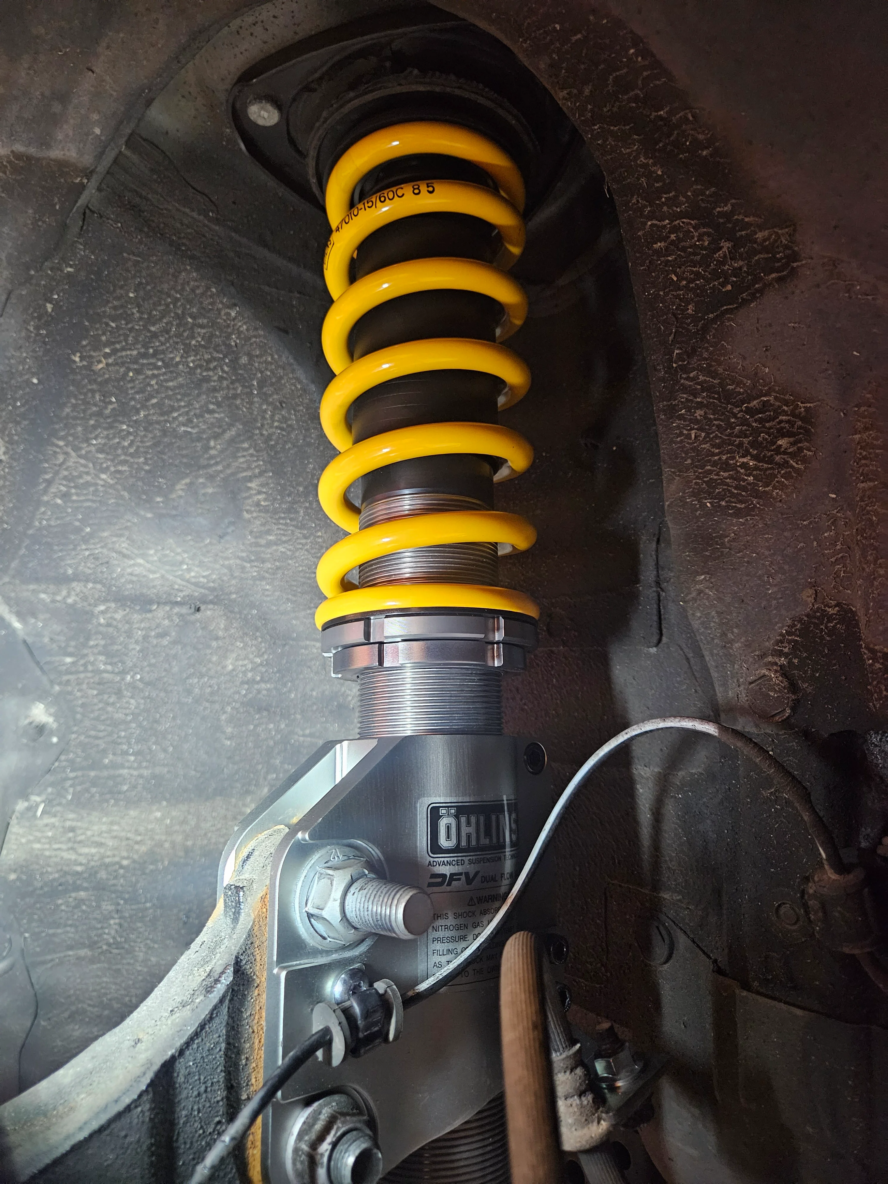

After nearly a year these do not look like this anymore đŸ˜†
