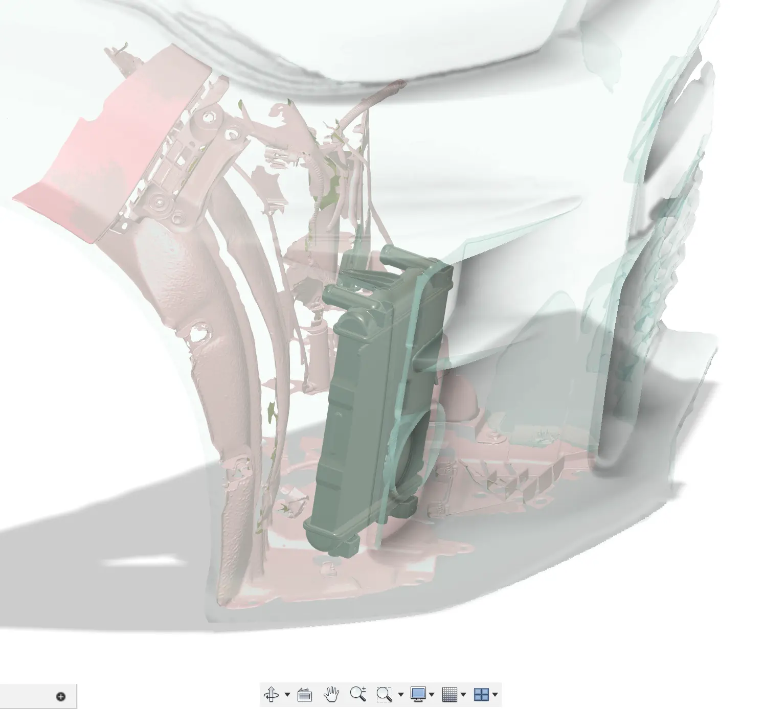

So I 3d scanned the Gen2 Aux radiator and started designing brackets to make the whole package fit. It did take a few versions until I was happy with the position with the radiator, in the end i tried to move the radiator as much to the end as possible to have space to make an efficient inlet duct.
Here are the brackets that I came up with :

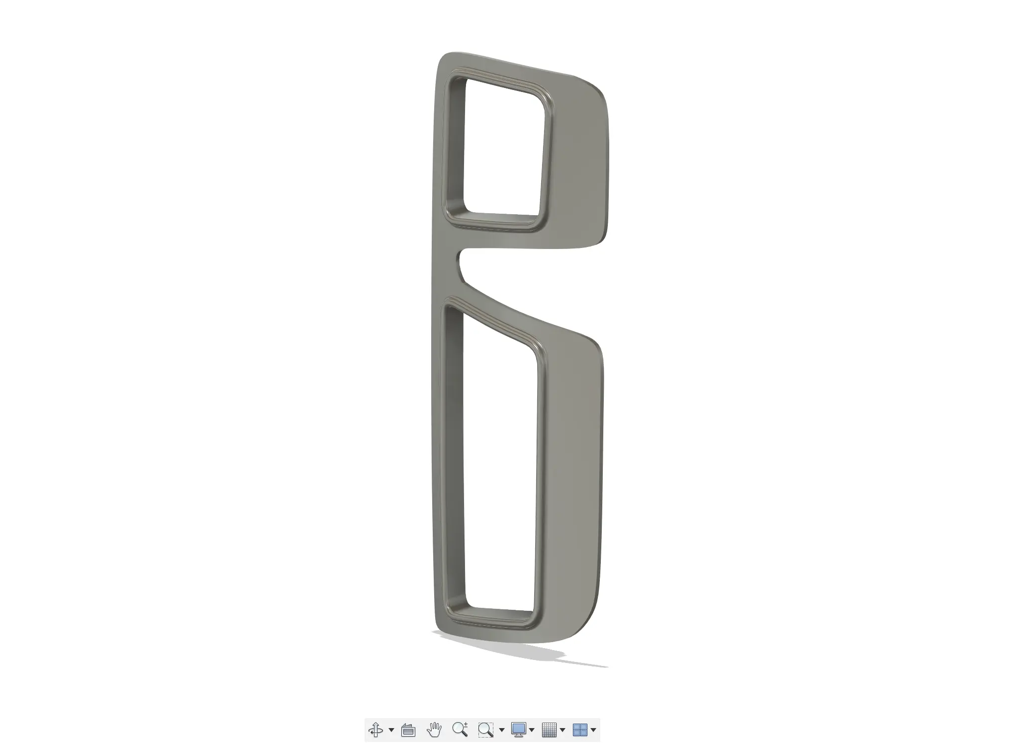

I then started designing the front inlet that attaches to the bumper. I already made a rough mockup, thats featured in an earlier post, but I designed it now new from scratch. The inlet will be molded to the foglight housing. I did modify the housing by grinding the surface flat.
Below is a 3D printed prototype in blue for a better visualization :
The whole concept looks really promising and I'm excited to test it out soon.
Right now i'm further tweaking the inlet and designing a duct that sits between the bumper and the radiator. After that I just need to design the exit and hook up all the lines.
