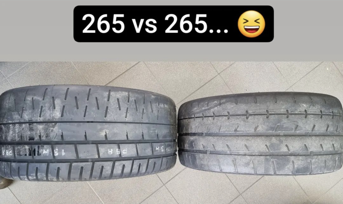

265/35 Pirelli Trofeo R are actually ~285mm wide…
So they rub on the inside and the outside.
They‘re just too wide to make them work.
A friend of mine compared them to the A052 where you can see the huge difference.
9,5x18“ ET45 with 255/35 work perfectly. Maybe some 265/35 will work as well.
