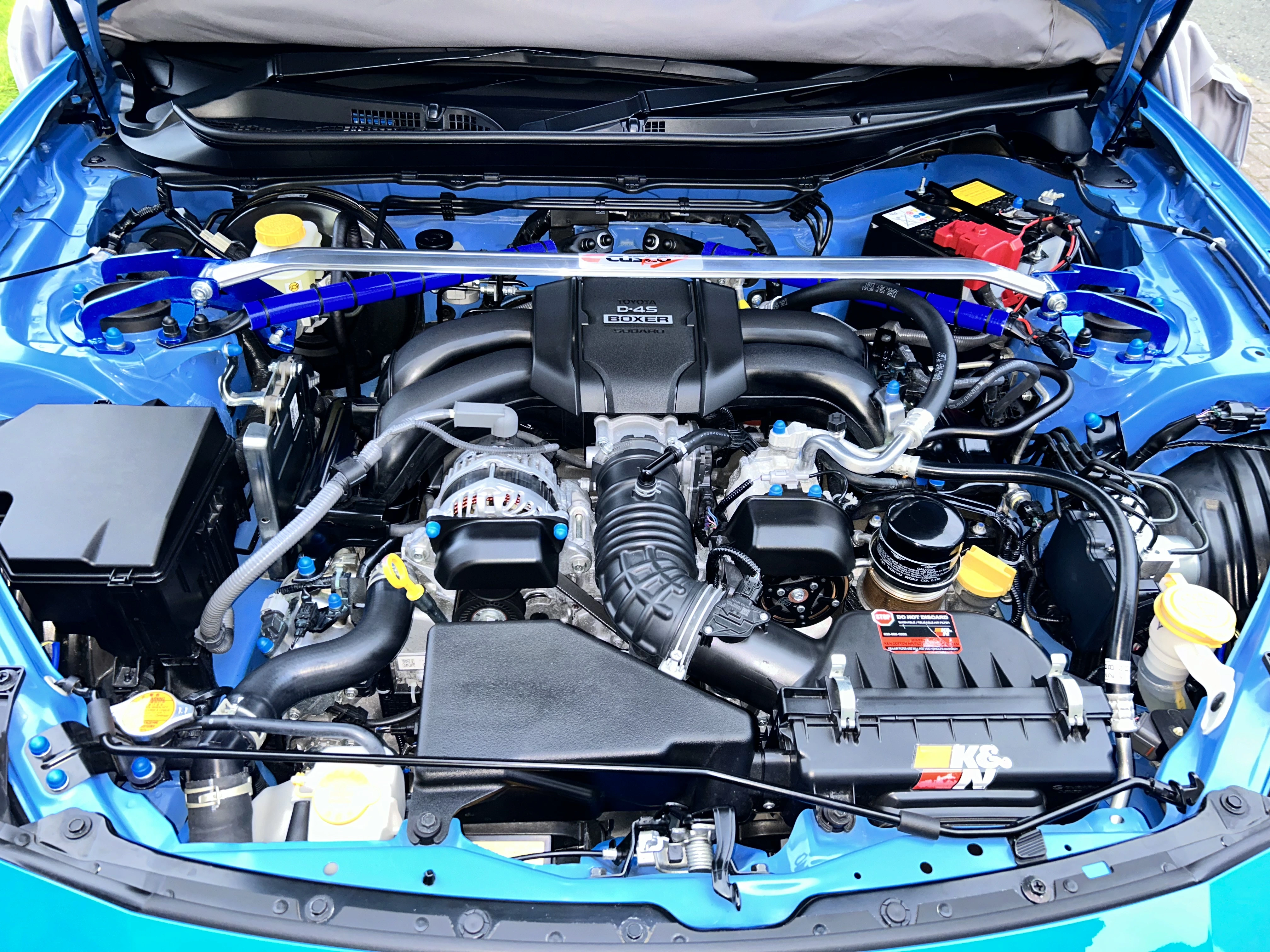

Anyone got a routine for keeping the engine bay clean - what products to use on which parts, how often, etc.? Car is used daily and washed weekly. I’ve never paid the engine bay much attention on previous cars but would like to try and keep this one as clean it is now.
Every month or so, conditions depending, I use a blower and detailing brushes to remove detritus from the crevices. Citrus APC (diluted appropriately) and detailing brush to agitate and foam the APC, loosening surface dirt on all areas, which I’ll then either gently rinse or wipe off with a microfibre. Rubber hoses, pipes and plastics wiped with Carpro Perl for a nice shine. Brightwork, such as hose connectors and ECU housing, cleaned with soft metal polish/wadding like Wadpol or Brasso. The Green/white factory gloop on components and hoses I have already removed using WD40/GT85 and rags. Battery terminals and fixings given a light brush with Silicone Grease. Finally, it's usually a clean and shine with some Ceramic Quick Detailer where necessary, for the likes of bonnet and bay paintwork. Plastic nut covers for decoration.
