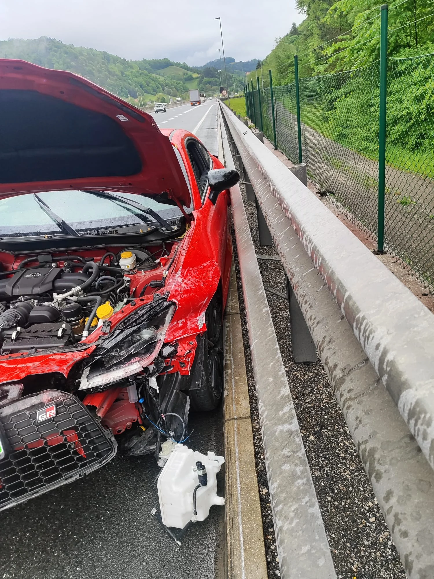

After surviving a lot of hard driving with zero mechanical issues, its near-death came from an unfortunate incident on a wet highway.
The damage looked worse than it was. Chassis structure and all major mechanical components were untouched and the car had mostly cosmetic/body damage, and by pure luck the impact didn’t trigger the airbags (the metal twisted around the sensor). But between the repair cost and Toyota’s Porsche-like parts pricing, the insurance wrote it off as a total economic loss.

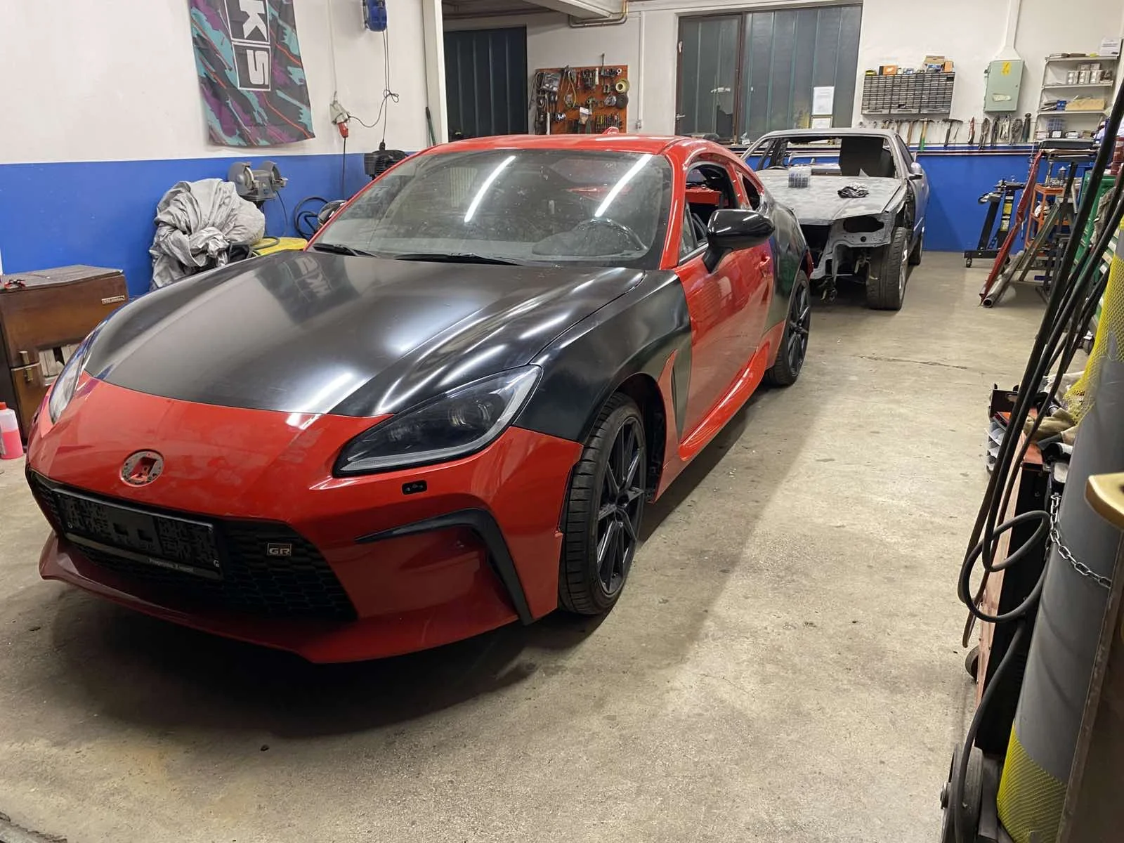

This is where my story with the car begins. I picked the car up in running but damaged condition and spent the next several months sourcing parts before starting repairs. One useful thing to know if you're ever in this position (at least in Slovenia): Subaru parts for the BRZ/GR86 platform are drastically cheaper than Toyota branded equivalents. For example, the front fender is roughly 6x the price from Toyota vs. Subaru (~1500 EUR vs ~250 EUR). As Subaru pricing was quite favourable even compared to the used market, I sourced all parts, shared between the chassis directly from the official dealer and found the rest through parts-out listings across the EU. Once everything was gathered, the car was towed to the body shop for its makeover.
[PHOTO: Zunx_media]

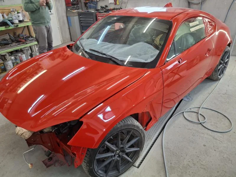

Repair work included full panel replacement and repair, as well as some oem part replacement, which got damaged in the crash (front and rear headlight and taillight, AC and engine radiators, windshield washer fluid reservoir, etc.). Additionally, since a lot of the suspension components needed replacing anyway, I used the opportunity to upgrade the suspension with some Pedders top mounts, 14mm camber bolts, SPC rear lower control arms and SPC rear toe arms. The car also received a new set of Michelin PS5 tires in 215/40/18 for daily and weekend duties.
When the repair process was finished and the whole car was painted, it was time for a quick alignment, so the car drove straight (a more serious, track-focused alignment would follow shortly). And there it was! A rebuilt car in perfect working condition, ready to receive its first (well, besides the “while we’re in there suspension components” 😅) mods. But first, lets see how it behaves in the current, stock-ish form on track!

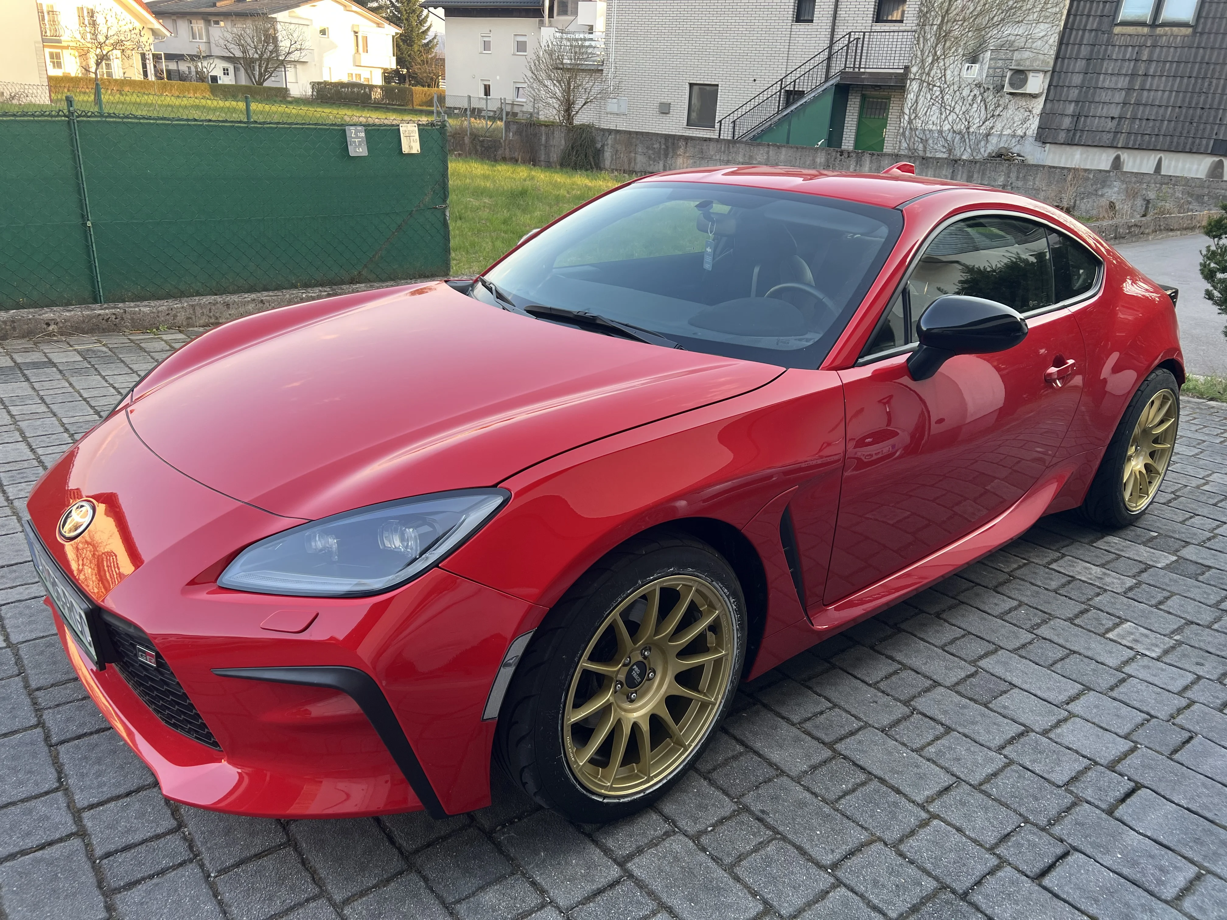

The first to arrive was a set of Protrack One's in 17x9 ET38, finished in matte gold, which I managed to get on sale for 50% off at the time! These will serve as the track setup. I had a set of 225/45/17 Nankang NS-2R tires left over from my previous GT86, so I mounted them on the Protracks - even though 225 is a bit stretched on a 9J rim.
The fitment was tight. Front tire-to-strut clearance was closer than I'd like, and the rear wheels looked like they just barely poke past the fender at stock ride height, but I figured this would not be a problem on track thanks to negative camber gain under compression.

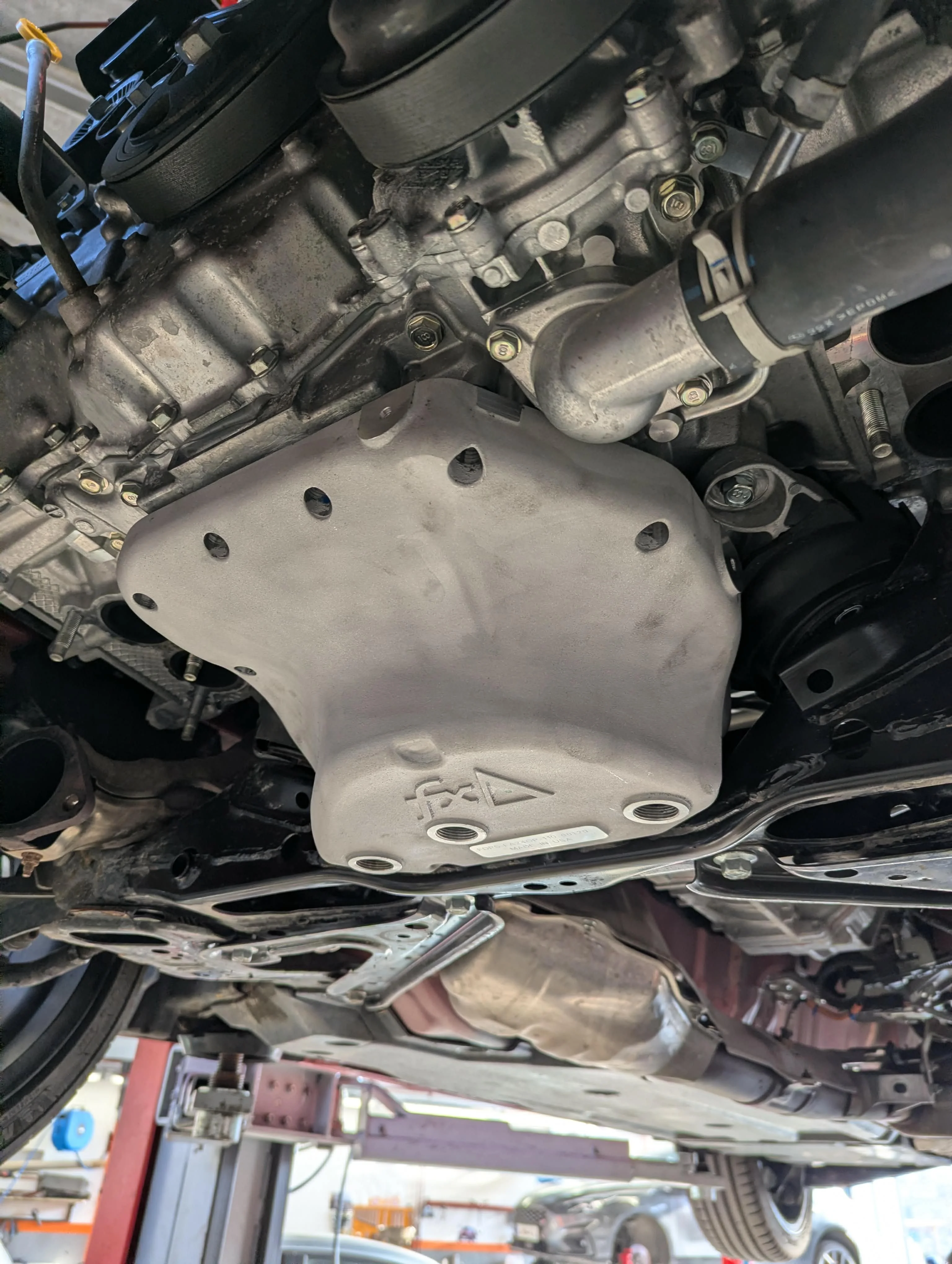

The car had already survived plenty of trackdays on smaller local circuits with no issues, but I wanted extra insurance before taking it to a bigger track with longer, high-G corners. A few companies have recently released high-capacity oil pans to address the FA24's known oil starvation problem. After some research, I went with Formula Delta, as they seemed to have put in the most development time and testing into their solution. I managed to get a pre-order through, and the pan arrived a few weeks before the car's repair was finished.
In the meantime, Gktech also had a sale going on, and my friend was ordering some parts, so I joined in on the order and ordered some clutch springs, shifter springs and a fuel starvation door flap. With all of the parts, I took the car to Enigmamotorsport for the install and a proper alignment.
They dialed in the alignment at -2.3° front / -1.5° rear camber, with slight toe-out front and slight toe-in rear. The Formula Delta pan went on, and the oil was switched to Mobil 1 0W-40 FS, overfilled by 0.7L per Formula Delta's recommendation, for which independent testing also shows that this amount results in basically negligible pressure drops with no real downside.

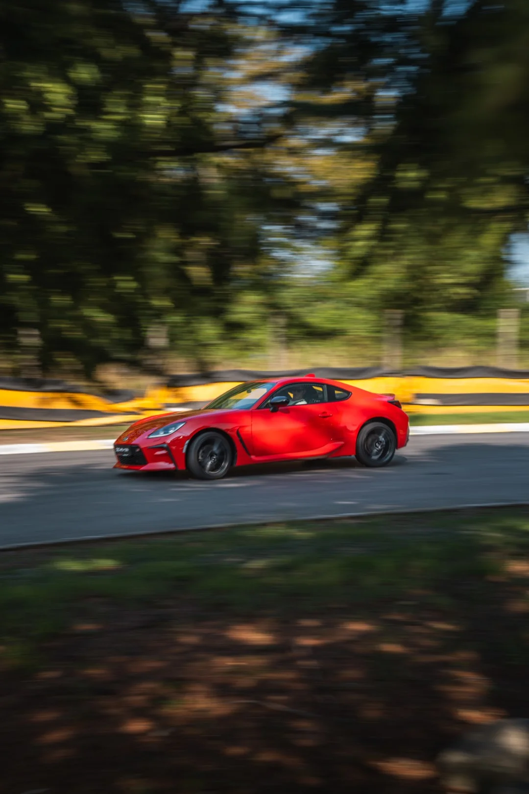

Compared to how it felt pre-crash and pre-mods, turn-in is noticeably quicker now, the car is more stable and predictable mid-slide, but also snappier in transitions, which requires quicker hands to keep up.
Overall, the car passed its first post-hibernation test with no issues, and the mods made a clear, noticeable difference. Next step is a proper trackday to really see how it behaves, but more on that in the next post.

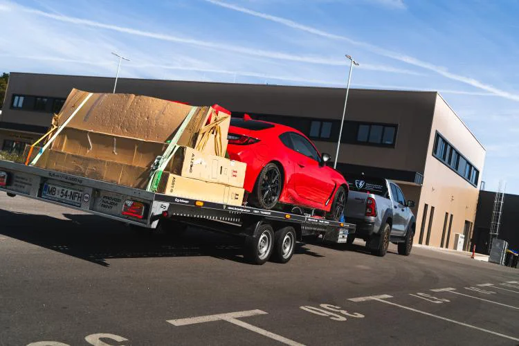

So off came the NS-2R’s and the Protracks were thrown into the back of the car, set to leave for Pannoniaring. Here, I have to point out one of the best features of the GR86 as opposed to other cars in its class - ability to carry all of the track essentials in the back and still comfortably drive there and back. I loaded 4 wheels, 2 20’’ tires for my buddy’s Porsche as he would mount them at the track, tools, clothes, spare parts and other essentials.
