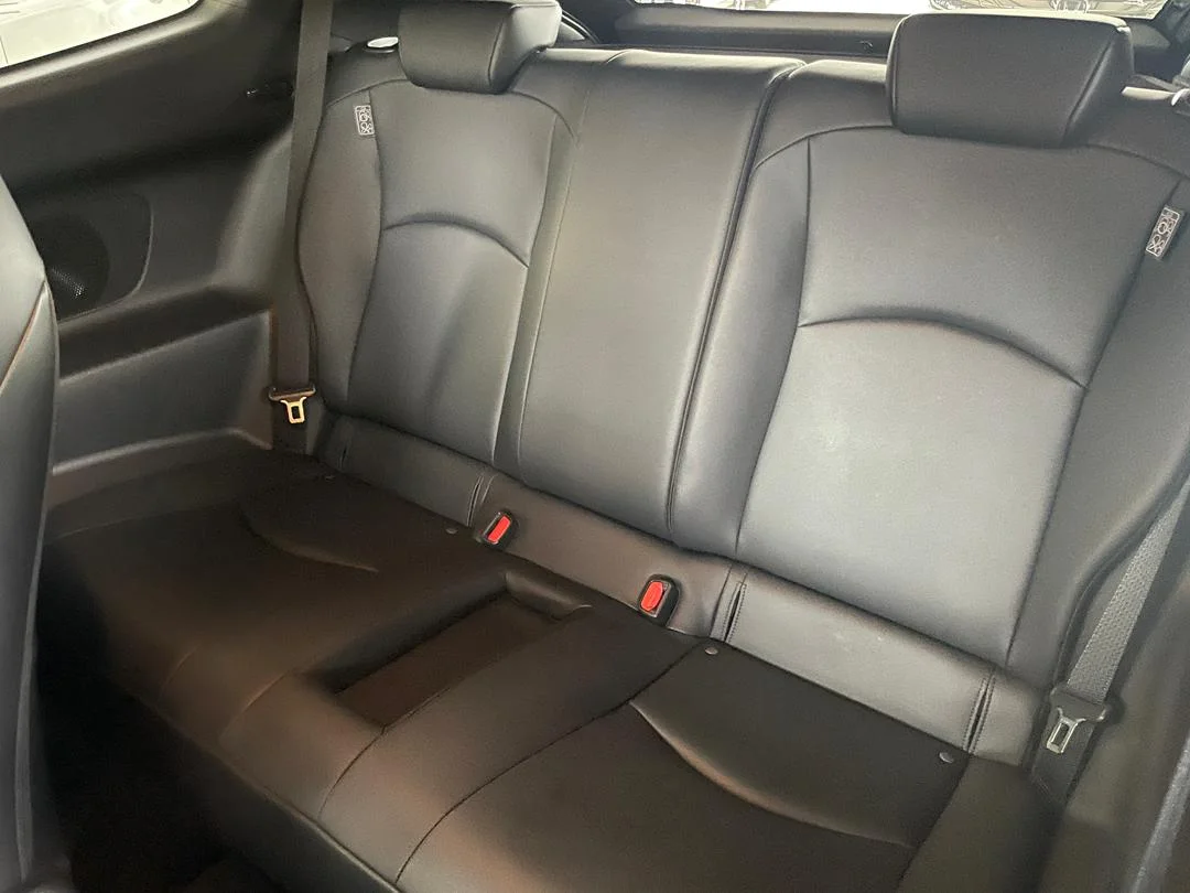

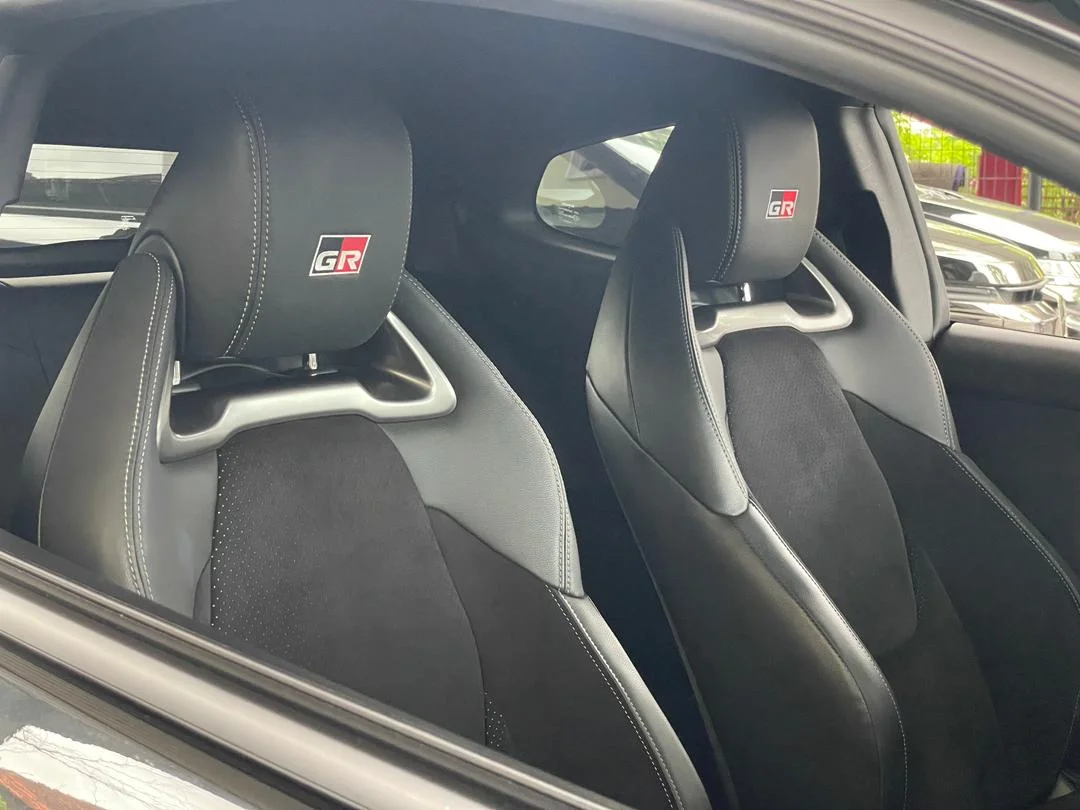

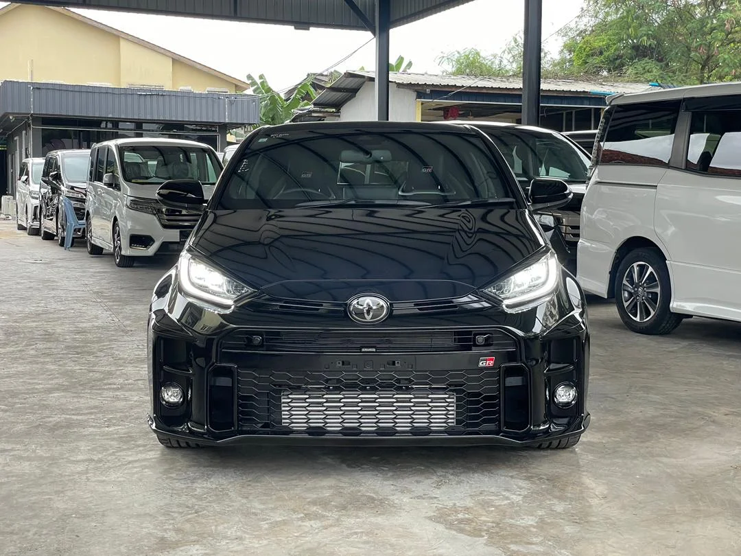

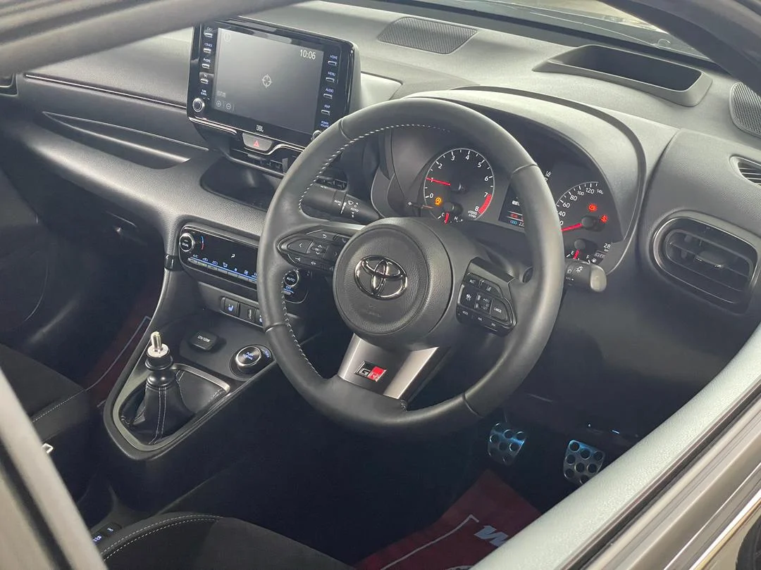

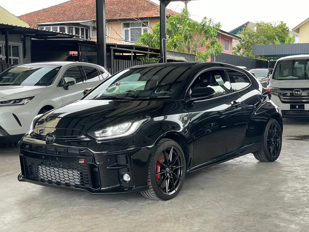

Hi,
looking to purchase a Jap import GR Yaris. All paperwork says its a Morizo but wondering how do you verify and check it is actually one, as documents can always be forged.
From my research so far;
1) Morizo sticker on the windscreen (Can see, but this one doesn't have)
2) upgraded LSD (can't see)
Are there any other ways to validate this?
1) Is the stitching in red or white? - I notice most are red, but this one is white
2) Markings or codes on the car chasis badge?
Thanks for the help.

couple here you can look at to compare
It's really just the windscreen signature option for gen 1 isn't it? Everything else was the same as the RZHP spec, IIRC there wasn't actually a Morizo edition for gen 1.
correct, but some had the wrap not on the roof but ;ole everything in Japan its an option more than we get outside Japan
