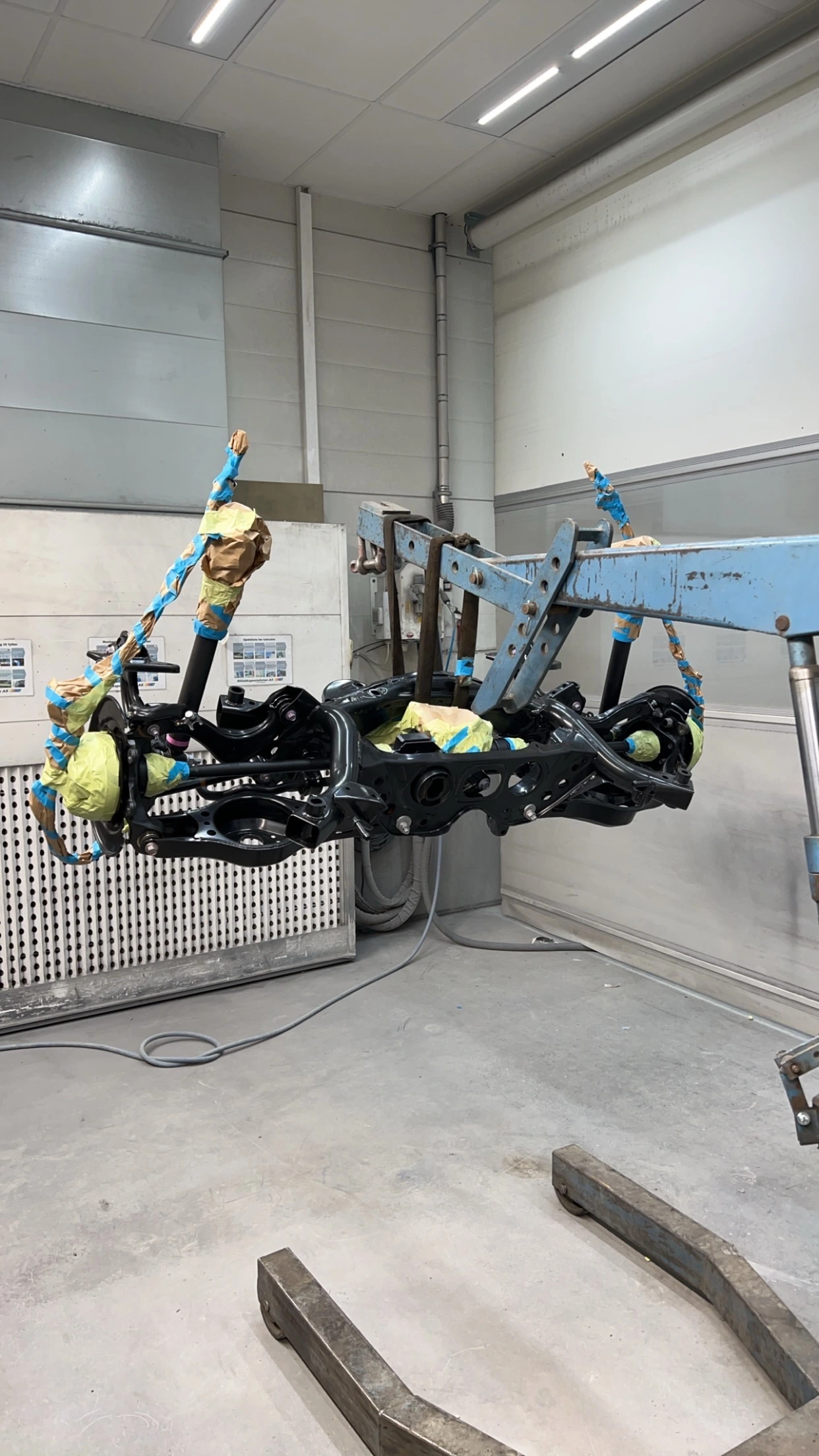

Got my yaris the 5. November and drove it straight to my workplace. Started right away to disassemble the front and rear subframe.
Had a plan from when I ordered the car to do this job.

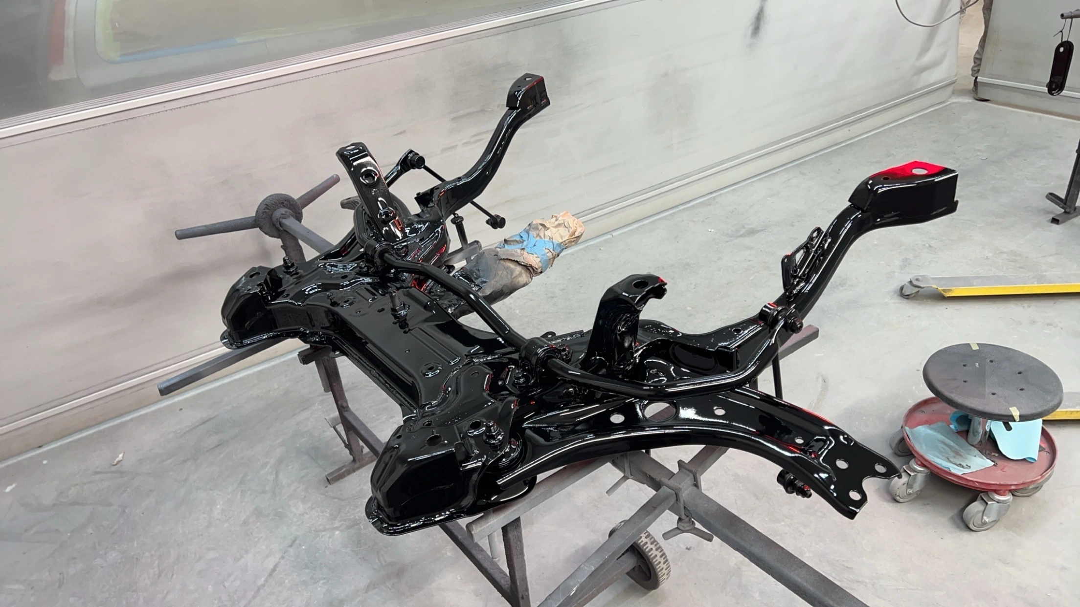

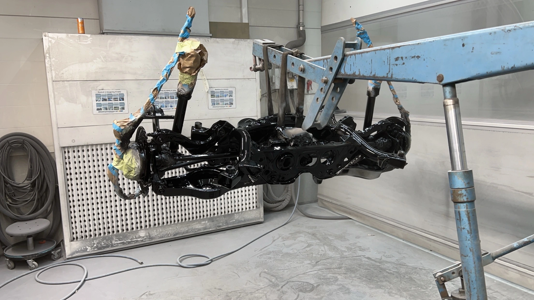

The "paint" on the suspension-parts is what we call transport-primer, and is not a high quality paint.
The subframes got a coat with epoxy primer and one coat with acrylic paint.

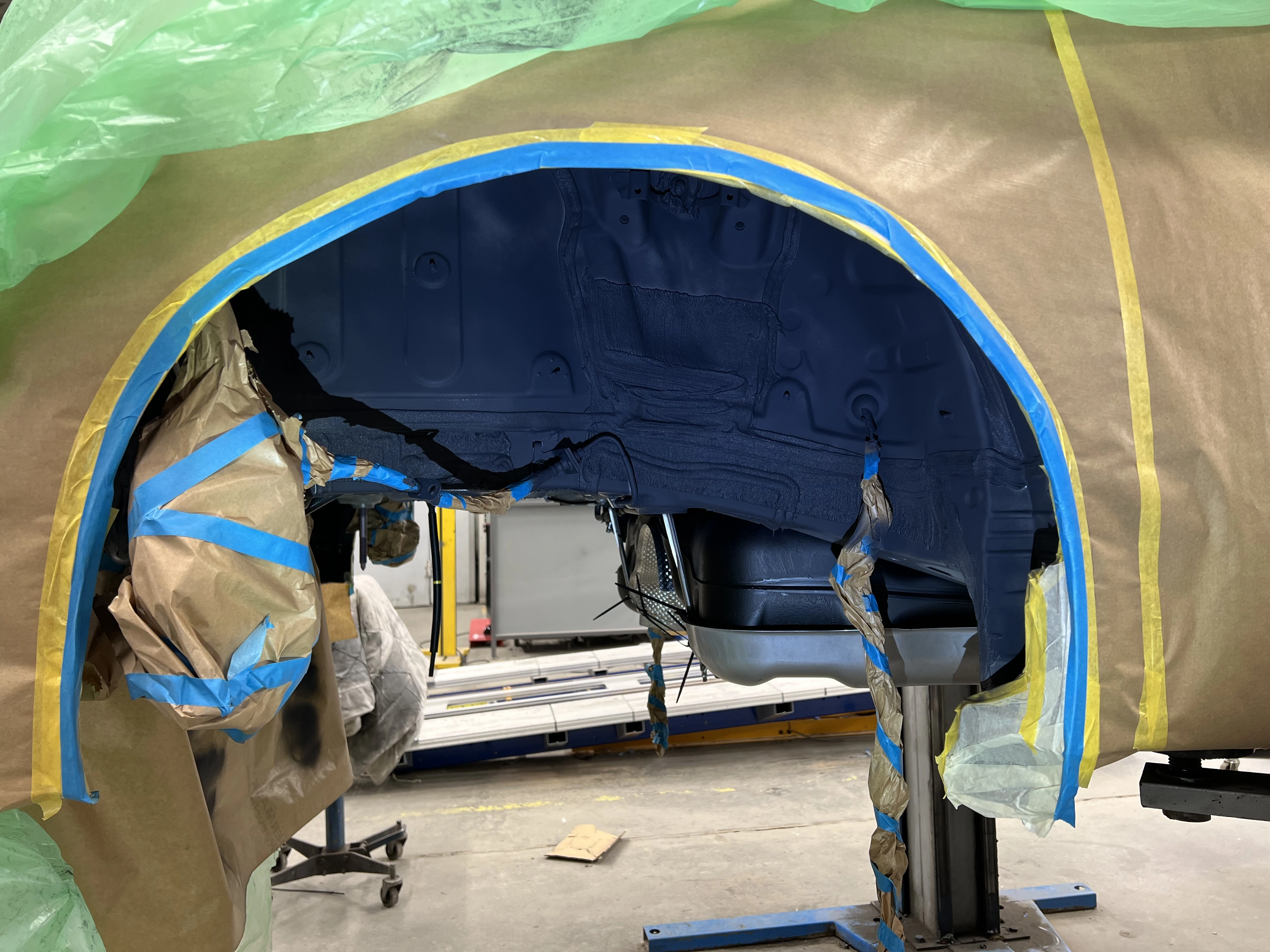

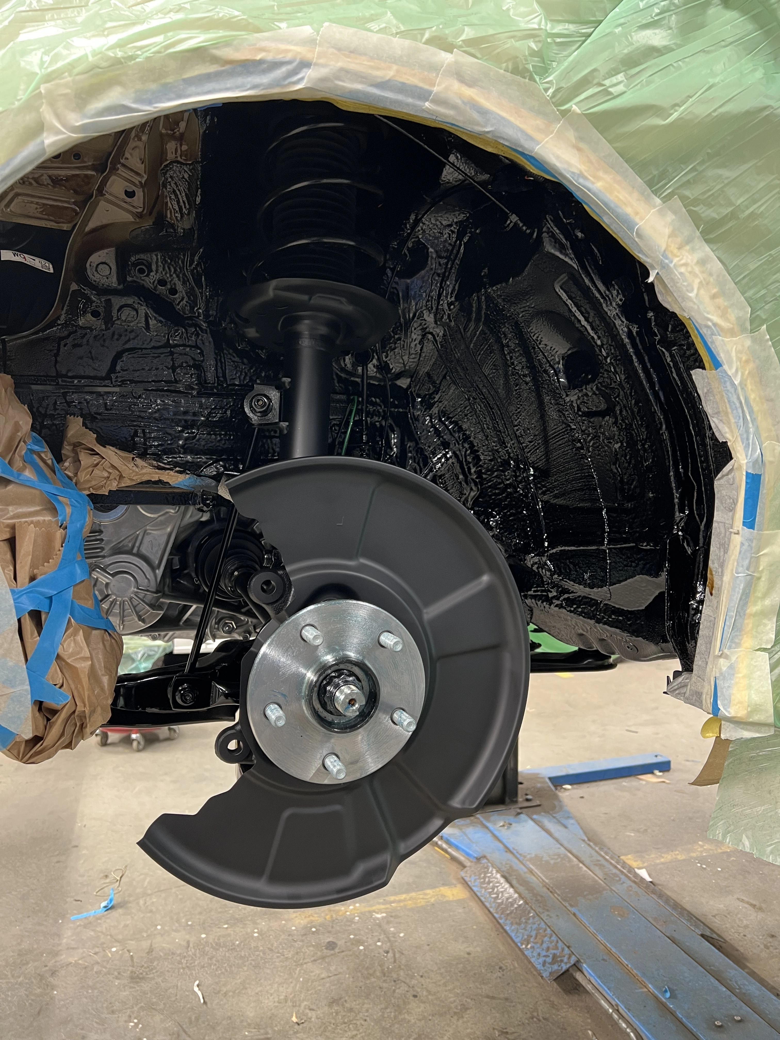

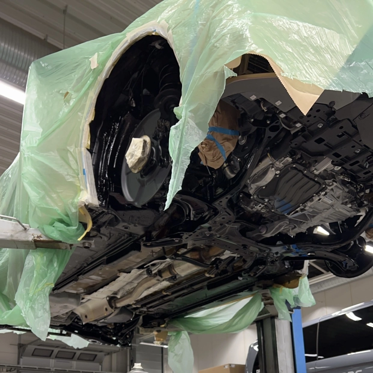

The wheel wells and floor got some primer and some underbody protection.
Used approx one week on the job.
And done!
And done!
