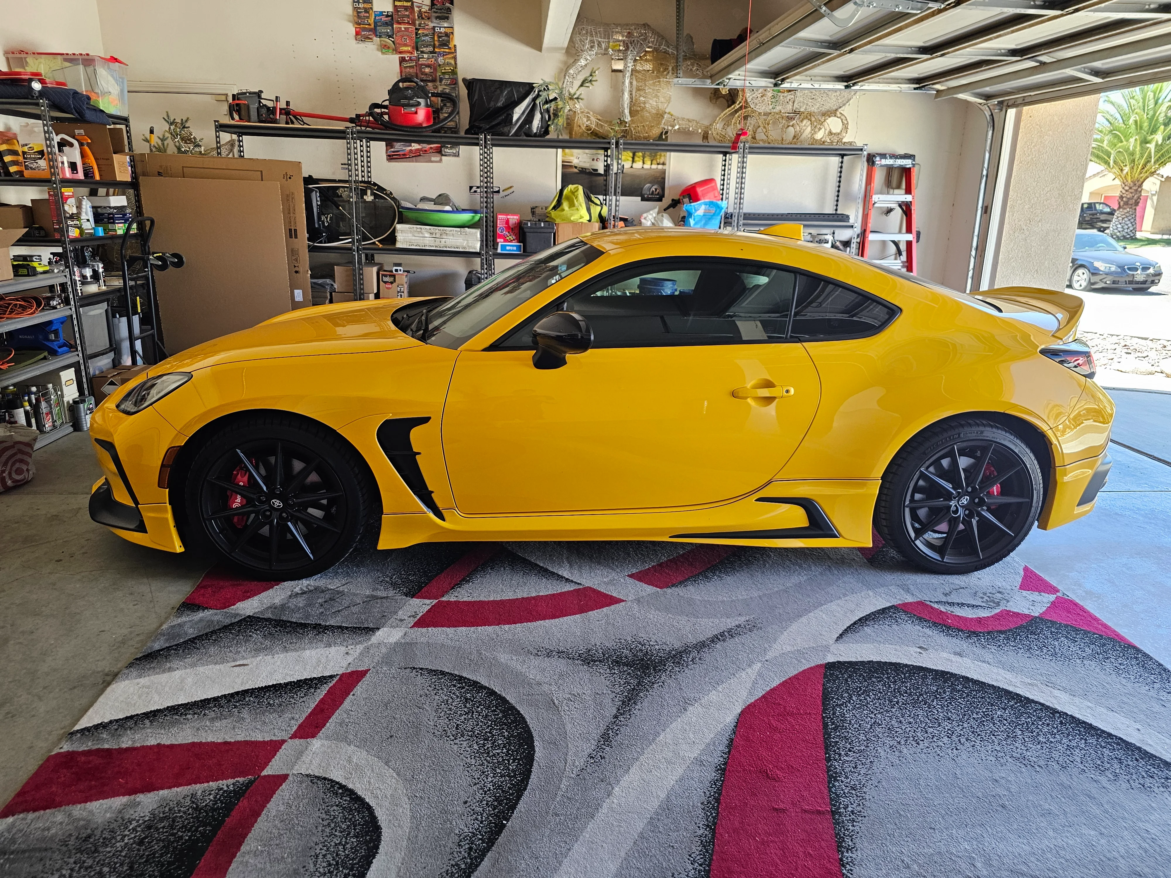

Hello!
I purchased my 2026 GR86 Yuzu Edition (1 of 860) on 5/30. This model came with just about all the Toyota offer options.
  • GR Aero Kit
  • Performance Package (Brembo Brakes and Sachs Dampeners), I think all Yuzus come with this
  • Quad Tip GR Exhaust
  • GR Front and Rear Stabilizer Bars
  • GR Mats
I already added
  • 15% Window Tint to the rear three windows and Ceramic to the front two (Now I want to add ceramic to the front)
  • A Kollektiv Werks license plate mount (waiting for my plates to arrive to finish)
  • Screen Protector
  • Driven Media F-1 3rd Brake Light
  • Driven Media LED Bulb Upgrade (Interior bulbs and reverse bulbs)
  • Fumoto Oil Drain Valve
Parts I have to install
  • GR Front Fender Fins
  • GR Front Bumper Canards
  • GR Door Handle Protectors
  • GR Door Stabilizers
More to come as I build this to my liking
Pics from first day....more to come

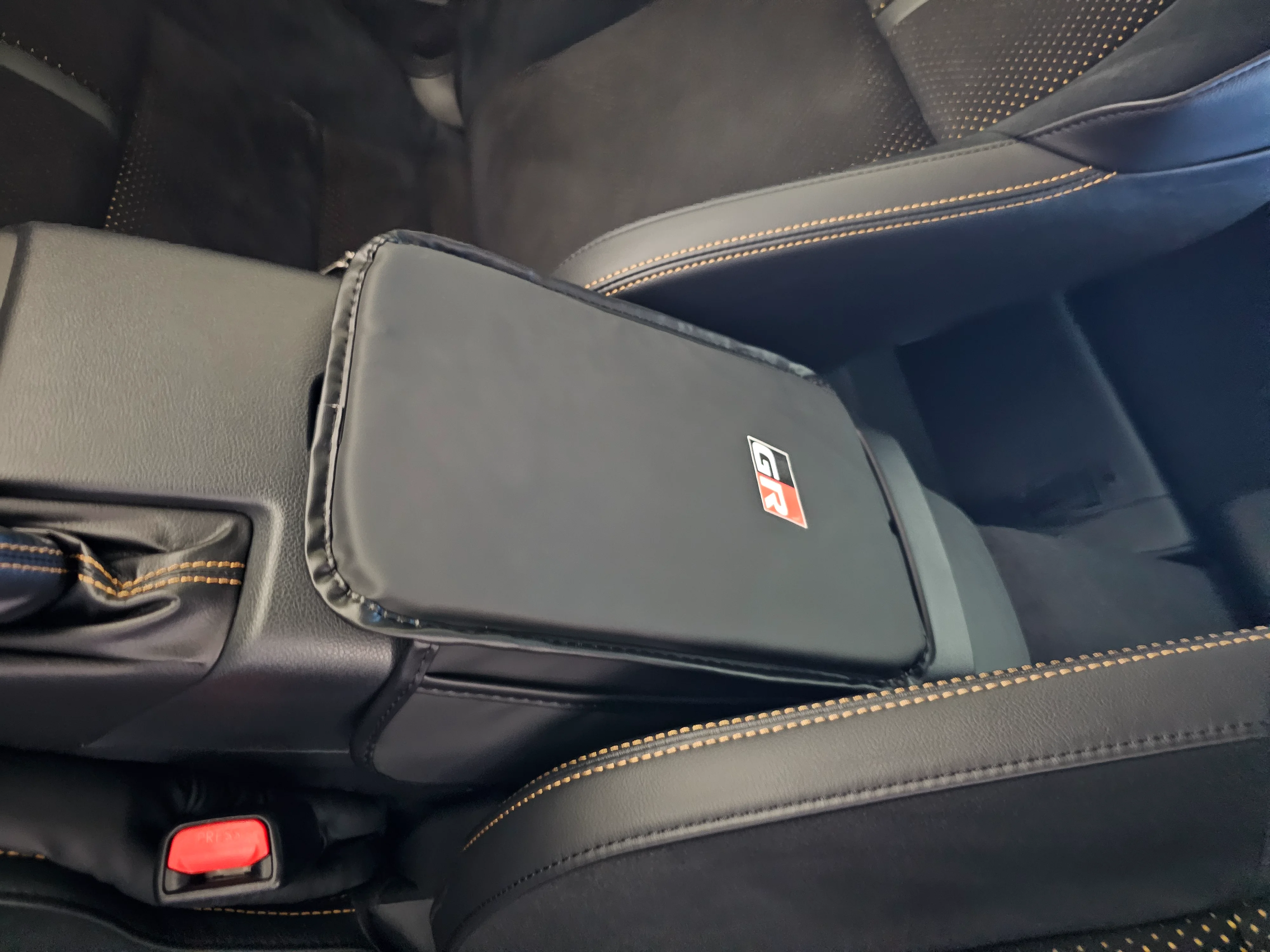

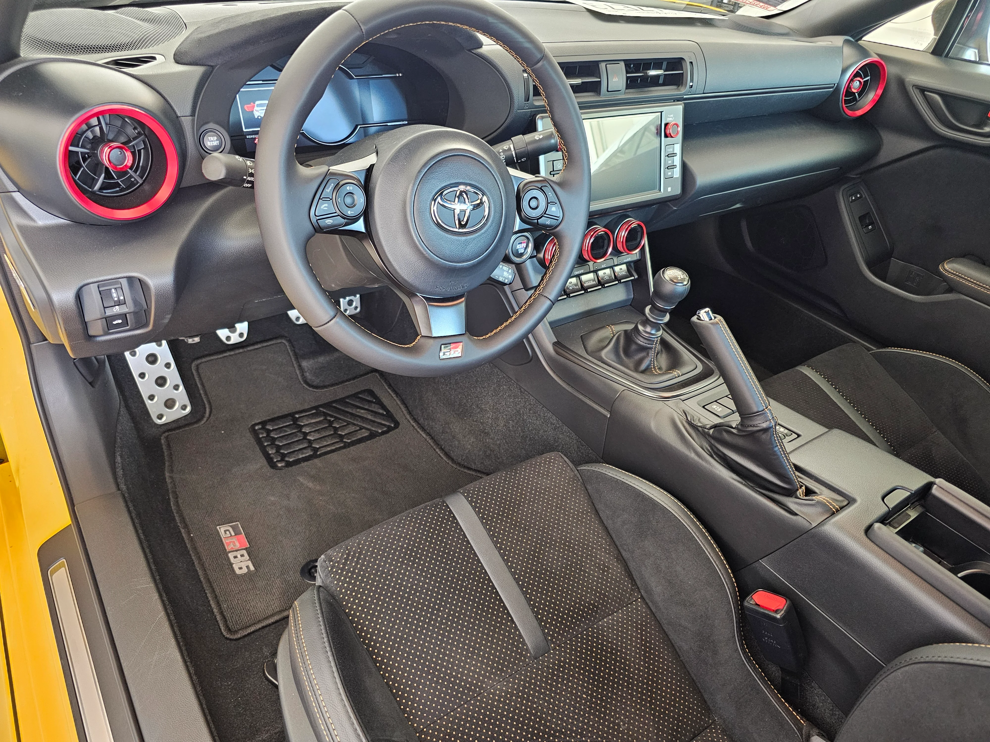

First Mods were basic.
  • Removed the fake exhaust sound module
  • Removed the front strut rubber collars left on the struts by the dealer (should have been removed during the prep at delaership)
  • Added some red to the interior
  • Added a screen protector

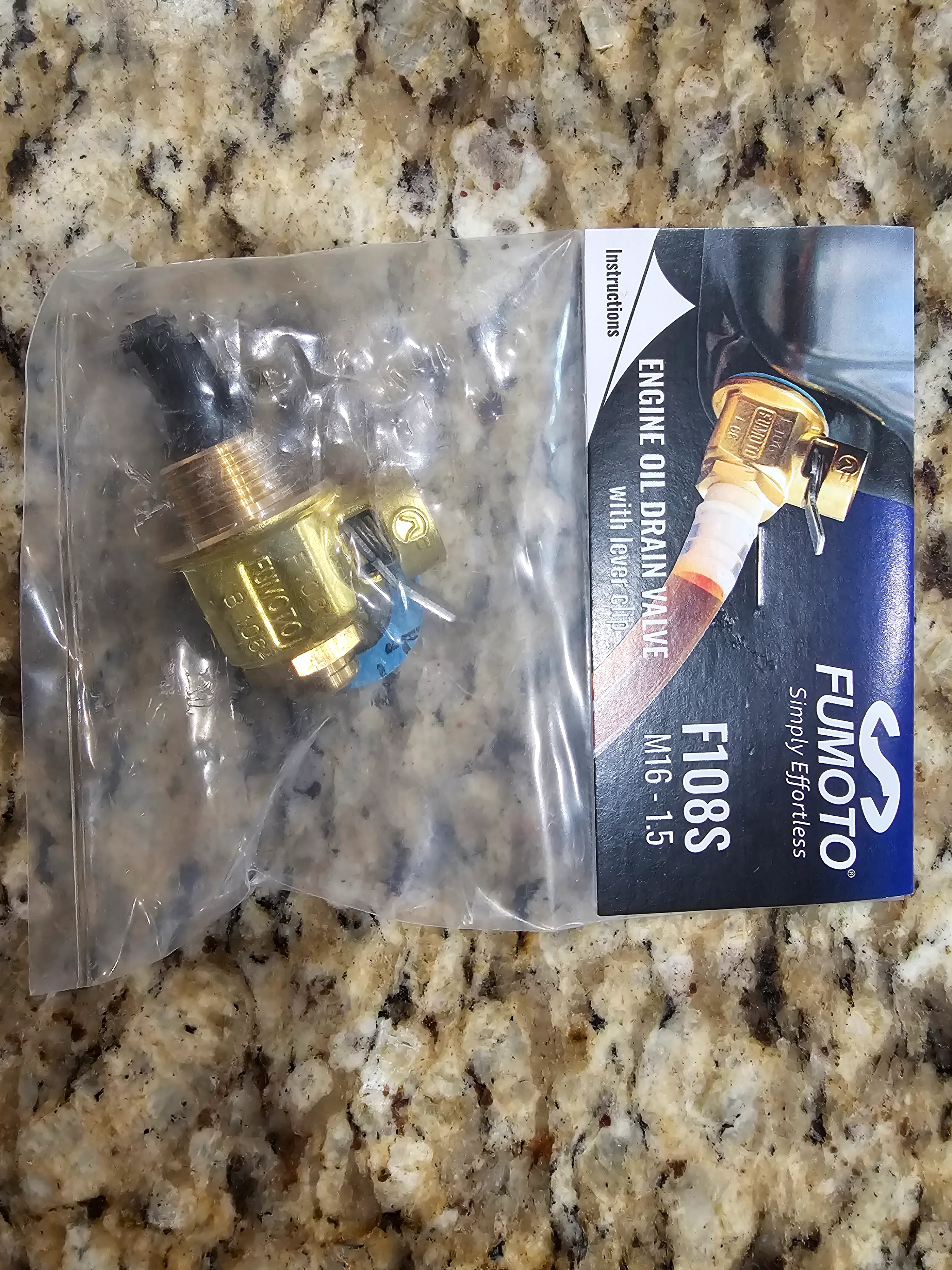

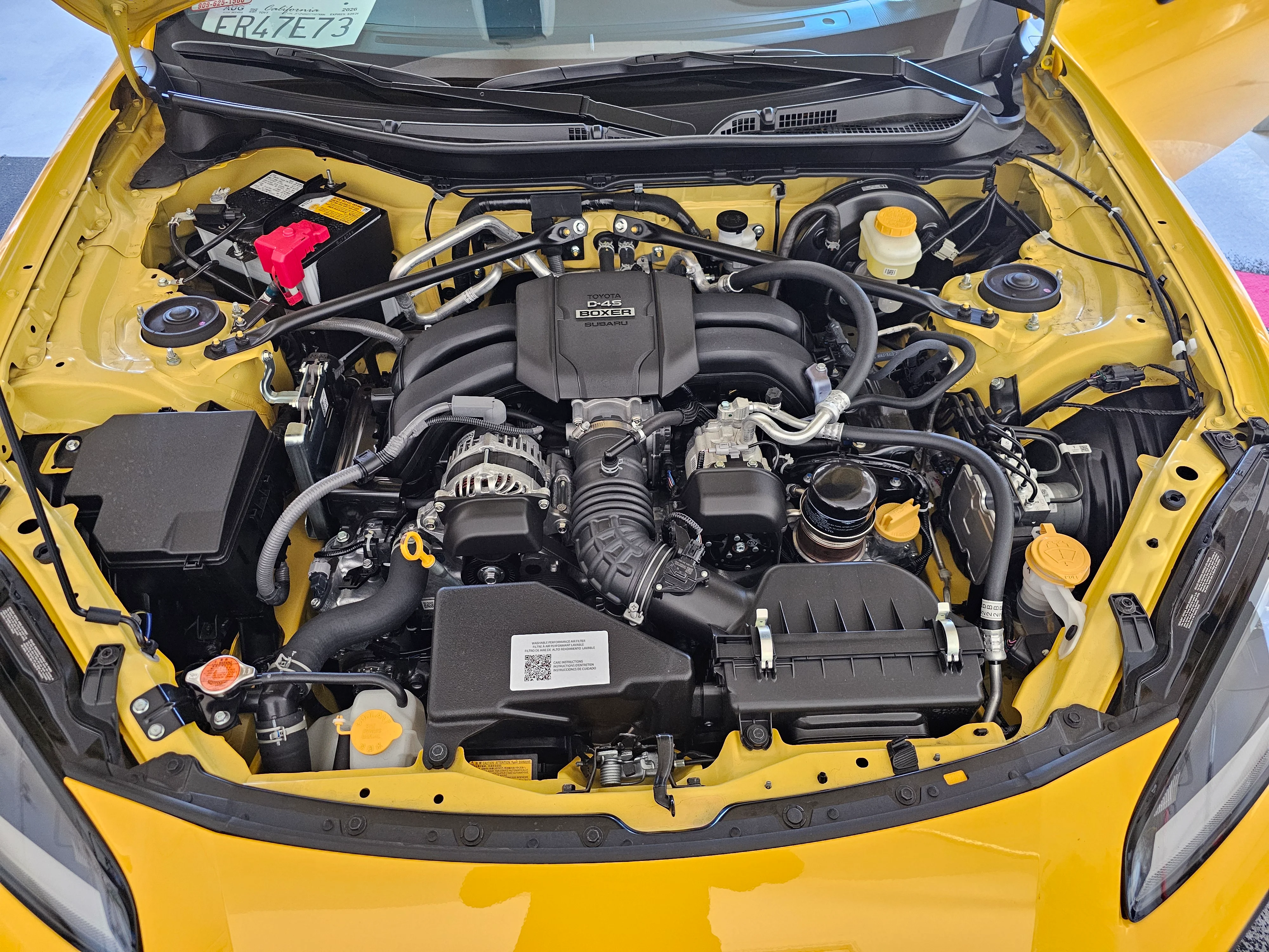

I did an oil change early to help with the metals in the oil from the brake in period and used the opportunity to install the Fumoto engine drain valve to help with future oil changes, making them quicker and easier.

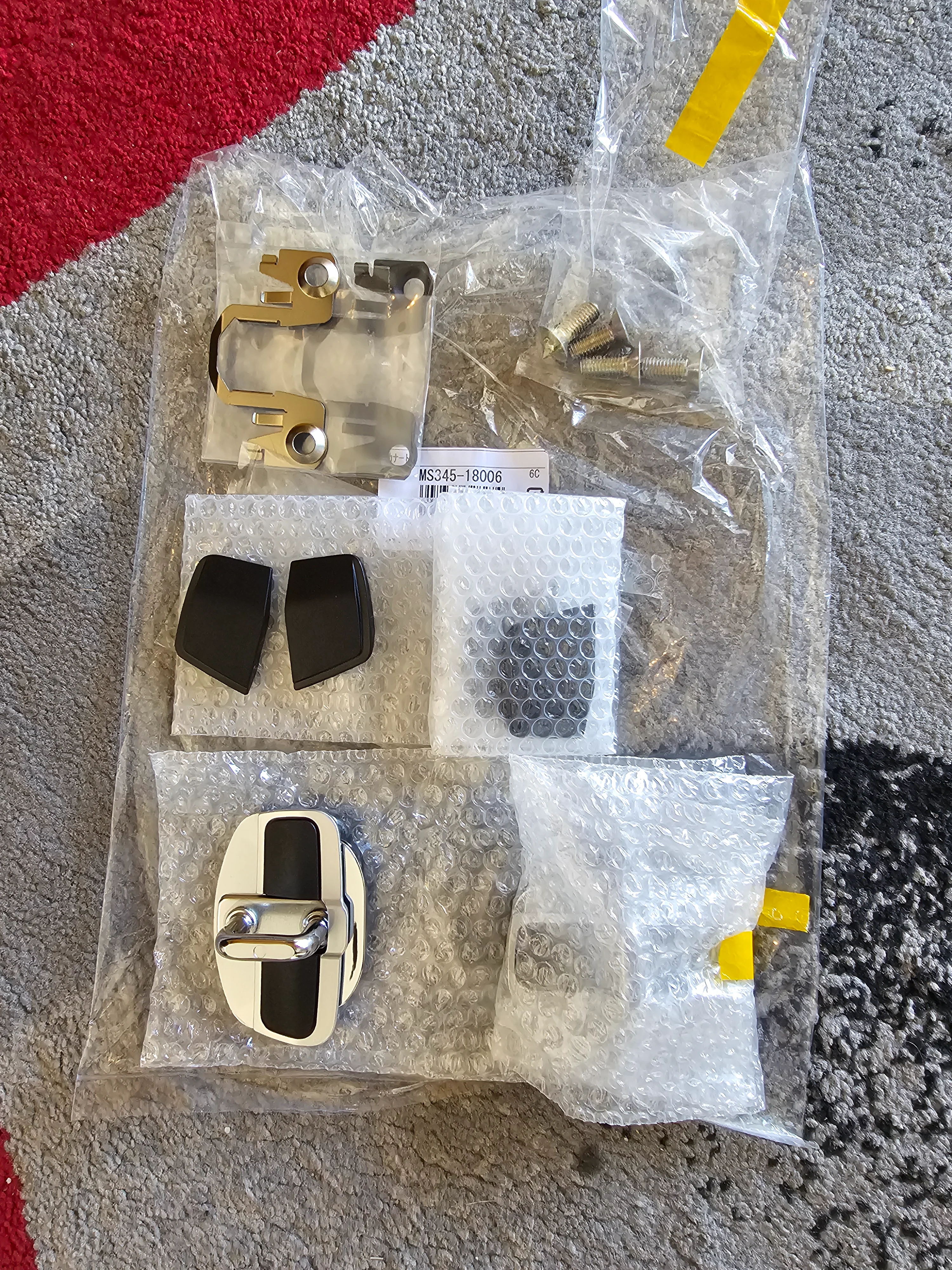

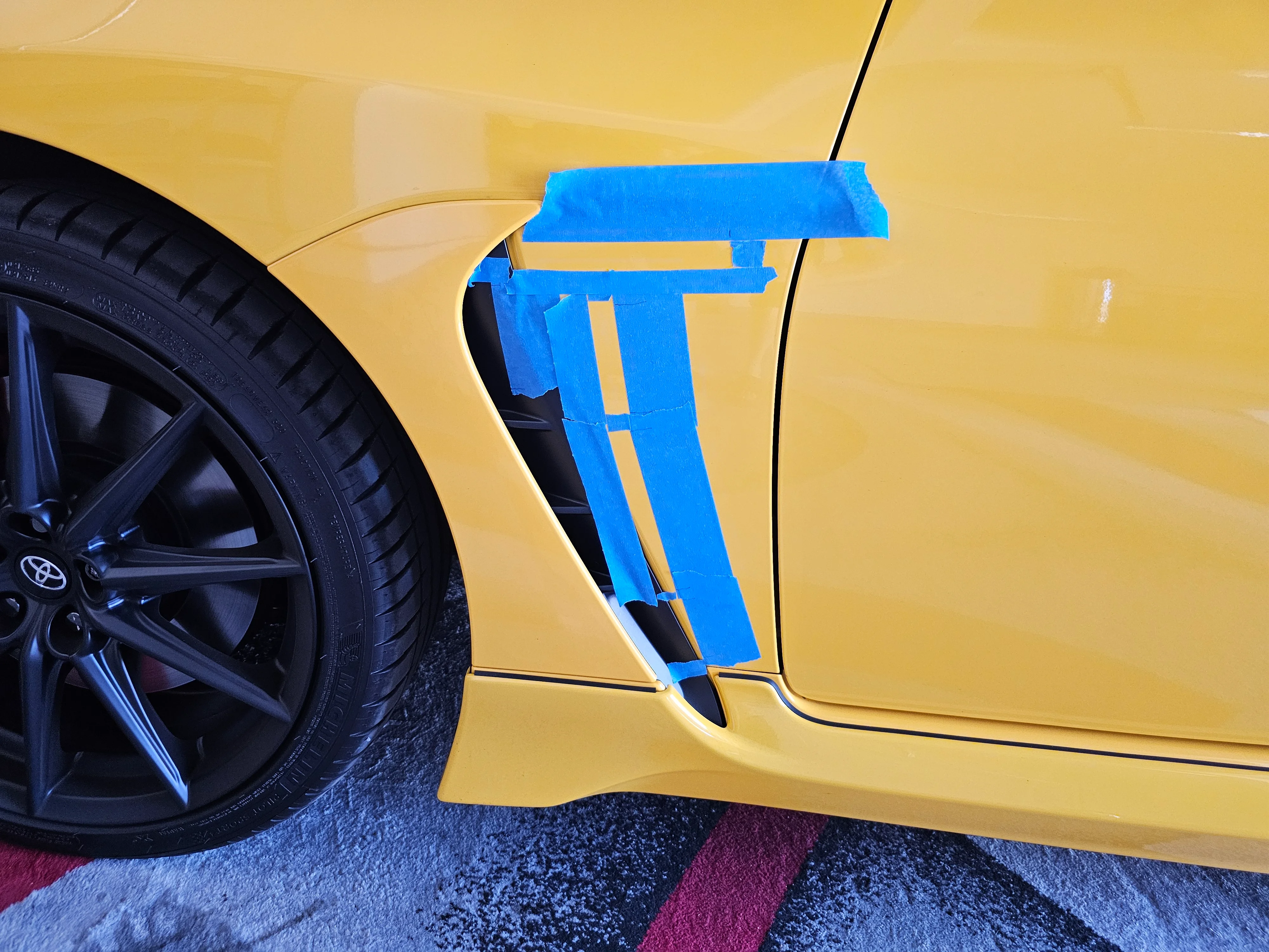

It's good to be back from my vacation so I can start installing some parts i've had for over a month. Starting with the TRD/GR Door Stabilizers.
For anyone trying to do this, here is what you should have.
  • PH3 Bit (Fat Phillips Bit)
  • T-40 socket
  • T-30 Socket
  • Blue Lock tight
Torque Specs
Door Screws: 5N.m, Frame Bolts: 23N.m

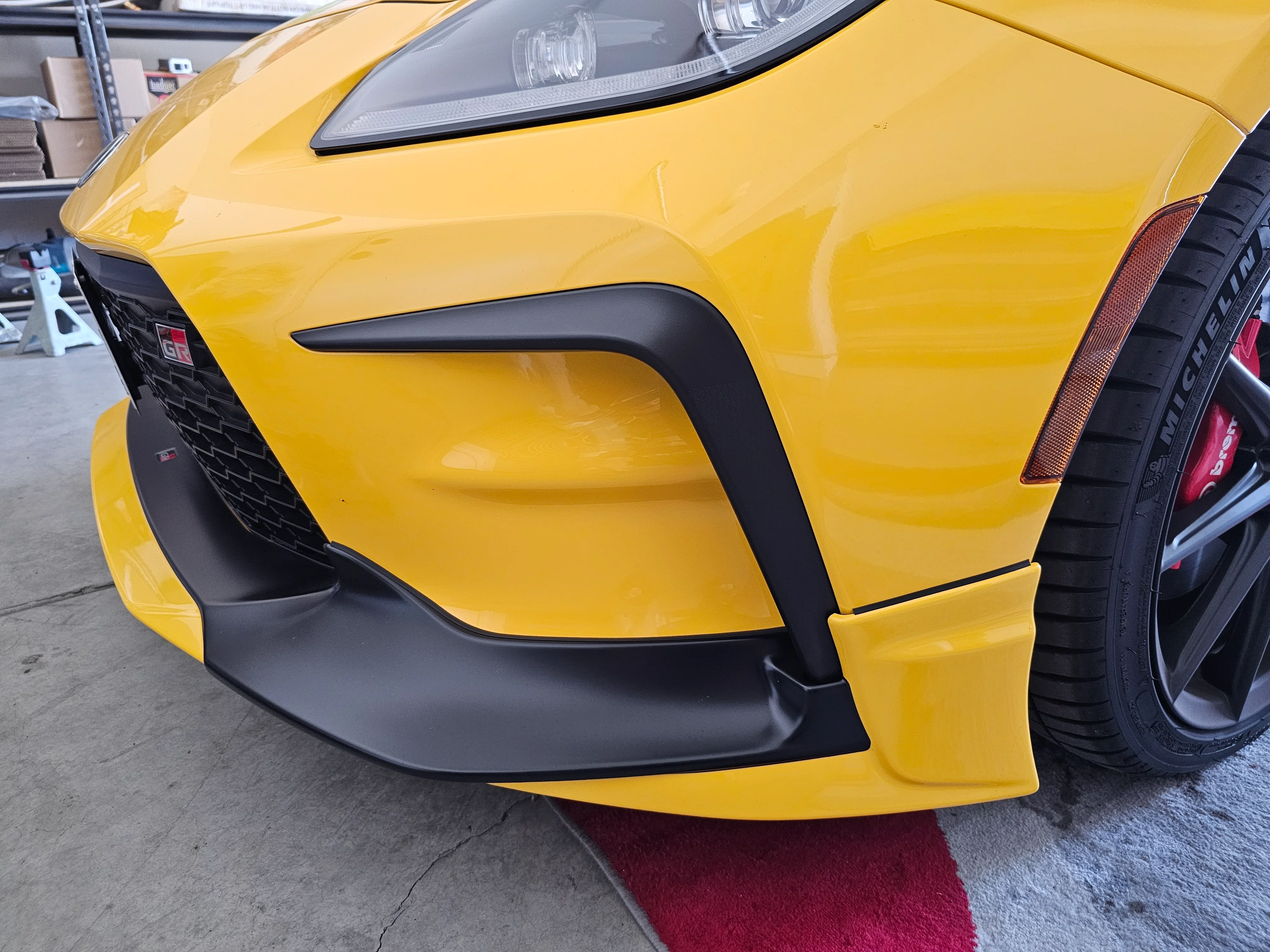

Finished! Might not be to everyone's liking but I think they look great. Adding just a little more black dress it up good and tastefully.

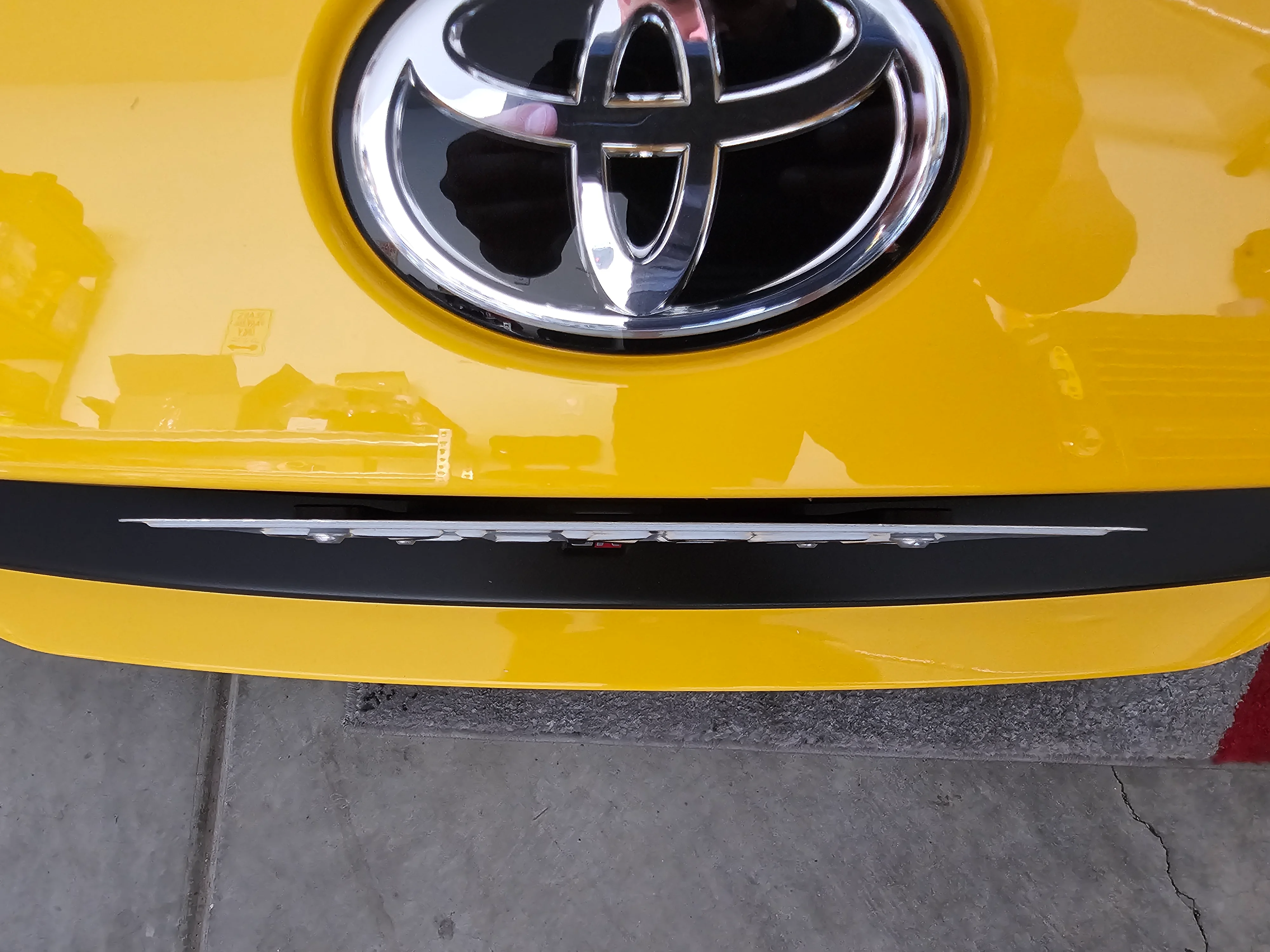

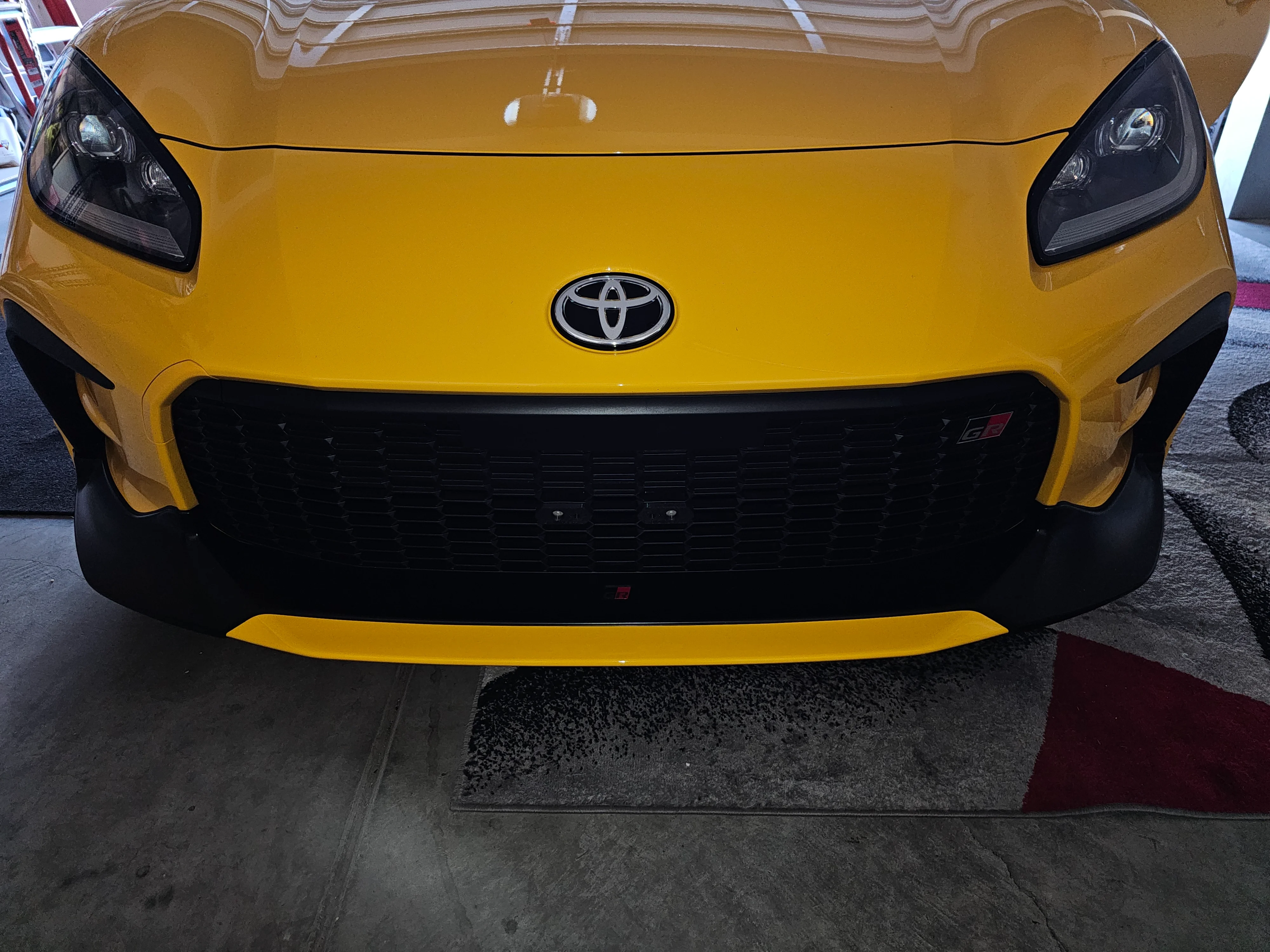

Final install of the day will be my Kollektiv Werk's Front License Plate relocator (Still wanted it centered, just didn't want holes in the bumper)
