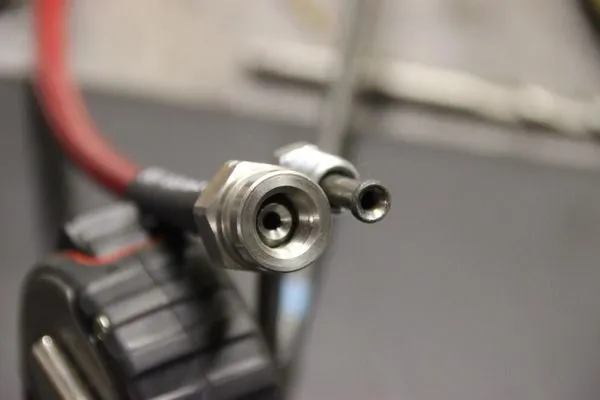

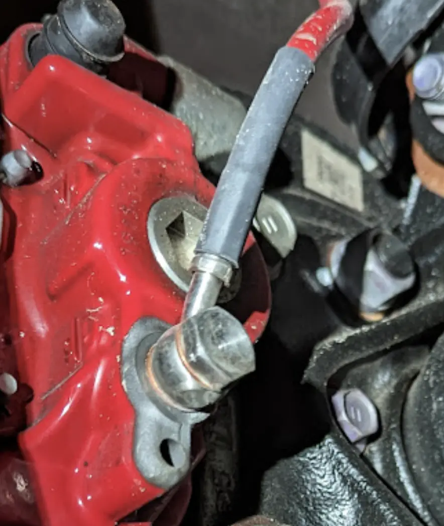

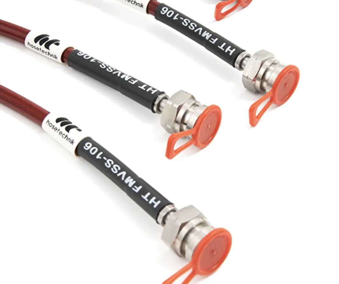

Whatever you do - don't buy the Hosetechnik(Forge motorsport subbrand) brake lines.
I was pleased that my Toyota dealership agreed to change the OEM with aftermarket braided brake lines. However, I was ordering from Forge, and I thought they had the safety pins on the brake caliper side since they have plastic covers on the photos that would accommodate that -I was wrong. Also, the hard-line connection doesn't fit the OEM clip, so you end up with an immensely irritating clunking noise whenever there is significant suspension travel or having to fabricate clips which is a massive no-go.
I had to pay once more to return the brake lines to the OEM ones after finding out and getting a warning from the dealer that they do not consider the change safe.

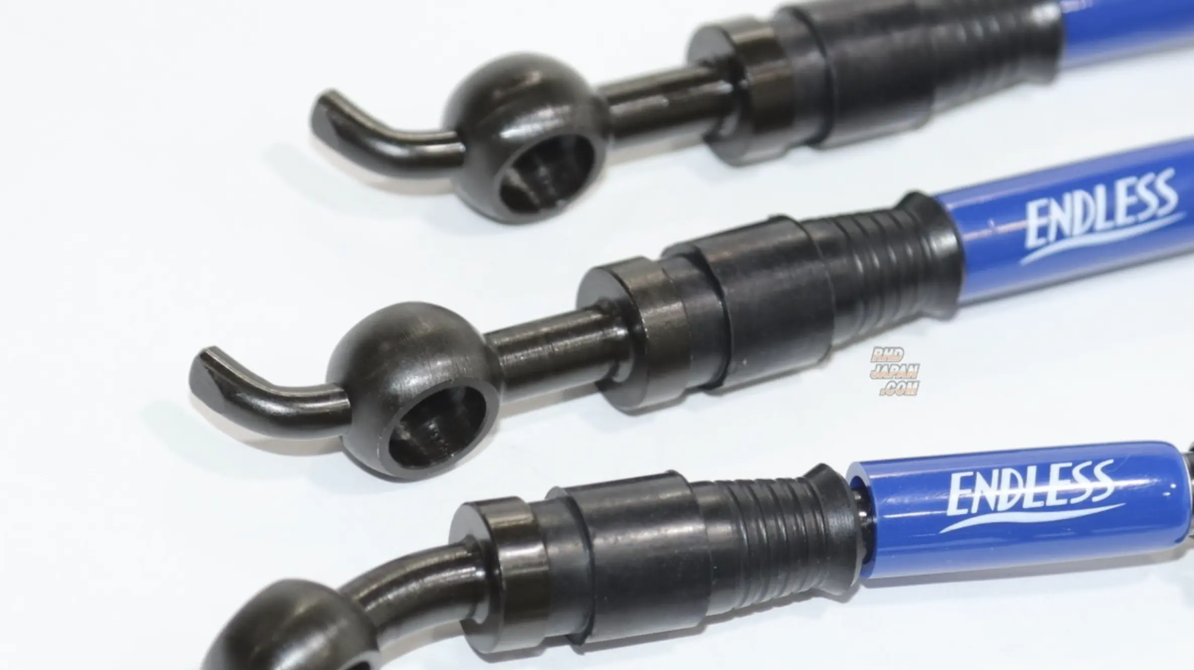

Should I order Endless, or Goodride is just as good?

I have installed the Goodridge without any problem.
Endless are premium for premium price.

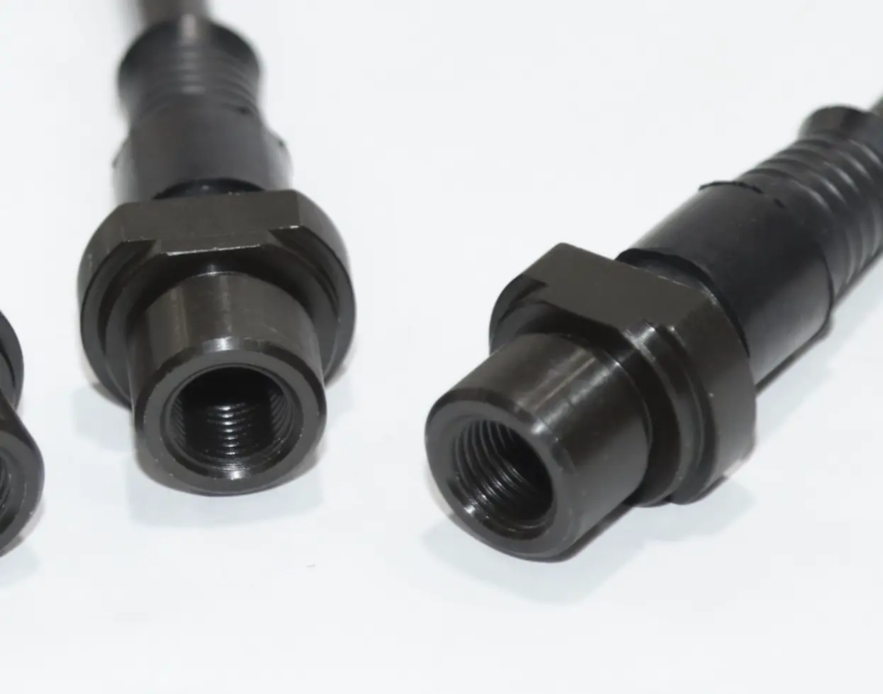

When my friend tried to install Forge motorsport lines he have found out that the ends does not match well, so returned them.
It could have been probably solved with brute force, but not our way. Better watch out for the original pipe if it was not be damaged from that install.
