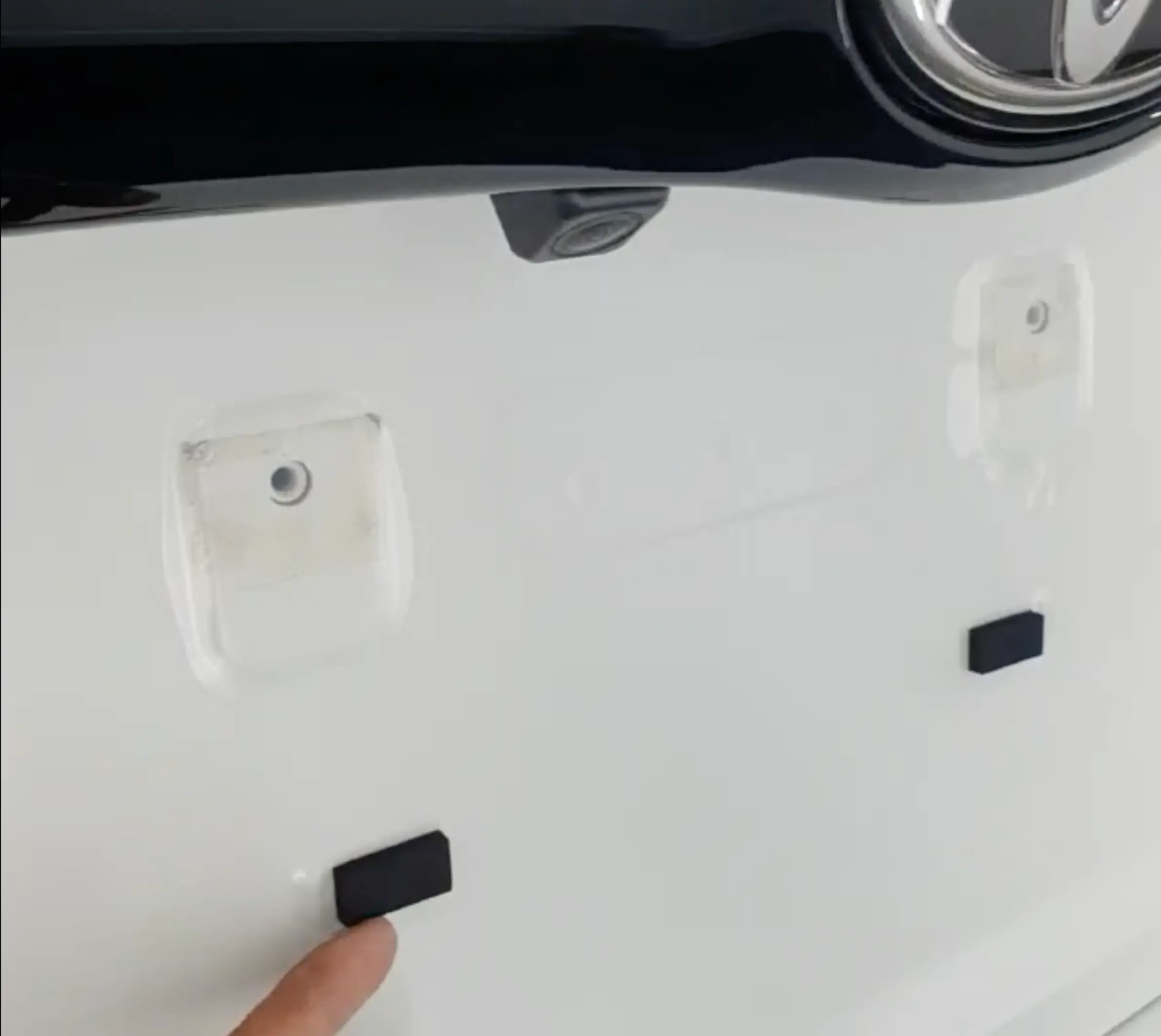

Do you have square plates? can I ask if those black foams should be removed? and just place the 3m tape where the screw holes are? any ideas pls?
Thanks
I’ve a normal plate. I covered the two screw holes with a couple of small pieces of clear PPF to stop moisture getting in to the boot lid. I removed the two small foam pads and cut the tape to avoid the raised metal parts.
Detailer was concern on the vibration if the foam is removed...? I guess not to be concern about
