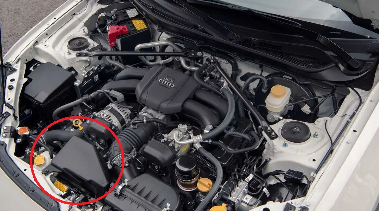

To make it short: do not plug your resonator. You will not gain sound, you will lose power.
Somebody postet a nice link at gr86.com:
itstillruns.com
People plug the opening between the airbox and the marked resonator, because they think its for silencing the engine. But its there for power reasons.
I tested it about 3 times on my old car.
