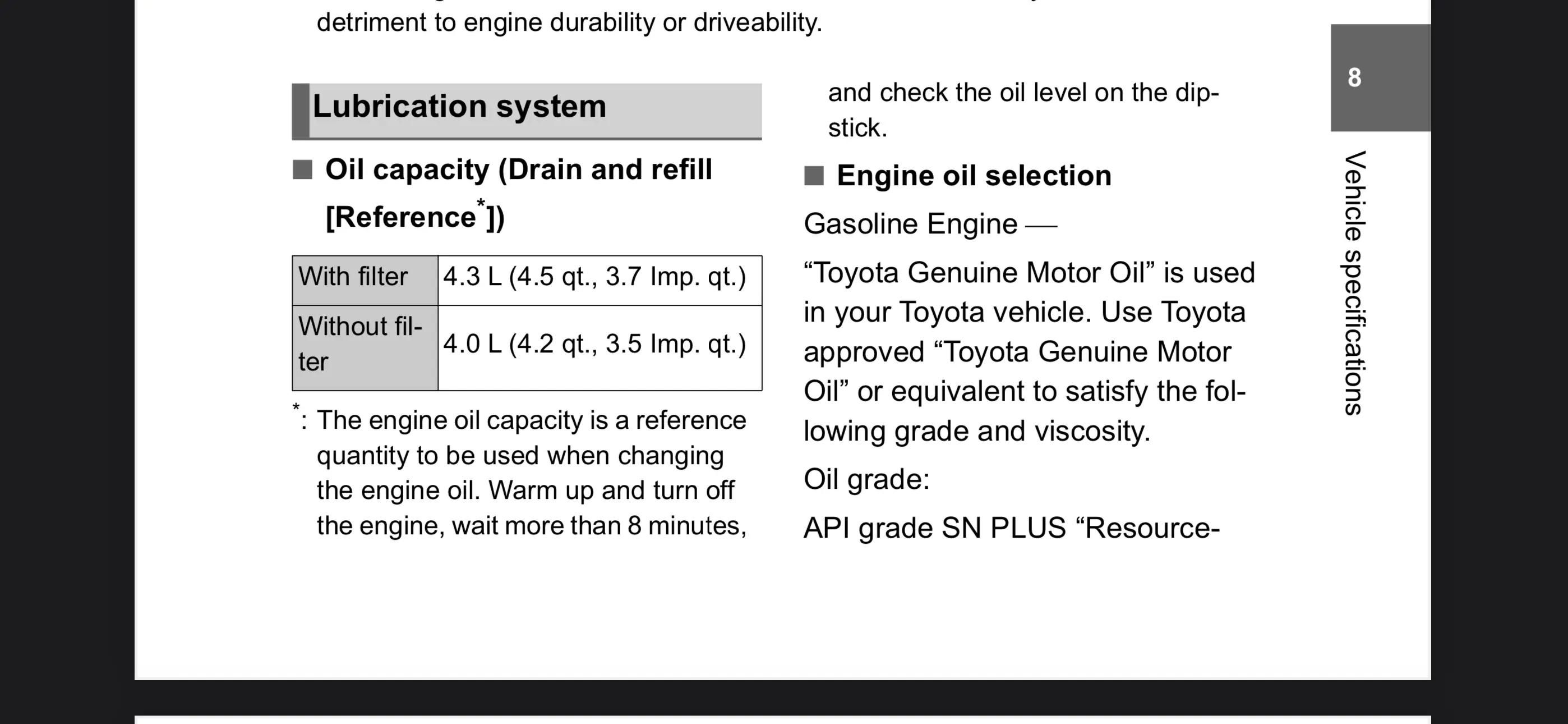

He is asking because he is also correct. In the manual the procedure is to warm up the engine and let it sit for more than 8 minutes before checking
He presumably wants this so he can check the oil when the car is cold and subtract the delta between the two so he doesn't have to wait around
You do you boo, but officially here is the manual extract

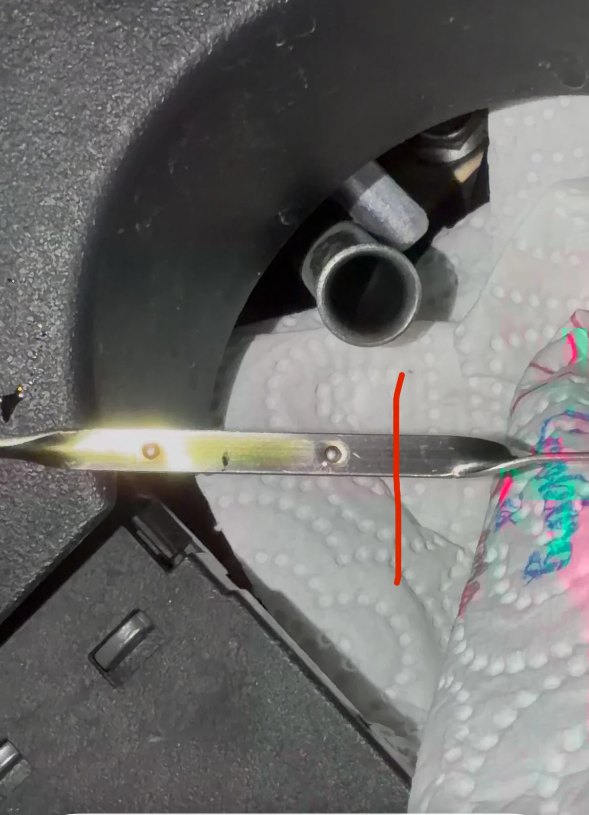

Sorry to bring up an old post... I had my MK2 serviced and after 900km I checked it, and while it was hot and idle for 10 minutes, it was over the maximum... I think it was about 300g... I think the dealer put 4.5L instead of 4.3L. Is that possible? Do you recommend removing the excess? Could it have done any damage? It's hard to see but it reached where the red line is.
Sorry to bring up an old post... I had my MK2 serviced and after 900km I checked it, and while it was hot and idle for 10 minutes, it was over the maximum... I think it was about 300g... I think the dealer put 4.5L instead of 4.3L. Is that possible? Do you recommend removing the excess? Could it have done any damage? It's hard to see but it reached where the red line is.View attachment 38776
I routinely do about 0,5 L overfilling... and my notion is that that correspond to approximately that red-line (even a couple of mm more). So I think you should be fine 👍
Obviously different car here but the dealer overfills my GR86 by around 0.5l everytime. They must know about the starvation issues and do what most owners do.
thanks… they say they are supposed to put 4.3L… but I think there are more here… on the invoice it was 4.5L… so I don't know what to think… should I leave it or throw it away?
