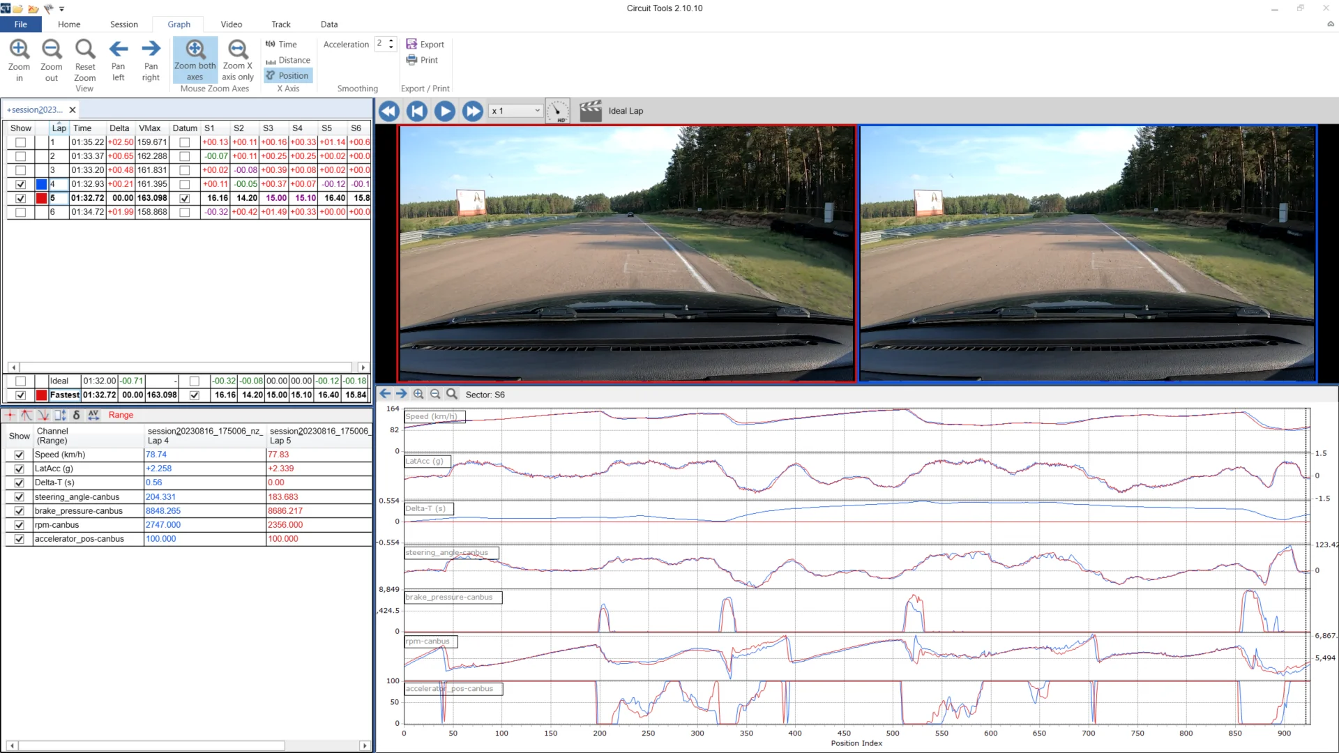

Actually you don't. A lot of sensors are already built into the car, and their signals broadcasted on the CAN bus, most of them at 100Hz, like steering wheel angle, brake pressure, throttle, clutch pedal position, etc.
Here's an example I managed to get on my previous car using a RaceBox, GoPro, a 30€ Adafruit board, and some CAN bus reversing.

@tonic I hadn't seen your project but that's the type of thing I'm interested in. I place greater importance on the driver input data rather than engine performance etc because my engine is basically stock still. What you had on your previous car is basically my goal result.
The purpose isn't for cool video overlays but to interrogate my raw inputs.
