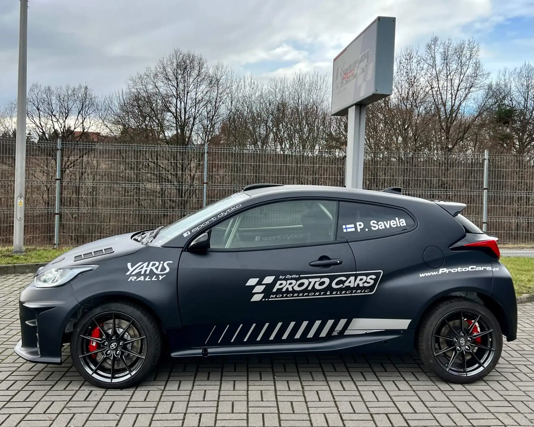

Check out GR Yaris Rally2 ground clearance - it looks wonderful.

Bigem starts under 4k and has longer travel and adjustable higher than stock car...
BOS have the three kits especially designed for the GRY. They are cooperating with Gazoo ins WRC as far as I know.
The gravel and tarmac kits seem to be extremely potent but come at a hefty price. About 15.600.
