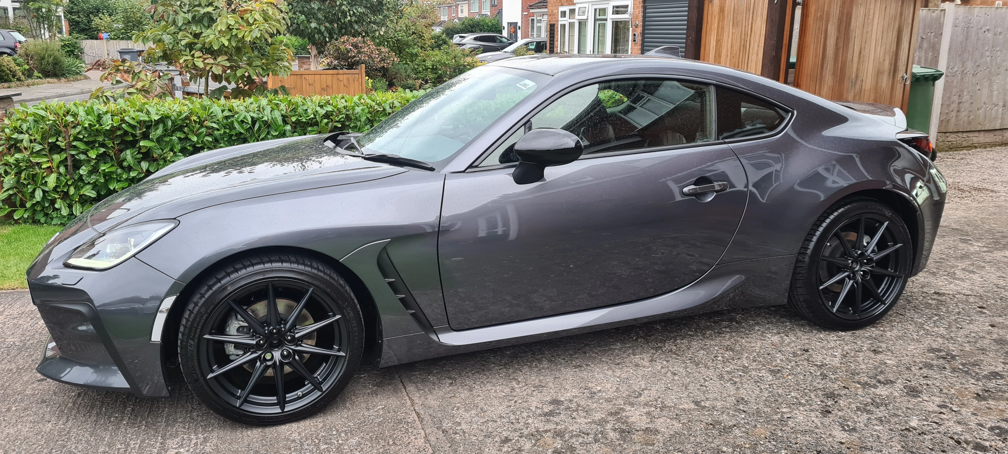

A few of my customers cars have had the machine polishing done by me... Then sent for ppf... Then a good quality coating ontop. ..as well as wheels/glass/calipers coated etc.. As Pic. 👌😎 (full extended front end ppf + whole car polished)
The customer was a bit worried that half the car with ppf would look different to the other half and the paint would be "dulled down" but it was perfect. The xpel ppf was great,and mated to the machine polishing resulted in a awesome gloss.
