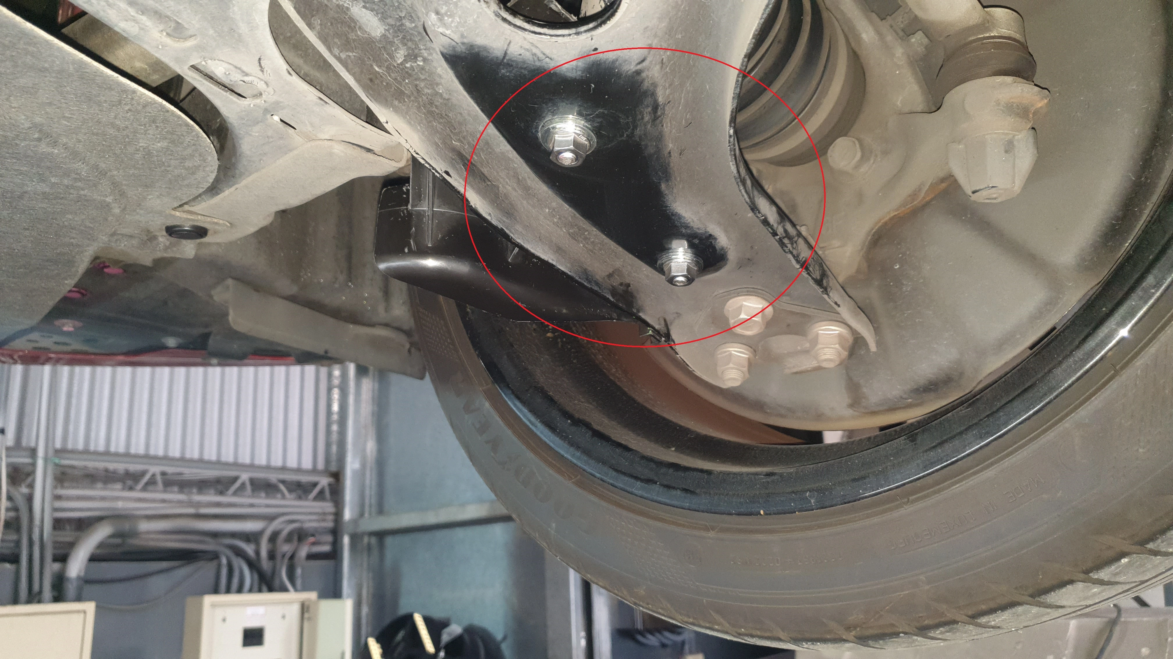

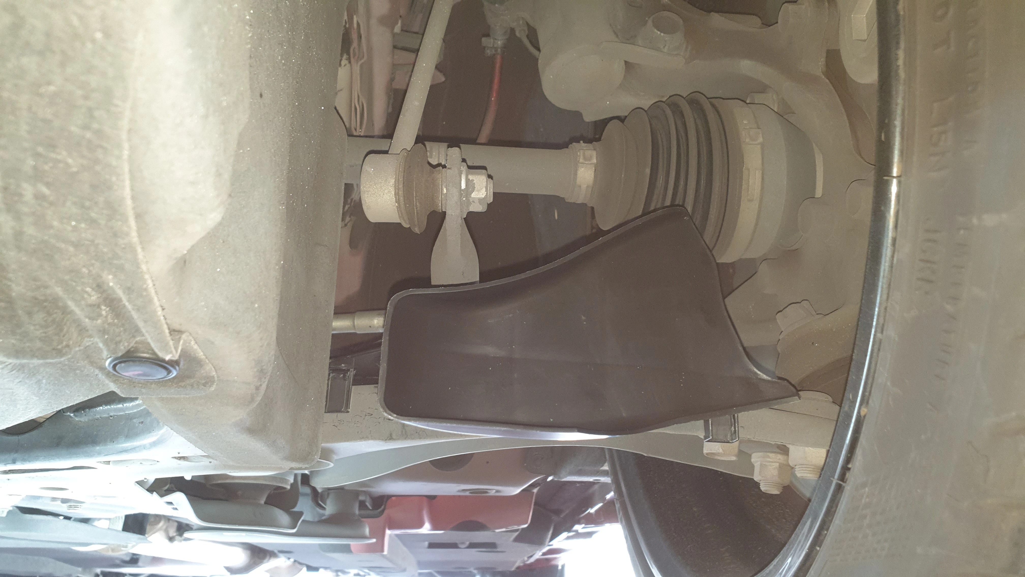

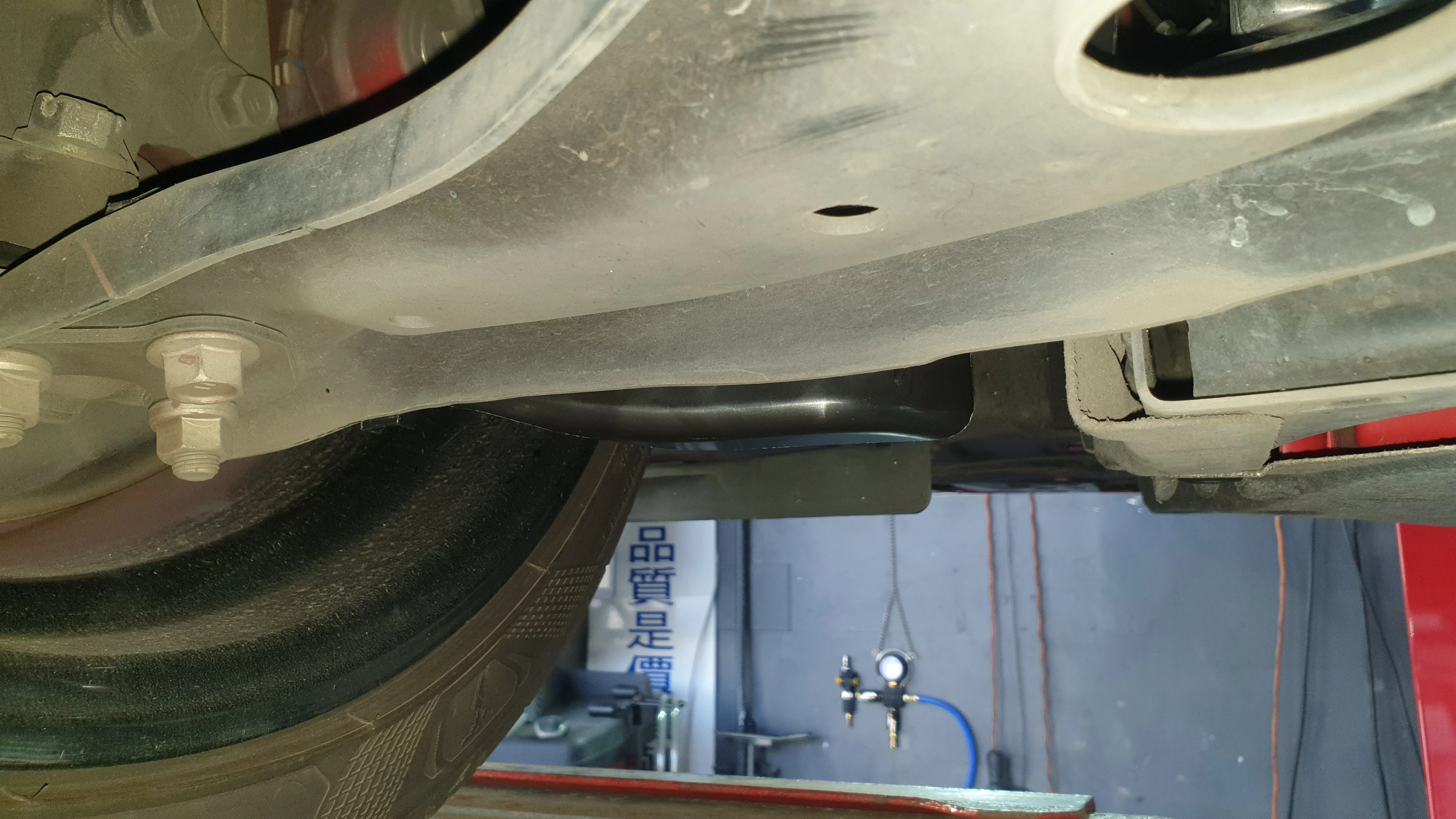

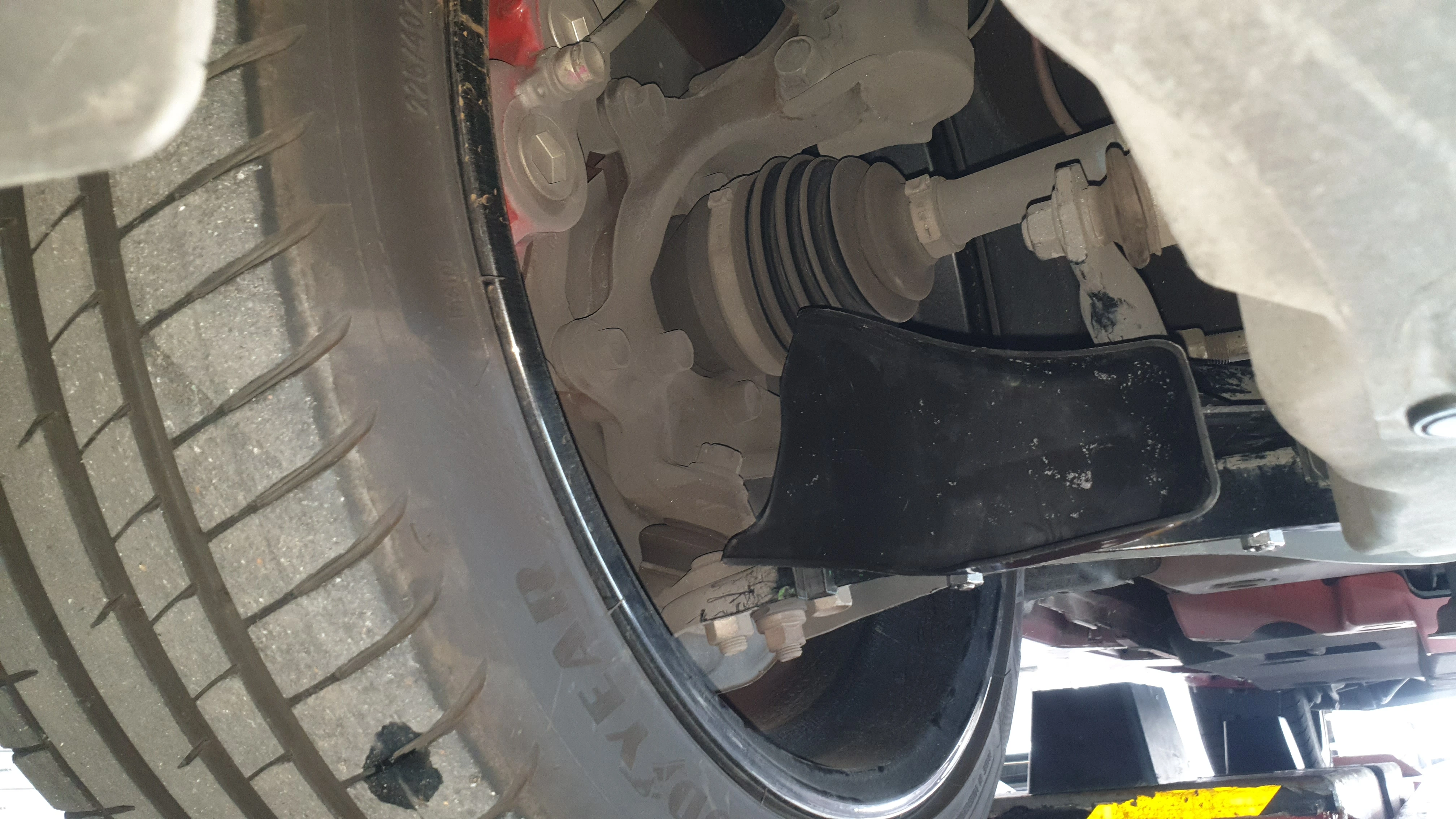

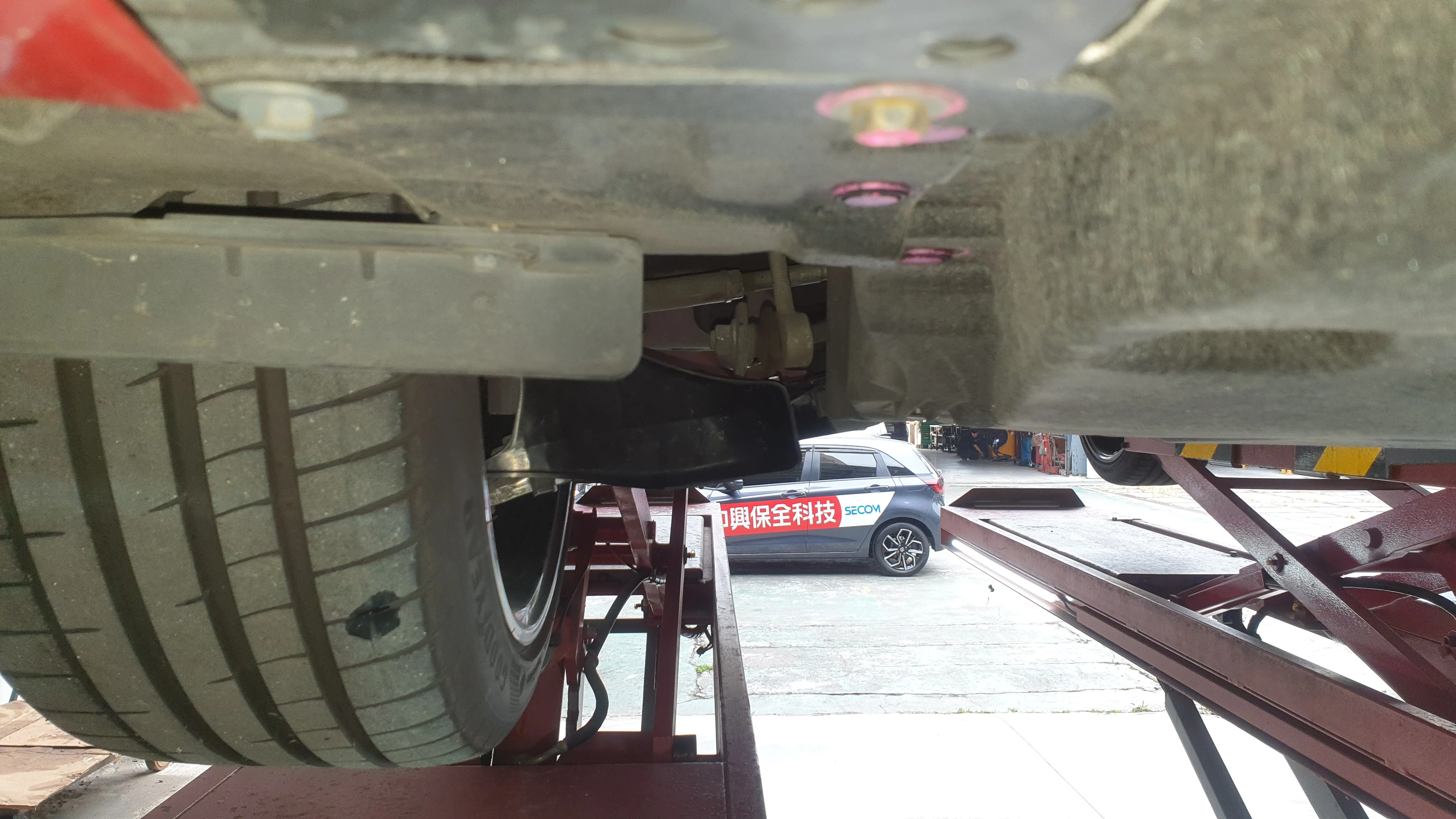

Cheap brake air duct, It has been tested for 2 months without any problems.
1. Audi Part No: 8V0-407-811 (Left Side ) x1
Audi Part No: 8V0-407-812 (Right Side) x1
2. Washer OD:22 ID:8.4 T:2 /mm x4
3. Stainless Steel Hex Bolt M8 x 35 /mm x4
4. Stainless Steel Hex Flange Nut or Lock Nut M8 x4
5. Plastic Spacer (PP PE ABS PTFE ...) OD:22 ID:8.5 H:18 /mm x4
6. Loctite 243 (Not necessary)
7. Cut an arc on one side of the Air Duct (As shown in the picture )
8. Cut 3 rear side lock support of the Air Duct (As shown in the picture )
