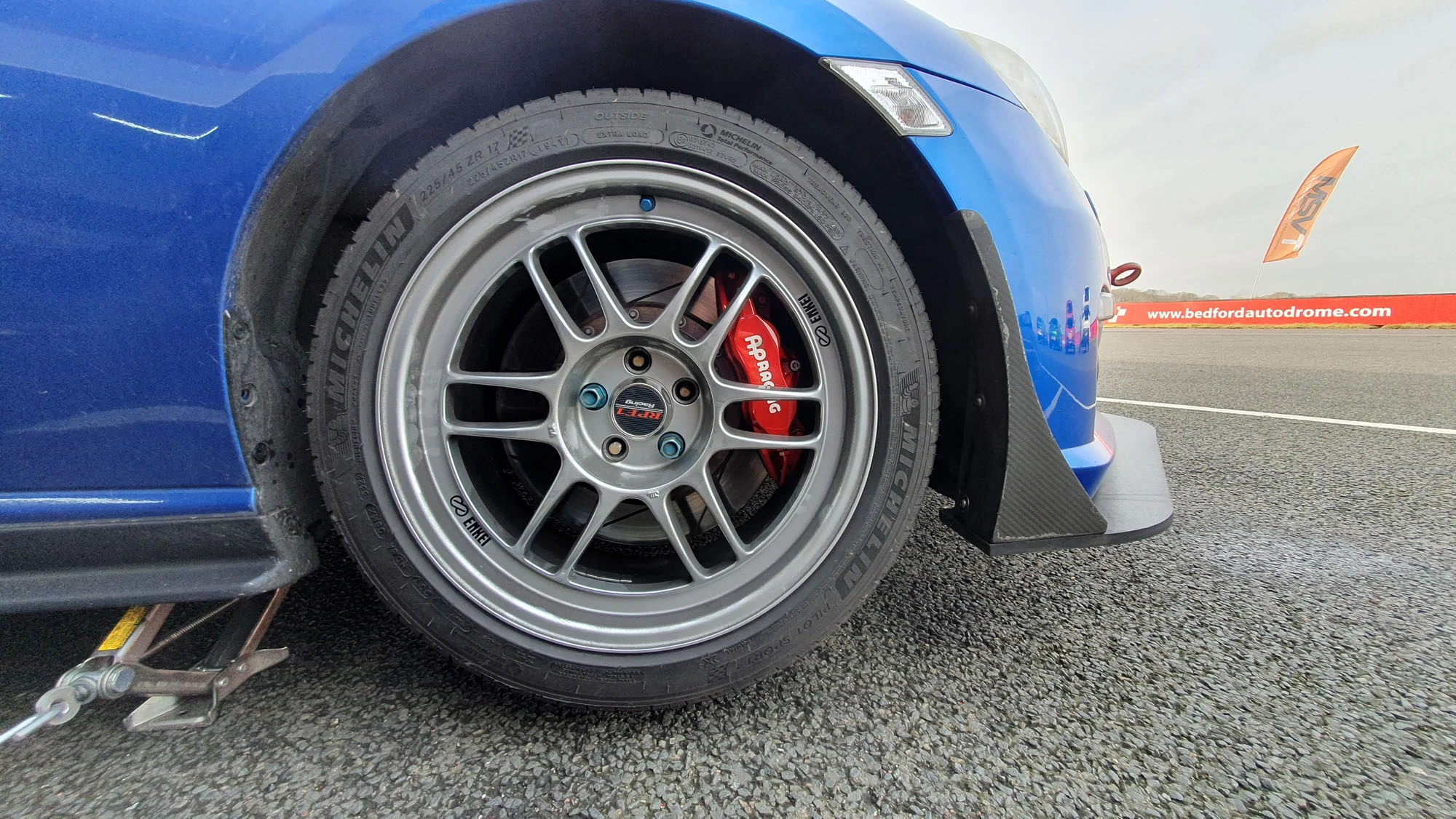

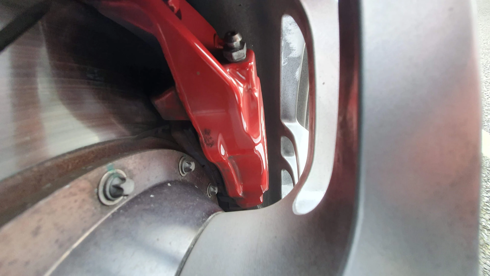

Just in-case anyone else encounters this problem, I thought I might as well update the thread.
It turns out you can fit a 4 pot BBK under 17" Enkei RPF1's. Well at least two BBKs, the EBC Apollo and the Reylands Motorsport AP BBK.
A massive thank you to @Will300 for helping me out with this and answering all my pesky questions. He really went above and beyond with brake profile templates and physically trying a wheel onto his car with the AP kit to prove the fitment.
A big thank you also to Tarmac Sportz and Tegiwa for printing out templates and offering them up to wheels for me.
Pictures provided by @Will300
Great stuff thanks for sharing and for Wills support.
