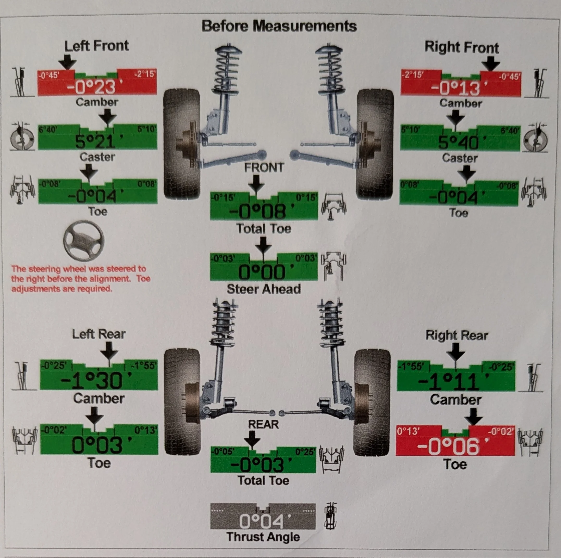

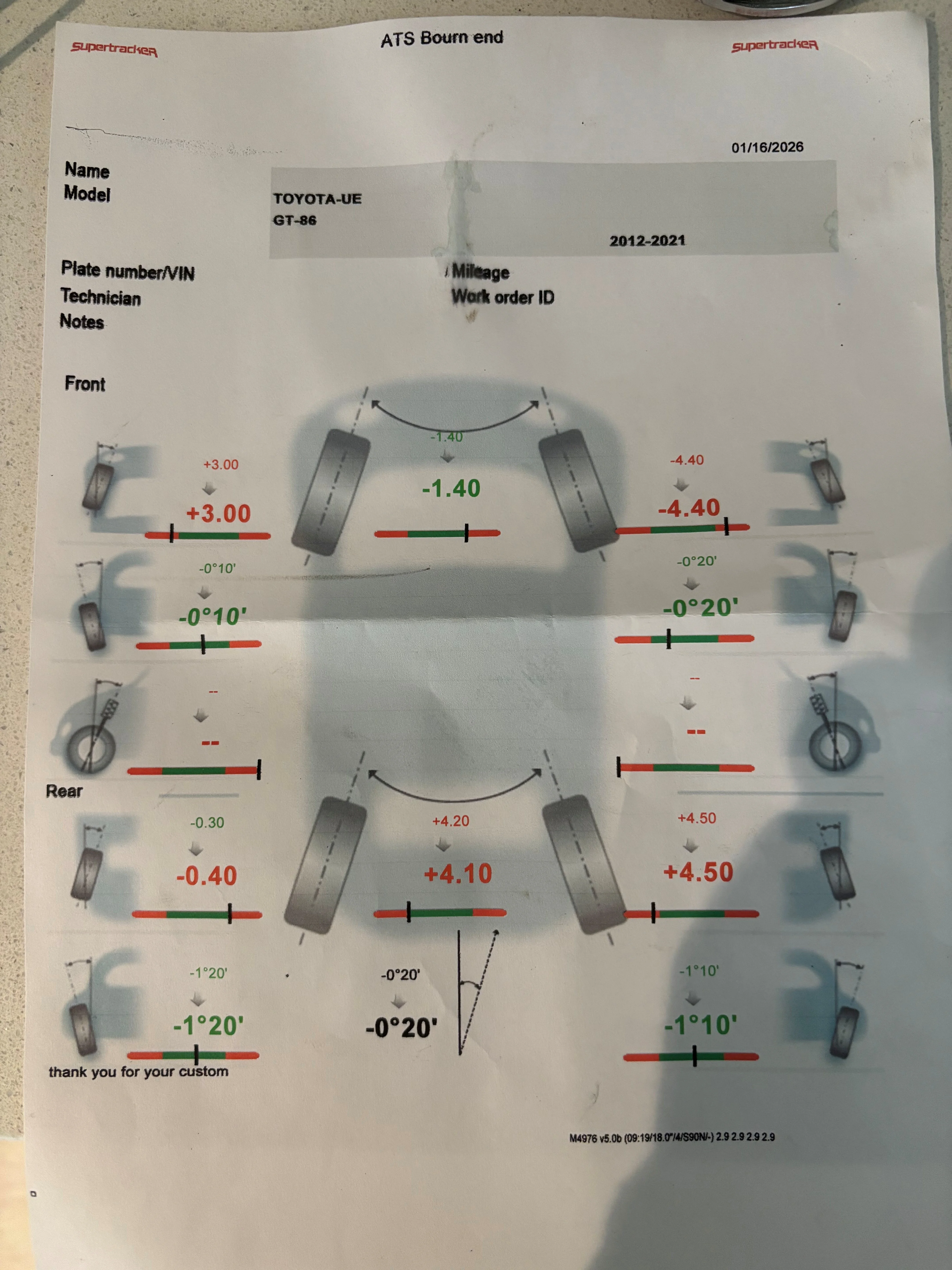

So, had all 4 tyres replaced recently and whilst doing it, the tyre guys checked the alignment settings.
Now it seems that my car's settings are a little all over the place with each tyre set to toe-in .
What's the general advice from those more knowledgeable about the geo settings? should I set these back to factory or leave it as-is?? (The car tracks straight on the motorway and seems stable/not nervous)

Yeah that's horrendous, by far the worst I've seen anyone post up for a GR86 or GT86. Have you hit anything on the driver side rear?
Im really surprised that doesn't feel sketchy to drive.

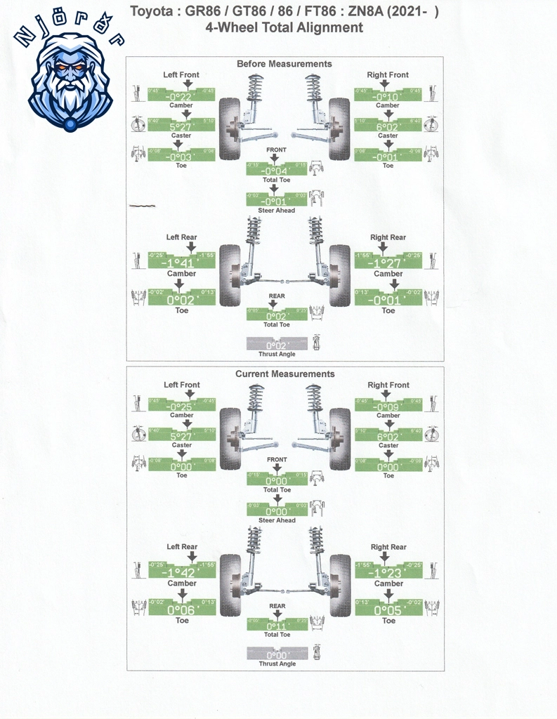

EDIT:
For reference this was mine. I was fortunate in that mine was good from the factory.

EDIT:
For reference this was mine. I was fortunate in that mine was very good from the factory
Haven't hit anything to my knowledge no!! (I am the second owner of the car though)
I would get it done asap, it does look horrible
Follow the toe settings Sonic have posted if you don't have specific requirements
Cambers are what they are, will need at least camber bolts front or camber arms rear to adjust them
Getting it done tomorrow!
Only use a workshop with a good reputation for tracking. Typically one that local race teams use. Often you'll find that there is one technician that really knows how to and will always get it as close to right as possible. Dealerships are often the worst. Use specialists.
