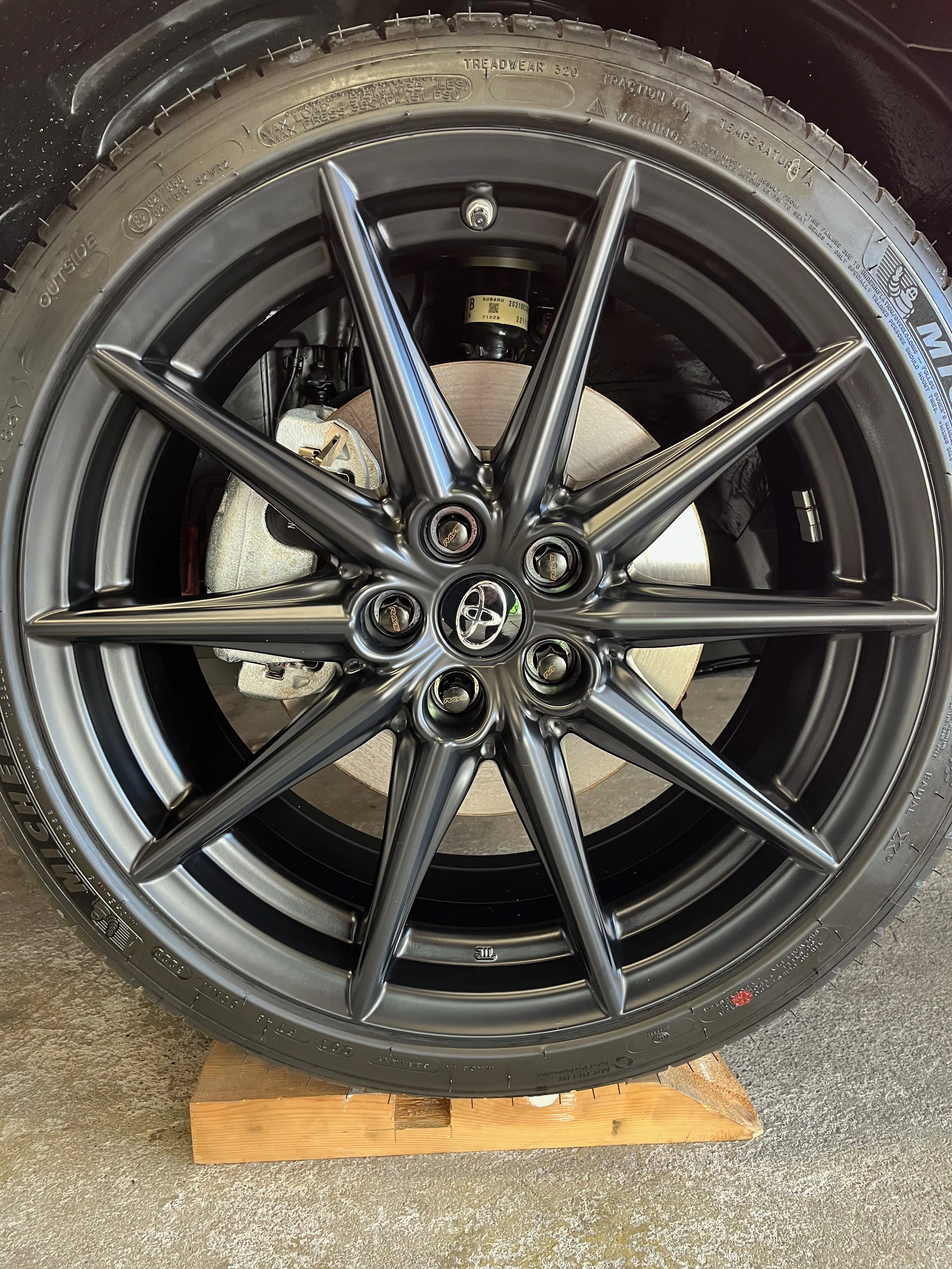

I have Rays on my 86, I just think Black wheels should have Black nuts.
