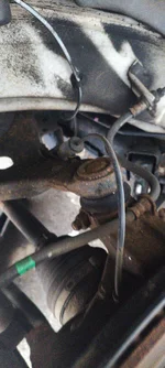

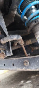

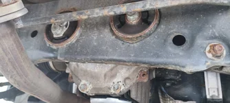

Also while taking wheels off decided to look under the car there is some rust picture bellow not sure if excessive or normal but will tackle this soon ish any advice is welcome to best product to use pic bellow :
MVIMG_20260201_122007.webpMVIMG_20260201_122015.webpMVIMG_20260201_122033.webpMVIMG_20260201_122121.webpMVIMG_20260201_122146.webp
I use ACF50 but I also don’t use mine in the salt.
Japanese cars never fair very well In salty conditions hence the amount of rust you have. The black paint is pretty poor really.
Mine has been driven in the wet after ACF treatment and looks like this after 4500 miles.
Unfortunately is like this now will deal with it the car last year and did drive couple occasion s in winter due my other car got scrapped but now will deep clean pressure wash and do the treatment the ACF 50 is great product! will give it a shot
