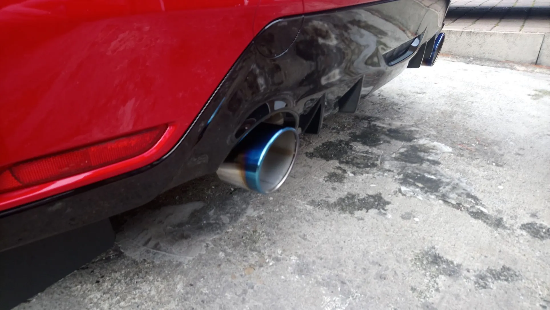

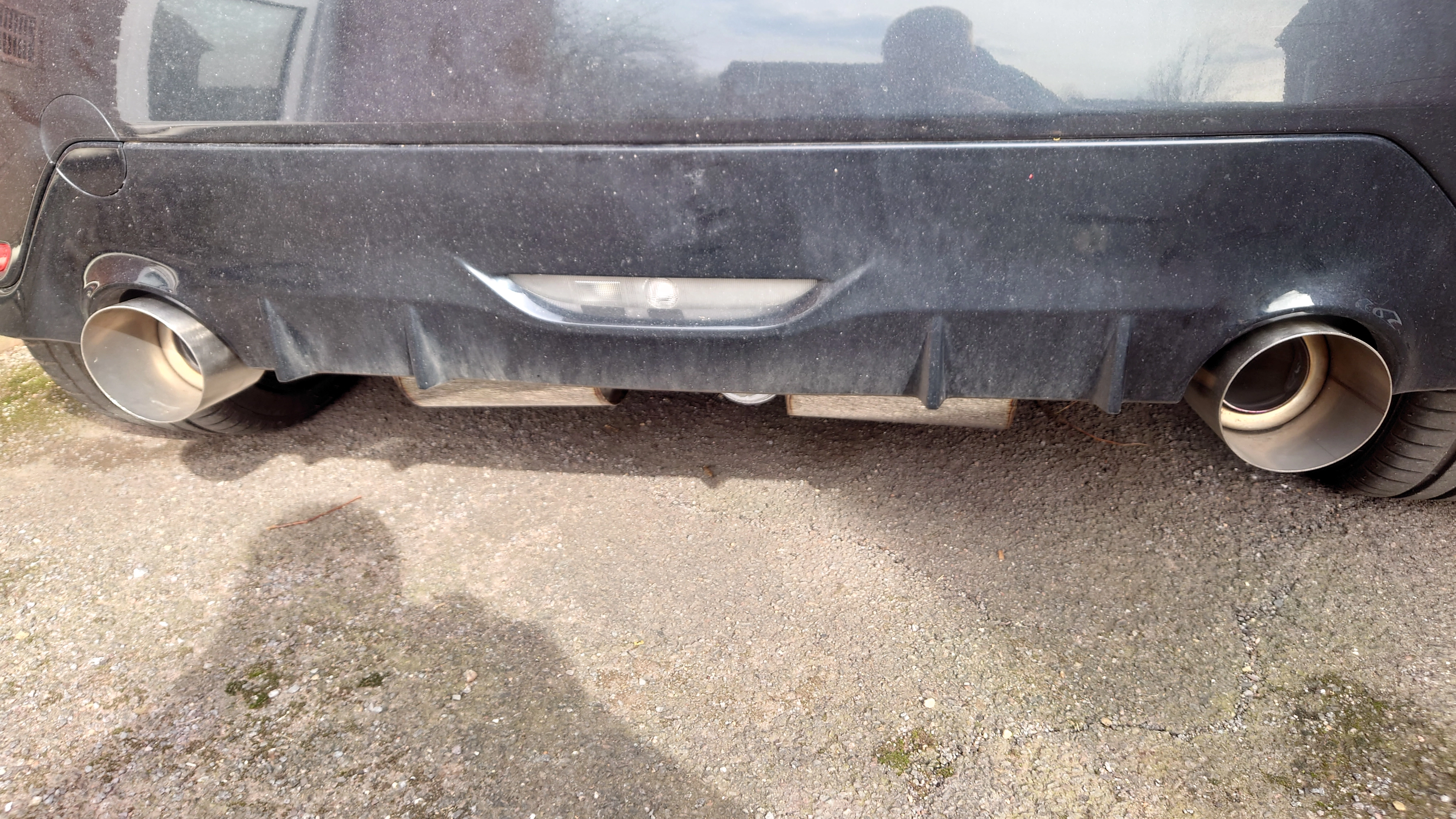

I have the titanium gpf back, I weighed everything to just over 7kg. The system compromises a couple of extra clamps over welds, but the cost savings on similar Ti exhausts is huge (bought mine in the Black Friday deal).
The noise is improved with no drone at all throughout the rev range. Very happy with it and it was a doddle to fit. I had doubts originally about 4 1/2” tips but they fill the area very well and I like them now.

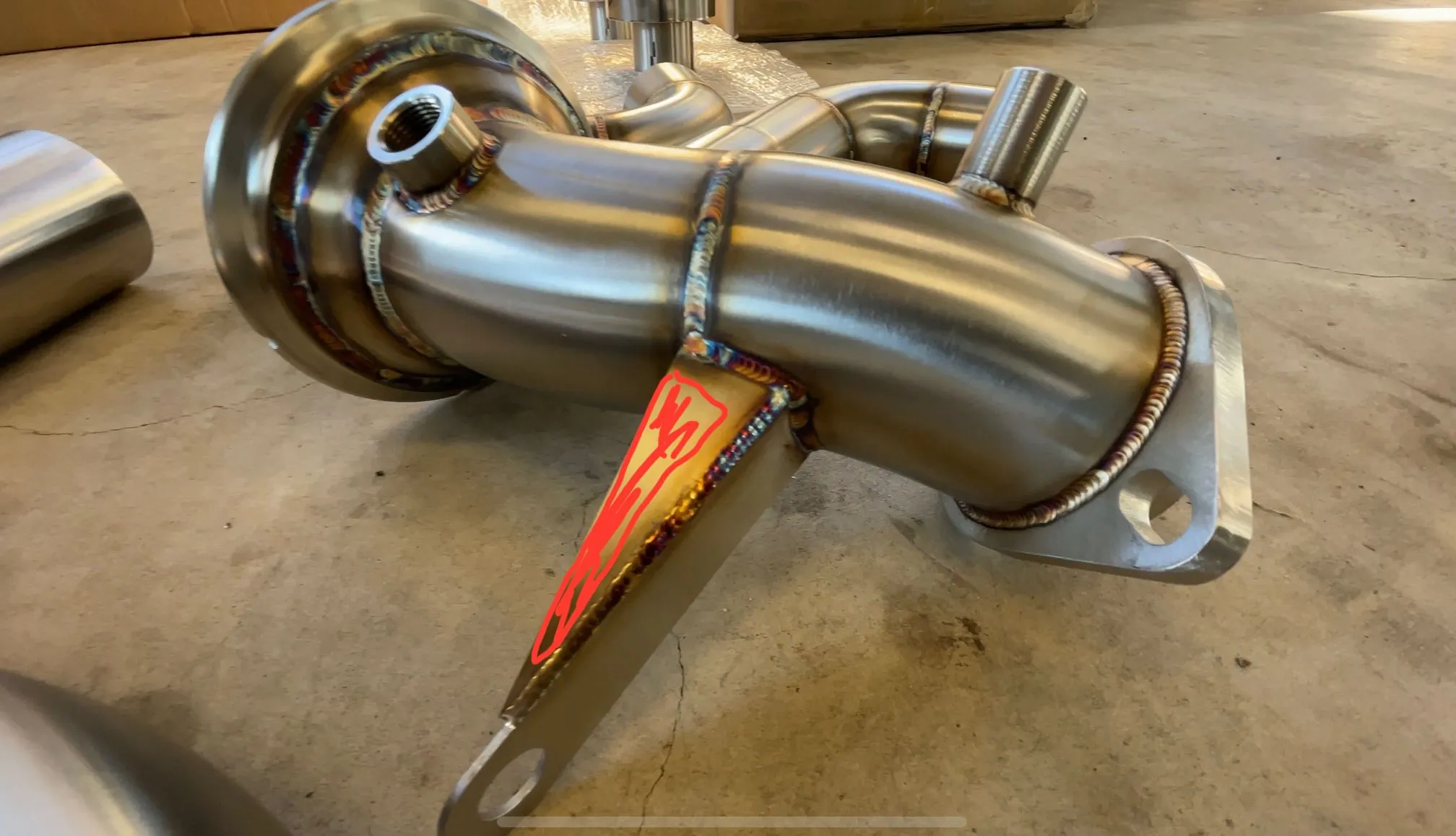

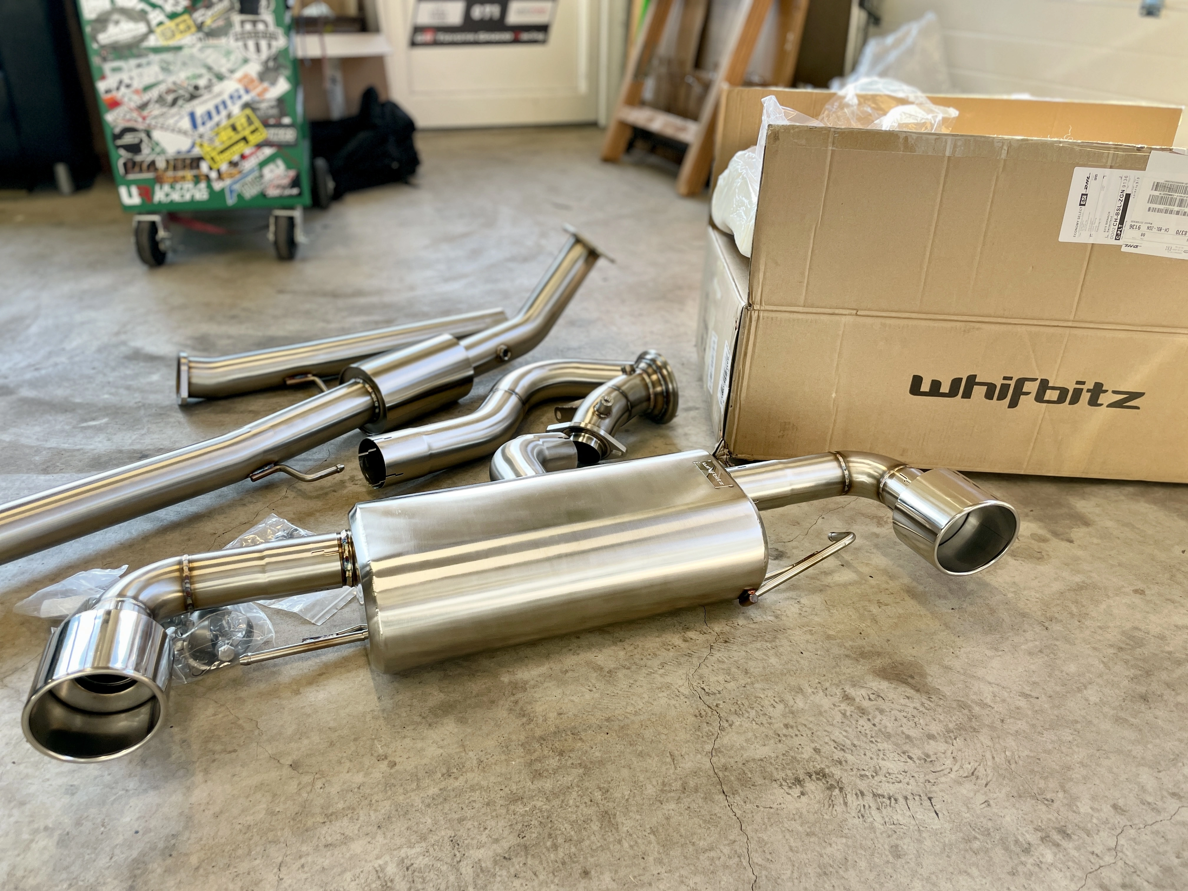

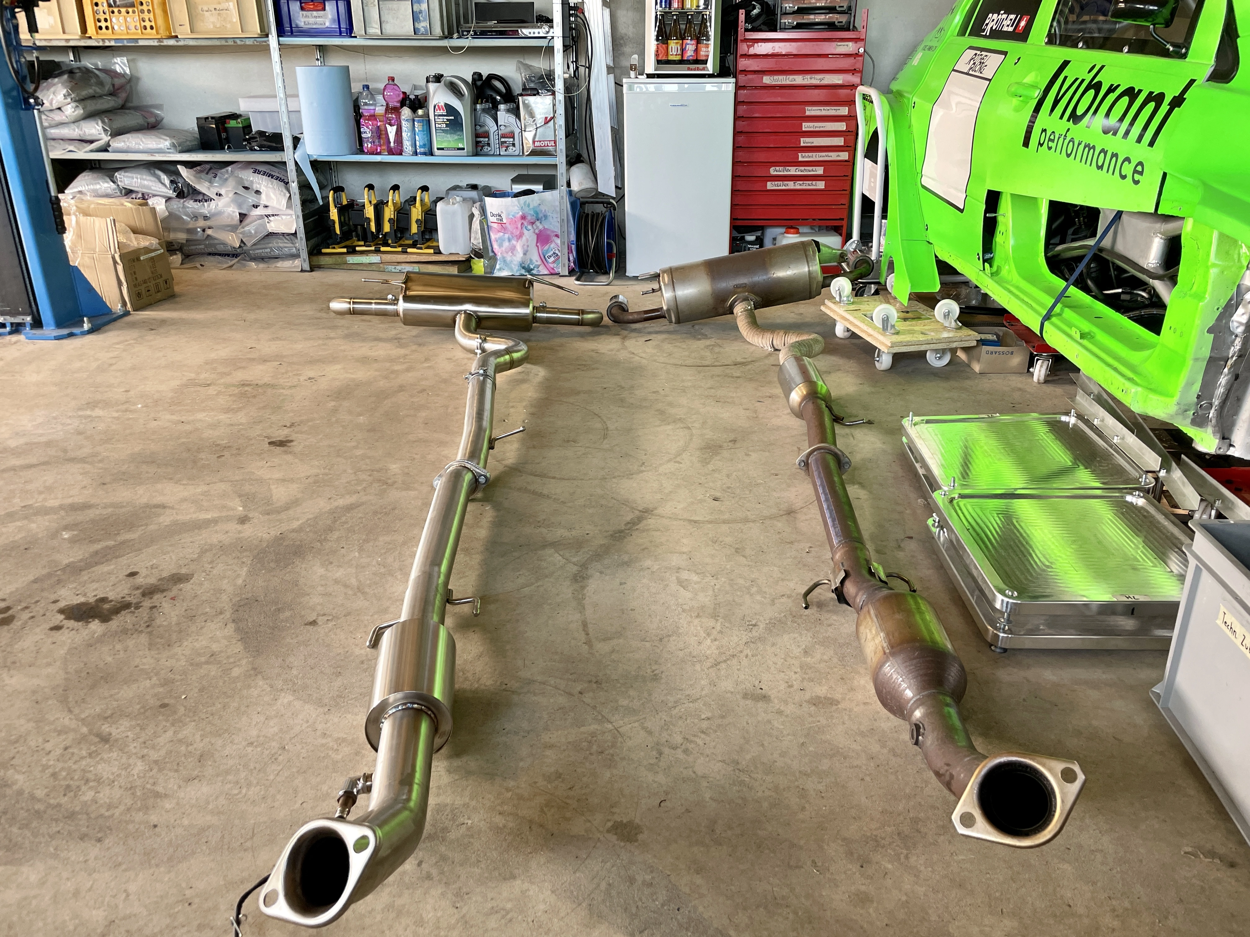

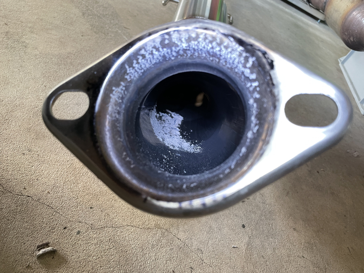

Have the full 3“ Turboback System with Cat. and OPF/GPF delete pipe.
Works great. Video will come out in a couple of weeks.
One thing tho:

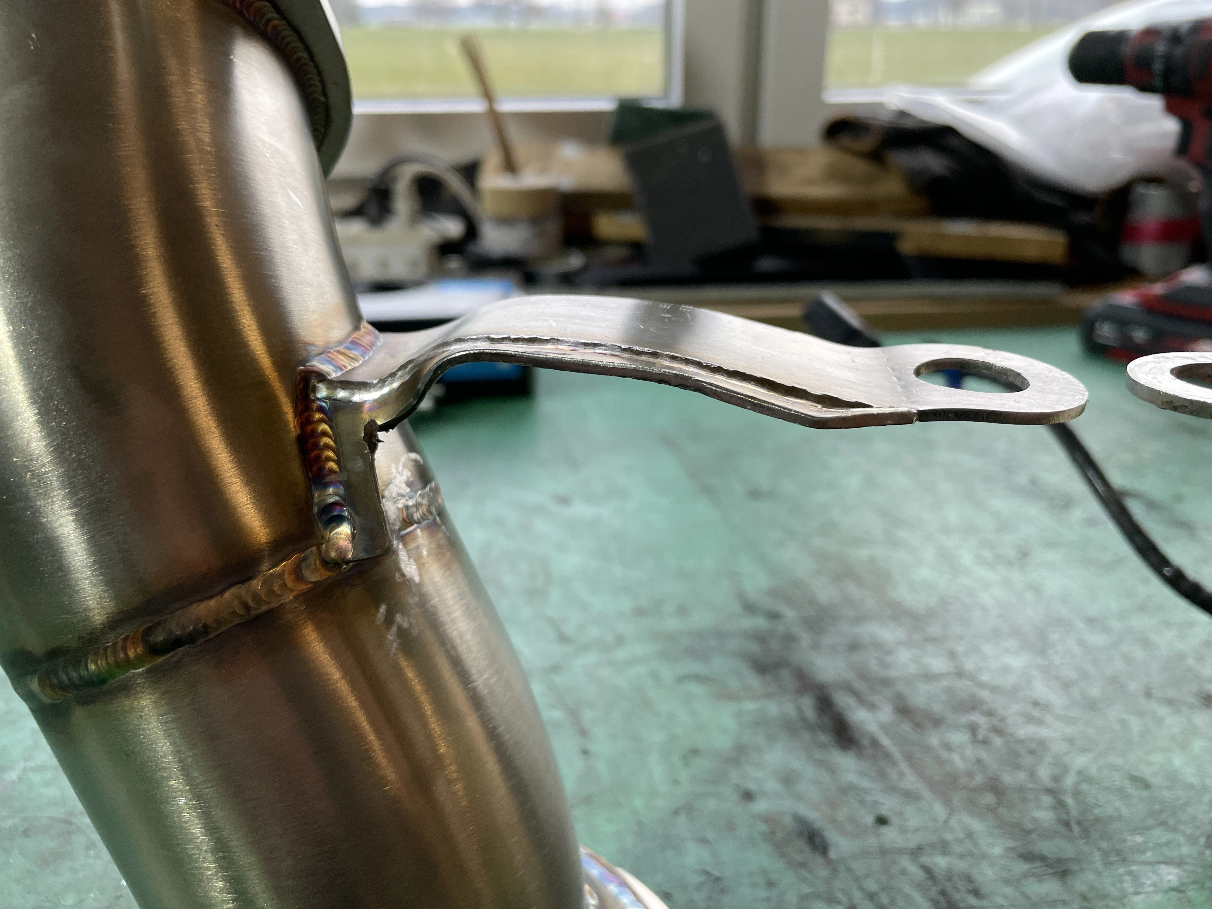

The bracket at the downpipe didn‘t fit at all…
We had to cut and bend it, so we could install it.

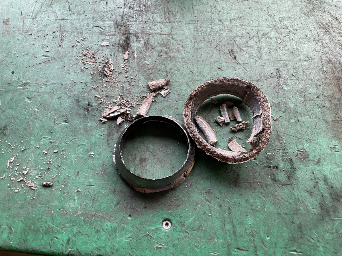

Plus we had to cut the bolts who connect the OPF/GPF delete pipe to the rear section, because they seized during installation.
So just use other ones!
And that‘s how the bracket of the downpipe looks for now before we make our own bracket.
But besides that, i‘m happy with it.
Sounds great and the rest fitted like a glove.

Nice! Where is that 🐱hiding as I see only straight through system?

That’s not good, I used the original Toyota one when I fitted mine no problems so far, I have covered about 700 km since fitting got a major road trip coming up with 1800 km to do, now worried.
Original Toyota is perfectly fine.
But it doesn‘t fit with their Cat. delete downpipe, because this has a diameter of 73mm and OEM is 71mm.
So as long as you have the OEM gasket, you‘re fine.
