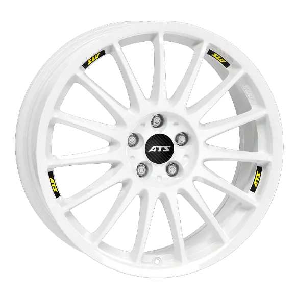

Yup I've noticed that too. However I've just recently seen an ATS Streetrallye (which isn't even the lightest wheel in the world tbh) hilariously fail after only two years of use on a car that weighs 1050KG. The wheel is TÜV approved as well as having one of those "typical" strong Designs. A medium sized pothole was enough to crack the wheel, with the tyre actually staying intact..

If you're concerned but don't want to pay top dollar for forged, go for flow formed. Note however that lot of wheels advertised as flow formed aren't actually flow formed until from a certain (usually quite large) size. The only ones in 18x8 I know for sure are the OZ with HLT in their name, and the Braid ones that are flow formed even in small sizes and are supposed to be very strong motorsport wheels (but I have no independent testing to proof that). Maybe others can add more.
PS: and weight doesn't say much about strength, can both work for and against strength all depending on where the weight sits and the material quality...

Thank you for the insights, thankfully I'm not currently on the hunt for new wheels, just wanted to add my input :)

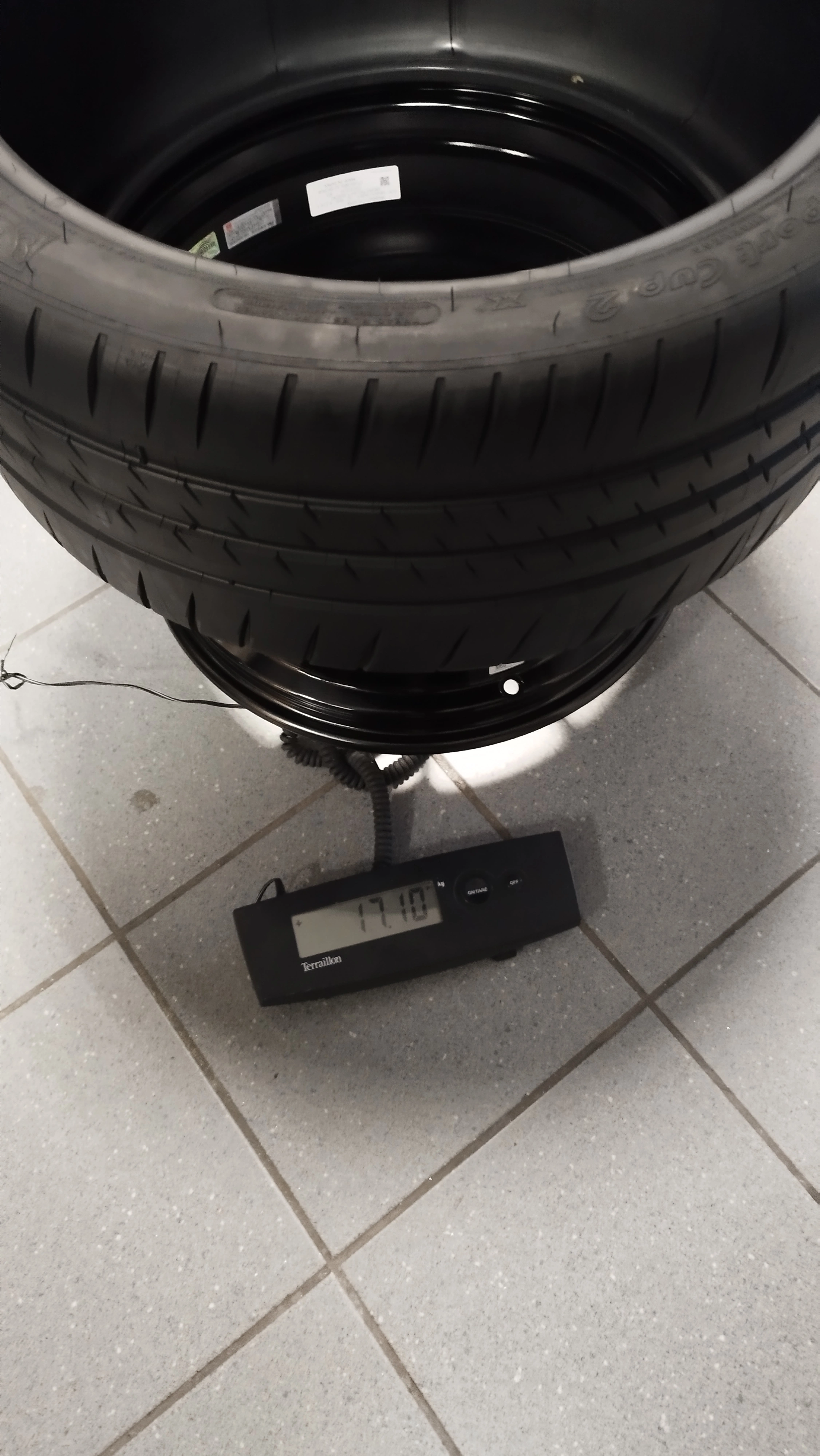

I wanted to share my new setup.
OEM wheels 8 width and 225 tyres
Track setup 8.5 TC105X with 245 cup2 tyres and some light nuts.
Overall 500g lighter per wheel ! :love:
Still have to buy Wedssport aluminium hub-centric center cap (out of stock now) so it will add some weight back but those will not be heavy I guess
