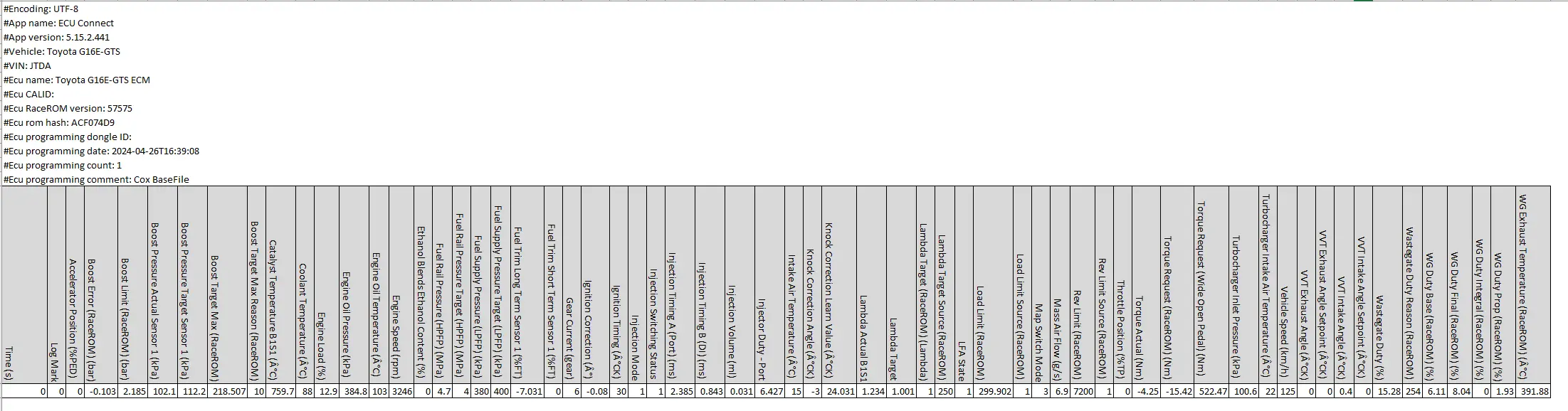

You mentioned you could see the boost safety on racerom. What else can you see there? Is there possibility to make any own settings? I've seen it on other platforms but haven't seen the UI for our cars....
Not sure how well the above will come up on screen, but there is a line extract from a 0.1 sec log.
The beauty of this for me is the incremental data log knowledge base. Every customers log files submitted back to EcuTek will build a holistic database of performance characteristics according to modification, age, wear & tear, climatic conditions, fuel types, so as the cumulative data builds the learnings will develop and better map iterations can be released. Normally for generic tunes maps are developed off of a couple of cars and then that's what you get. And it's incredibly unlikely you ever get a revision update or the chance to reload your map without return to a dealer. FOr a generalist who doesn't want a standalone ECU like Syvecs and just wants a really solid fast road car I can't currently see anything better on the market, and selfishly I don't think the affiliation to the Litchfield brand dents the future appeal or value of the car significantly should ever I look to move it on.
Reactions: Onehp and p3.auto
"Not sure how well the above will come up on screen, but there is a line extract from a 0.1 sec log."
No Problem.
Yeah, a hive mind of logs and feedback is good assuming the data is being stored centrally and not just at Lichfield but even if kept locally it’ll help develop their own maps. Would imagine it’s being fed back to Ecutek too though.
