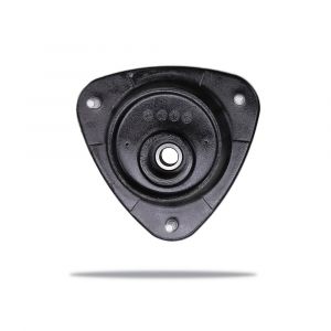

Pedders offset top mounts & camber bolts. I didn't want to run coilovers with solid metal top mounts for NVH reasons - these should give plenty of scope for camber up front. I'll be re-using the rear top mounts from the standard struts

Got them direct from pedders. I have to admit I didn't shop around. I was going to get rear replacement ones (OEM Spec) from them too, to help smooth out the install and make swapping back in the future easier, but for the cost I didnt bother in the end.
offset fronts
Rears (part number)
585014
They arrived a day or 2 after ordering, can't complain
