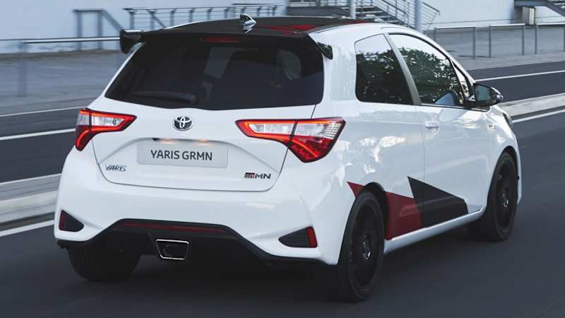

OP needs to clarify but the flair makes me think he is talking about this car.
And not the GR Yaris based one.
