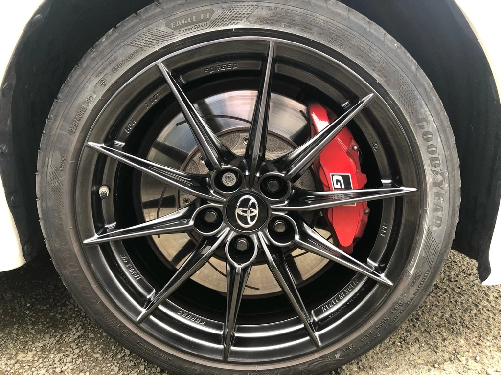

Any decent wheel repairer will be able to match it. Mine sprayed the wheel black then dusted over with chrome paint. Nobody can tell the difference between the repaired wheel and the others. The repairer took another wheel off as a guide. So you don't need a paint code as such.
wheel shops have said its done like @Lauren has described at the factory. since its a 2 stage process to achieve the finish there is no 1 stage paint code. so no touch up paint. hence everyone i have spoken to is reluctant to try and match it without doing 2 wheels. its so minor I may attempt it myself. worse case I get them all done in matt black like the First Edition.

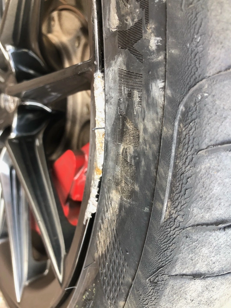

Cheap option is just to leave it. I wouldn't repair a minor scuff like that. I absolutely whacked the rim of my wheel into a kerb in an off track moment at Cadwell whilst sprinting, proper gauged and bent the outer lip, so had to sort it.
After:

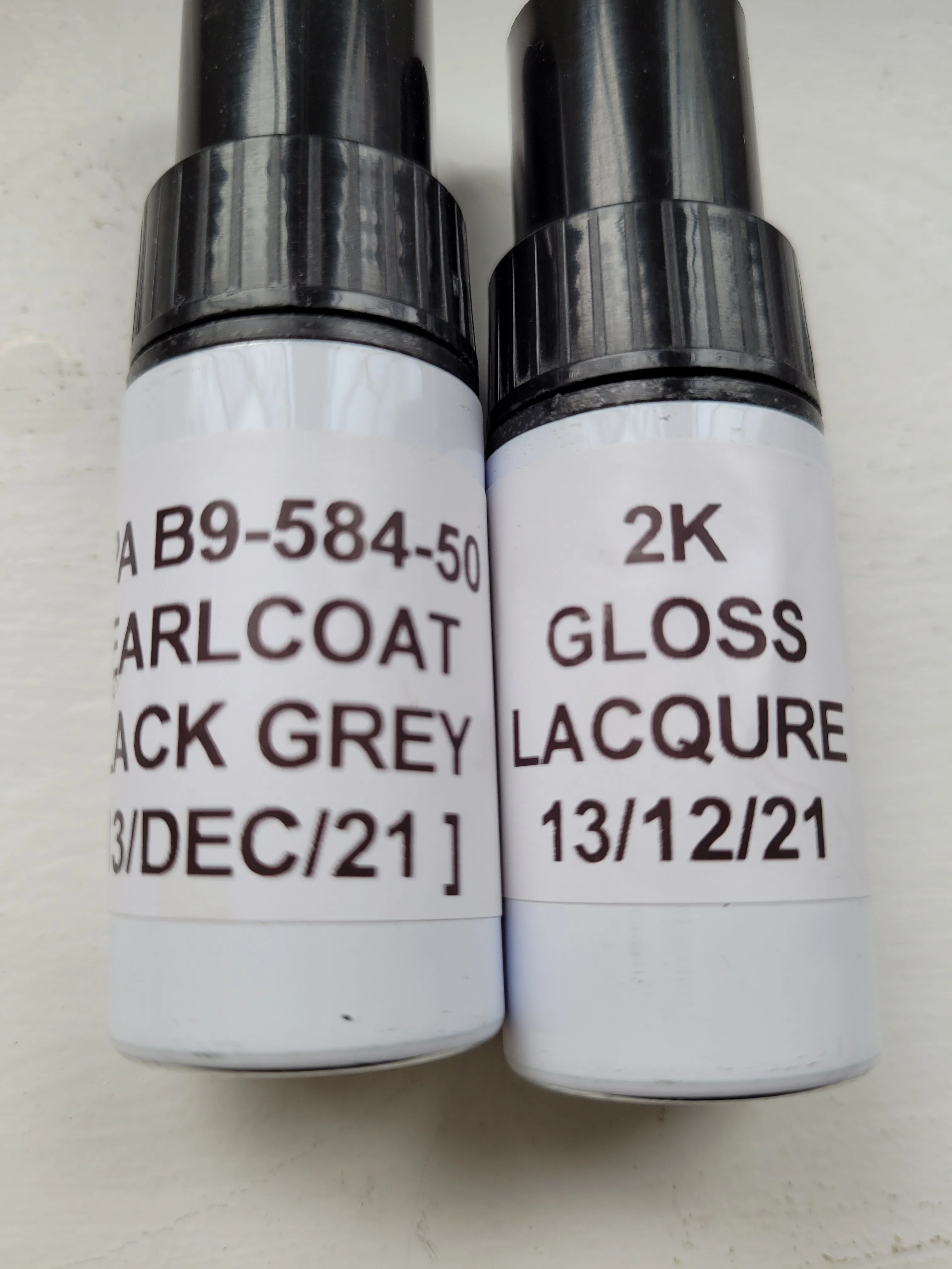

haha. Tamiya TS-40. has just arrived.

I used some epoxy metal putty to fill a small, pin head size paint chip on a wheel spoke, followed by Tamiya 82140 LP-40. It's far from perfect but much better than pre repair and once on the car, probably won't be noticeable to all but the most eagle eyes.
