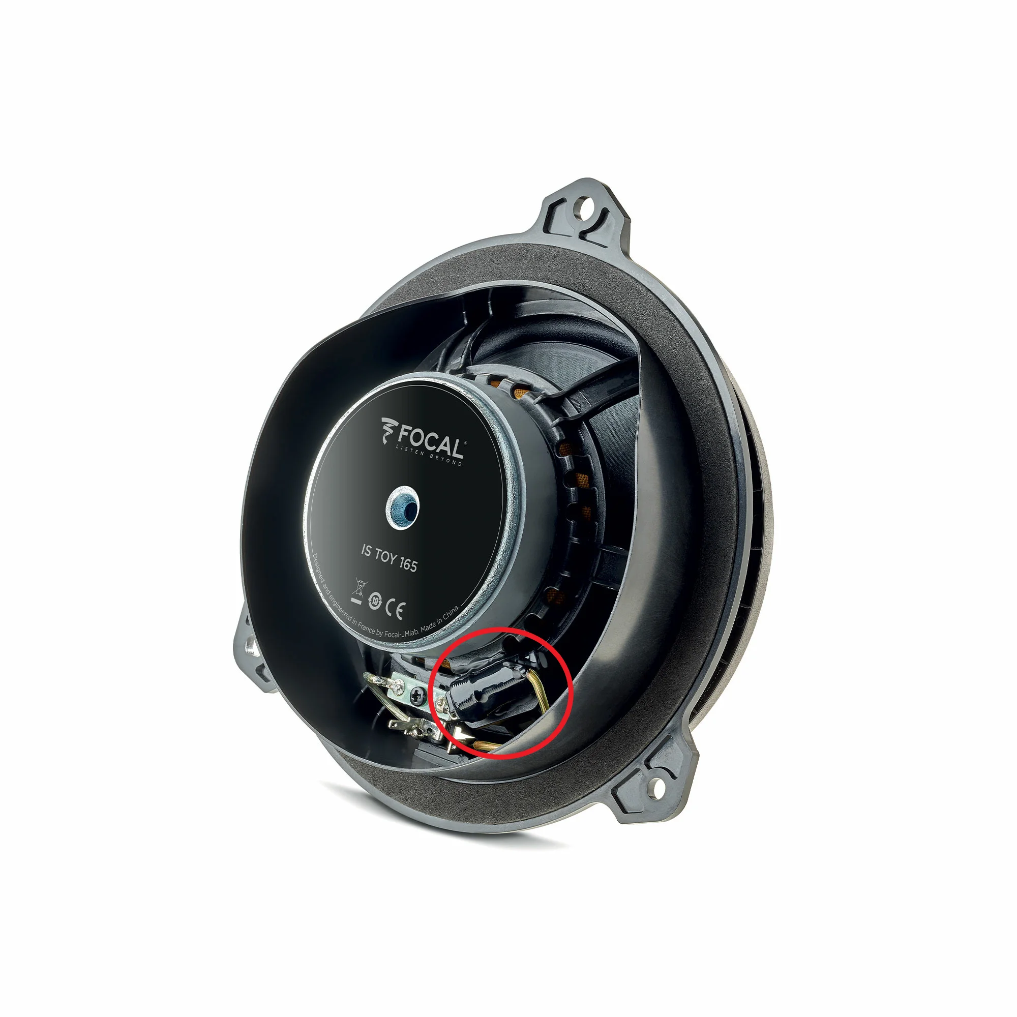

So the ISTOY165 kit fits fine in place of the JBL's- apart from the woofer (door speaker) requiring the hole elongated? Did you leave the built in crossovers on the Focal speakers in place- or bypass them? My understanding is the JBL system uses active crossovers so the crossovers on the ISTOY165 shouldn't be required? And you left the stock JBL mid range in the dash?
It's been something I've considered doing for a while for- the same reasons. It just doesn't sound right stock.
Have you left the ANC functioning too- does it still work?
(I've circled the crossover components below.)

I used the crossovers as they came on the Focal fronts and tweeters, they sound fine. I left the stock mid connected in place.

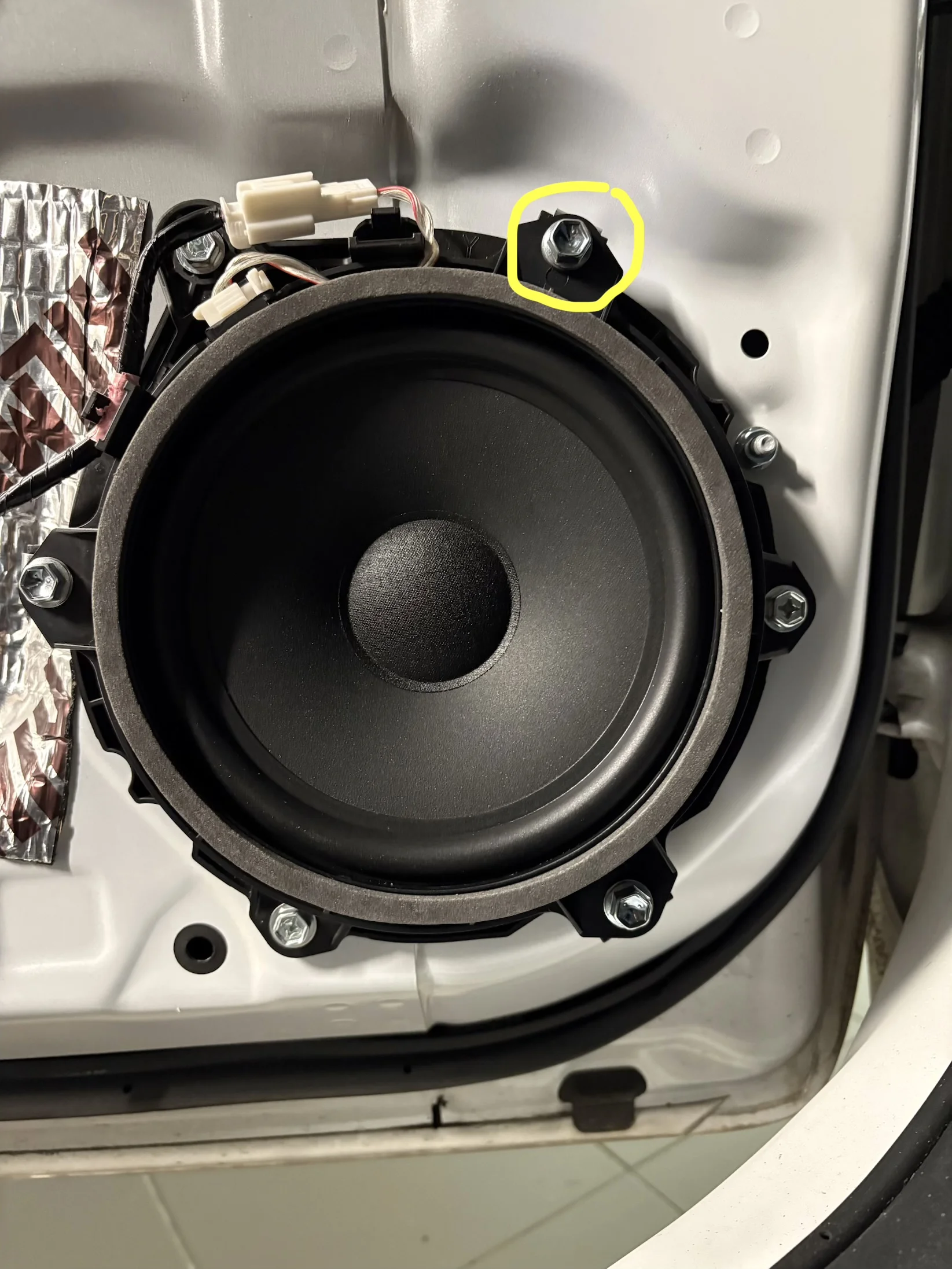

Well, the answer to “when am I fitting them” was…29 December. For the door drivers anyway. Will attack the tweeters over the next few days.
Yes, I had to ream out one of the holes (below) on the new driver. Bit inexcusable, that. The rest of the kit seems well made.

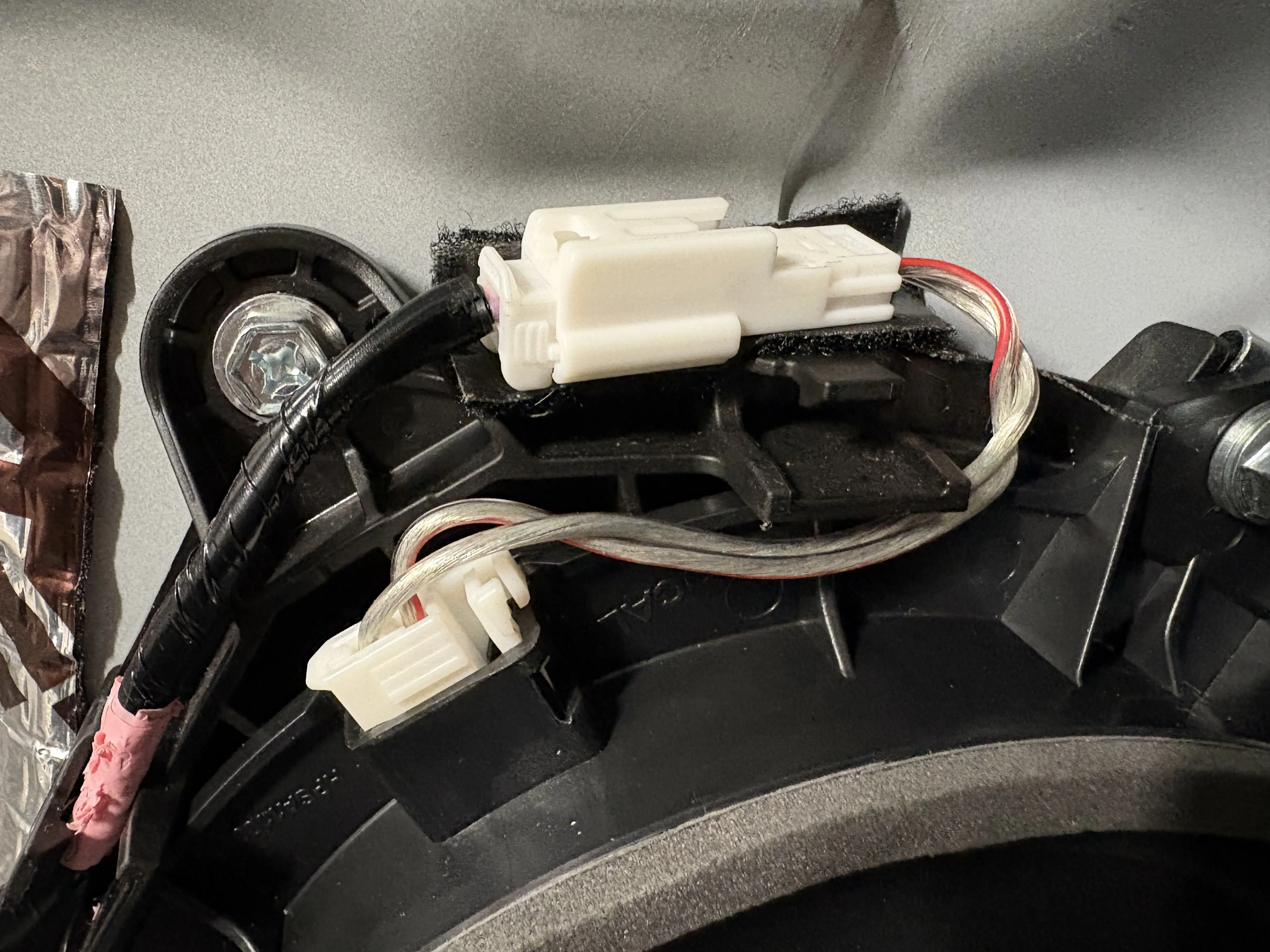

And I didn’t want to leave the adapter cable flapping about to rattle in the door, so Velcroed it down.
You can also see a bit of the dynamat-type stuff that I added to damp some of the wobbliest bits of door panel. Just a couple of bits, really, one next the driver and a larger piece on the inside of the outer door skin.
Figured it couldn’t hurt while I was in there.
