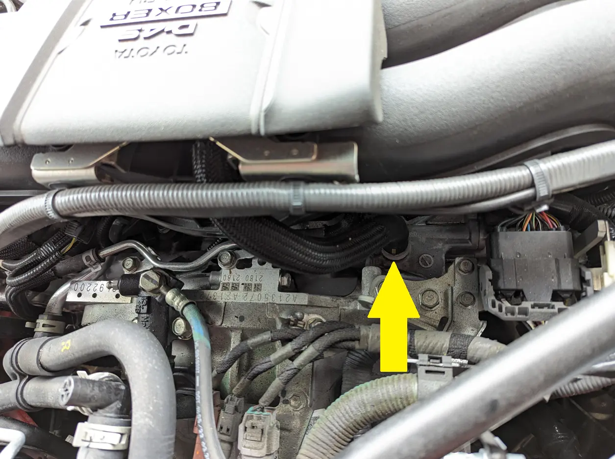

There have a been a few reported cases of sudden excessive oil consumption on the FA24, mainly from the US, (but also someone on this forum too, still undiagnosed). It turns out the culprit is likely to be this…
This being the PCV (Positive Crankcase Ventilation) valve. Its purpose is to ventilate excessive crankcase pressure back into the intake system. This valve is located on top of the engine block at the back of the intake manifold and plumbs from the block into the top of the intake tube.

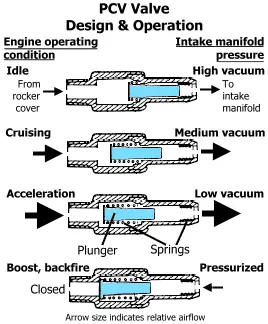

The valve itself is not particularly complex and operates similarly to a check valve, there is a spring and ‘plug’ within the valve body, this picture gives a good idea of how it works.
If the PCV system does not operate correctly you will build excessive crankcase pressure and increase blowby, which not only is unhealthy for the oil as it increases contamination from fuel and moisturise, it can cause oil leaks and consumption of this diluted mix as it burns off, or is pushed past the piston rings. When this is the case, oil consumption can go through the roof, if you aren’t vigilant with checking the oil level and have traditionally trusted your engine not to use oil, there is a possibility of having an engine failure from oil starvation.

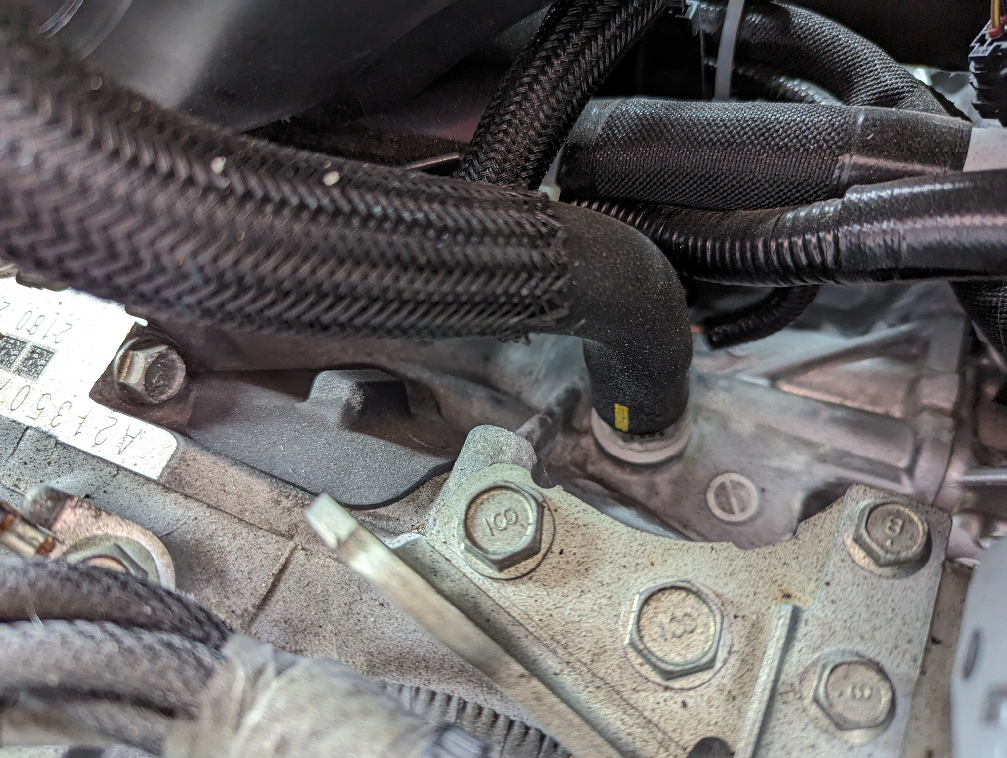

Took my old valve off today and think it was definitely in need of attention. A dribble of oil came out of the hose when I pulled it off, and when given a shake you could barely hear the valve inside. Made a kind of dull noise, as opposed to the clear, clicky metallic noise of the new part. I put the new Chinese part on as I had it, and hopefully it's not complicated enough to cause any sort of critical failure if it's lower quality. The good news is though, that I sprayed some brake cleaner through the old valve and seemed to restore it. So I shall keep in safely in case I need to swap back.
Replacement is easy, tiny bit fiddly. 22mm deep socket with an articulating adapter on a socket extension is all you'll need (video on procedure below). Hardest bit was pulling the hose off, you just need to really hit it with your purse and you'll be fine. There's no clamps or anything, it just pulls off. Maybe do it with the engine warm to the rubber is a bit more supple.
Oh, and the old valve had a touch of sealant (I guess RTV) around the thread. I just used some PTFE tape when putting the new one in. Didn't torque it too much, just tight then a touch more, and after a quick drive with some hard acceleration, nothing leaked.
