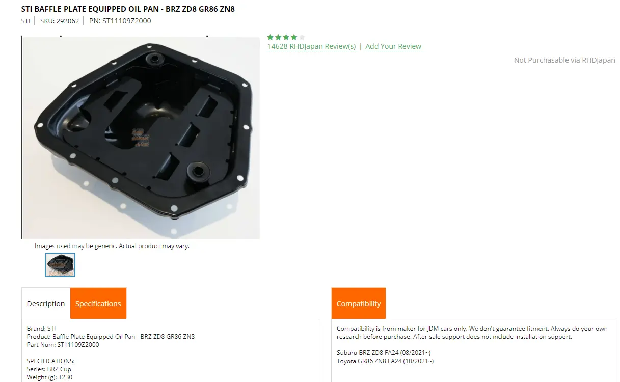

This STI oil pan is sold out everywhere. I'm currently negotiating oil pan removal and cleanup terms with my dealer (I was never planning to do this buy I've found RTV on my oil dipstick during first oil check that got me a little bit worried). If it was available I'd go ahead and throw it in. Imo "low oil pressure" issue is overblown to the moon and should not be a matter of concern for average ZD8 owner. Since I do plan to track mine a lot as I did with my BRZ it is a little bit of concern for me. I'll definitely go with external oil cooler and thickest oil viscosity recommended by manual for now and we'll see how thing go.
Reactions: KobayashiMaru86
Also reading that prototype baffle that guy was going to test didn't make much difference. Thicker oil should be fine, add a better cooler if you track a lot in the heat of summer or just do shorter sessions.
Yeah it's a bummer that this particular baffle didn't help. Someone on yt saw some improvement with Tomei one but it wasn't very significant improvement 😞
