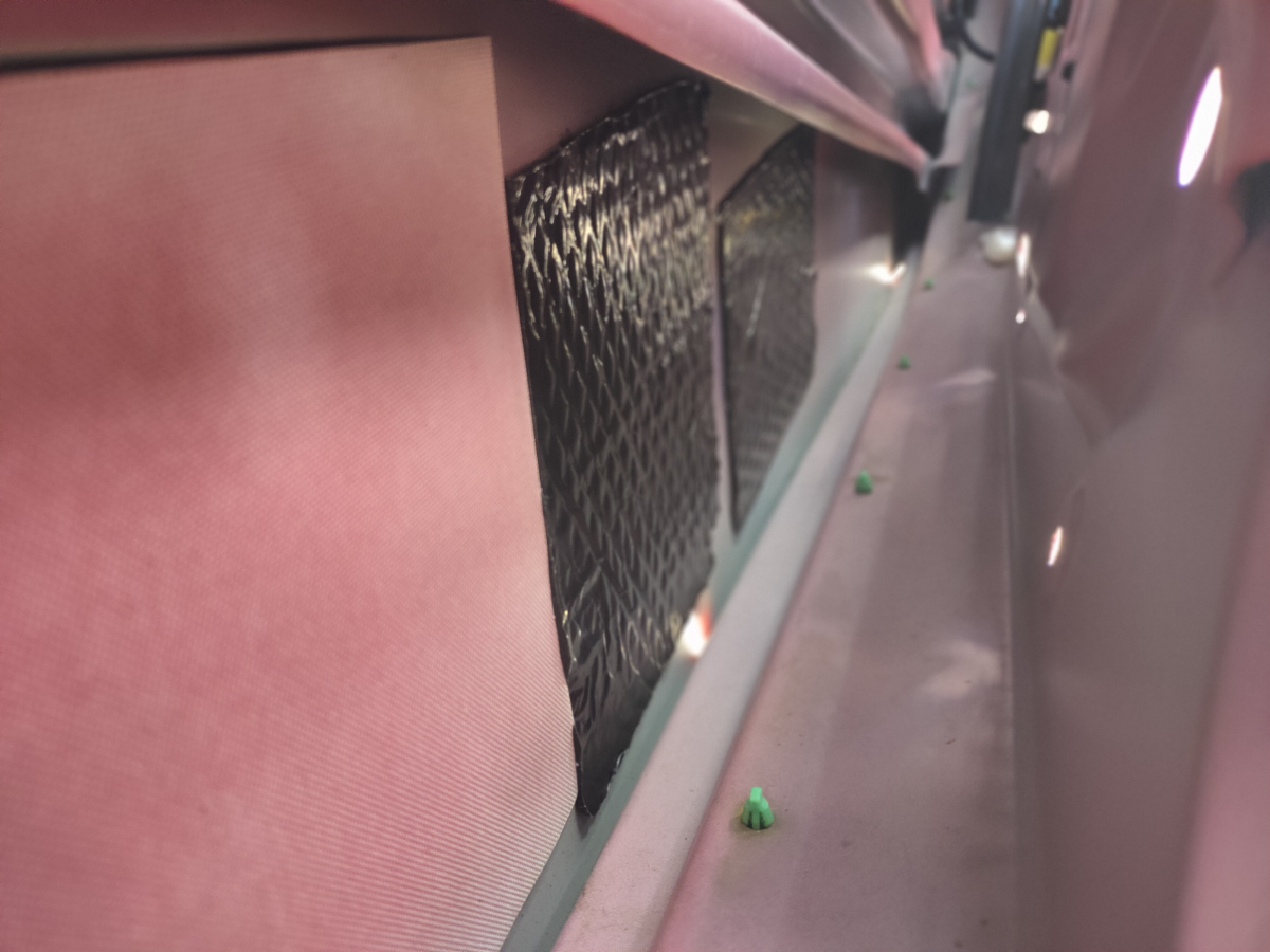

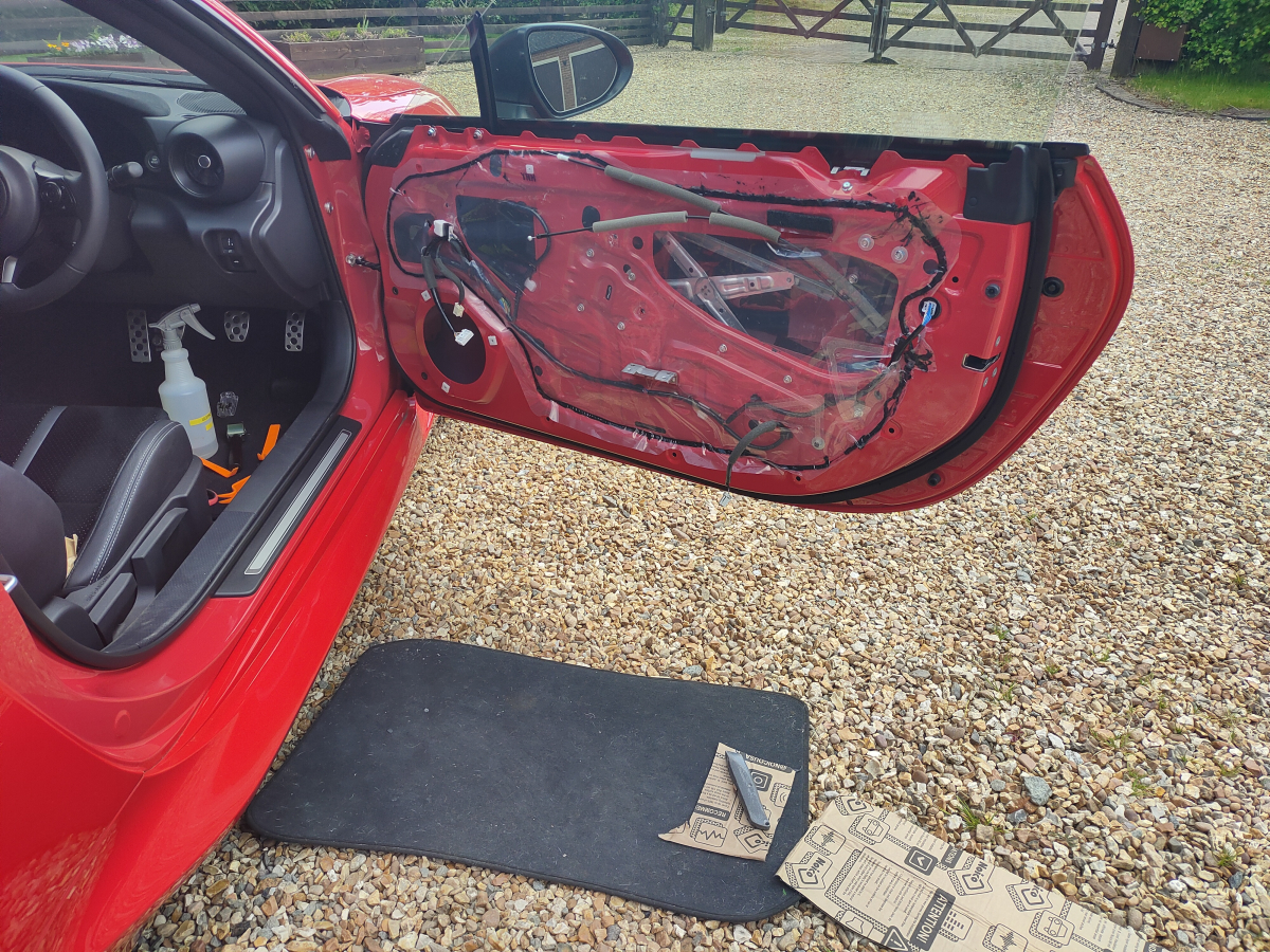

Put some sound deadening in the doors today after doing the rear a while back.
Went out tonight and the OH noticed how much quieter it was so must be worthwhile.
Was quite easy getting the door cards off and applying. Fiddly though and I didn't go overboard with trying to cover every square millimetre.
Was a bugger to flatten out but it was that warm I could flatten it down with my fingers and a plastic pry tool where the roller couldn't get to;
Giving a "knock" on the door in various places after certainly had a dead sound rather than a resonating one so must be doing something.

Glad to hear that's made a difference. Was it just the mats you put in, or foam too?

Any downsides to doing this Darren?
Might seem like an odd question, but I'm wondering if the reduced noise/improved refinement takes anything away from the (likeable in my view) rough and ready 90s JDM-style character and feel of the car?
Or is it all positives - character retained but added refinement?
Cheers!

It's still as "raw" as ever so I don't feel as though I've lost any of the '86ness after.
It's taken more of the resonances out of the car - the booming and hum rather than making it whisper quiet. At least the OH and I can have a conversation without raising voices like before.
A downside may be it's added a bit of weight but I'm not bothered as I don't drive it at ten tenths constantly.
