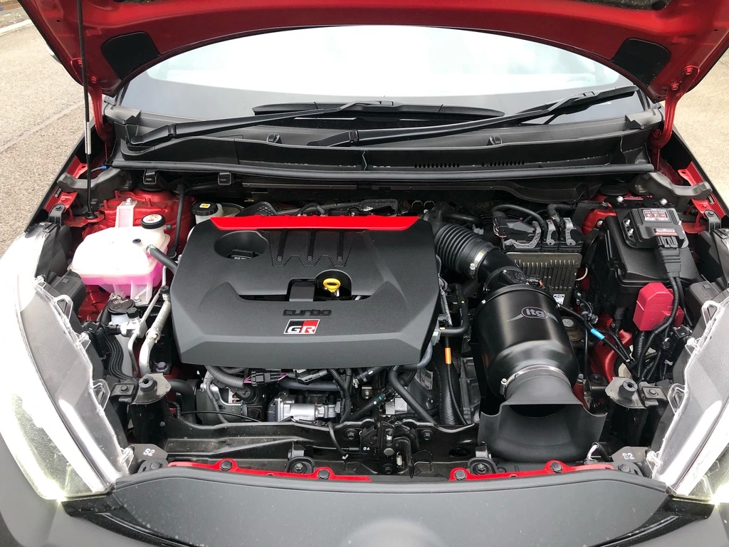

Richard has fittest the new ITG induction kit, which comprises a pick up from the front grill, then an enclosed cone type foam ITG filter which then feeds into the standard inlet.
The thinking behind this is that with the OEM setup, there is an open tube that feeds into the airbox. It is a complex setup with a flap that opens at 3500rpm to allow a greater amount of air into the airbox, though this air has to travel through the engine bay to get there. Now, I should add that there is a specific vent from the front grill to direct air in the general direction of where it would receive the air when the flap on the airbox is open.
The problem has been, of one of heat soak, particularly so at low speed and in hot conditions on the track. The ITG induction kit is designed so that the only air the engine is received is right from the grill with no chance of air from within the engine bay being sucked in.

What I’m noticing albeit on a bitterly cold winters day is that the intake temp is a lot more stable than it is with the stock setup. I can’t say that I’m feeling a big difference in how the car picks up and goes, but I feel that this new induction system, is going to reap further benefits on a hot track day or on a serious pass up the Yorkshire Dales in the summer. I also think it will help when sprinting as there is a fair bit of waiting on the line which is not good for heat soak.
