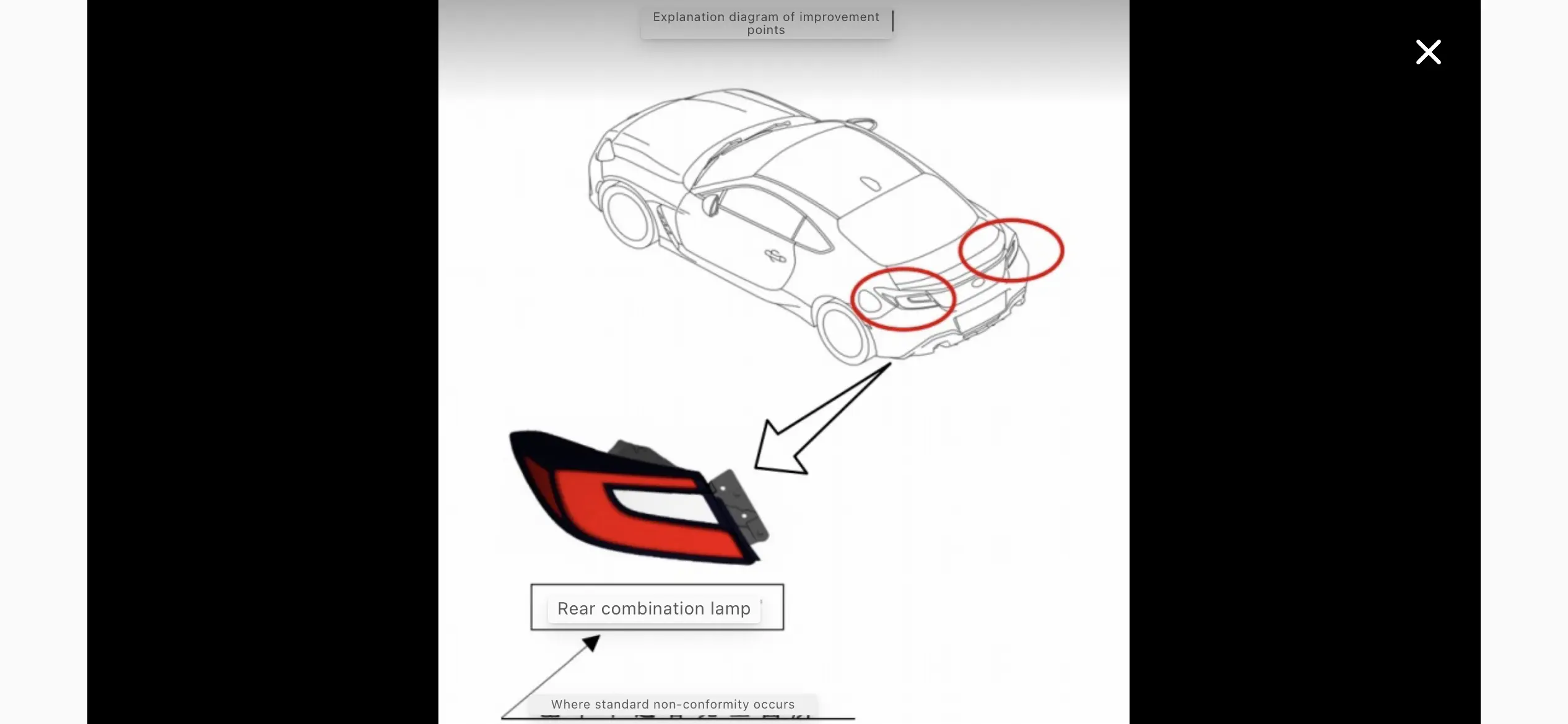

Toyota Japan just announced a recall for 7500 GR86( Also 5500 BRZ)).
Fault in rear lights.
Date is incorrect in press release.
We sincerely apologize for the inconvenience caused to everyone who uses it. Originally, we will repair it as soon as possible, but it takes time to prepare for the repair. Thank you for your understanding and cooperation for a while.
In addition, we will guide you again as soon as the repair is ready, so thank you.
You can check whether your favorite car is a target vehicle by searching for information such as recall.
In the rear combination lamp, due to insufficient electronic circuit settings of components, it may be difficult to raise the voltage to turn on the rear direction indicator and the rear emergency flashing indicator. Therefore, there is a risk that the rear direction indicator and the rear emergency flashing indicator will temporarily not light up.
2. Contents of improvement
All vehicles, the left and right rear combination lamps will be replaced with countermeasures.
3. Target vehicle

Recall of GR86
- Notification number 5368
Summary of the recall
1. The situation of the problemIn the rear combination lamp, due to insufficient electronic circuit settings of components, it may be difficult to raise the voltage to turn on the rear direction indicator and the rear emergency flashing indicator. Therefore, there is a risk that the rear direction indicator and the rear emergency flashing indicator will temporarily not light up.
3. Target vehicle
