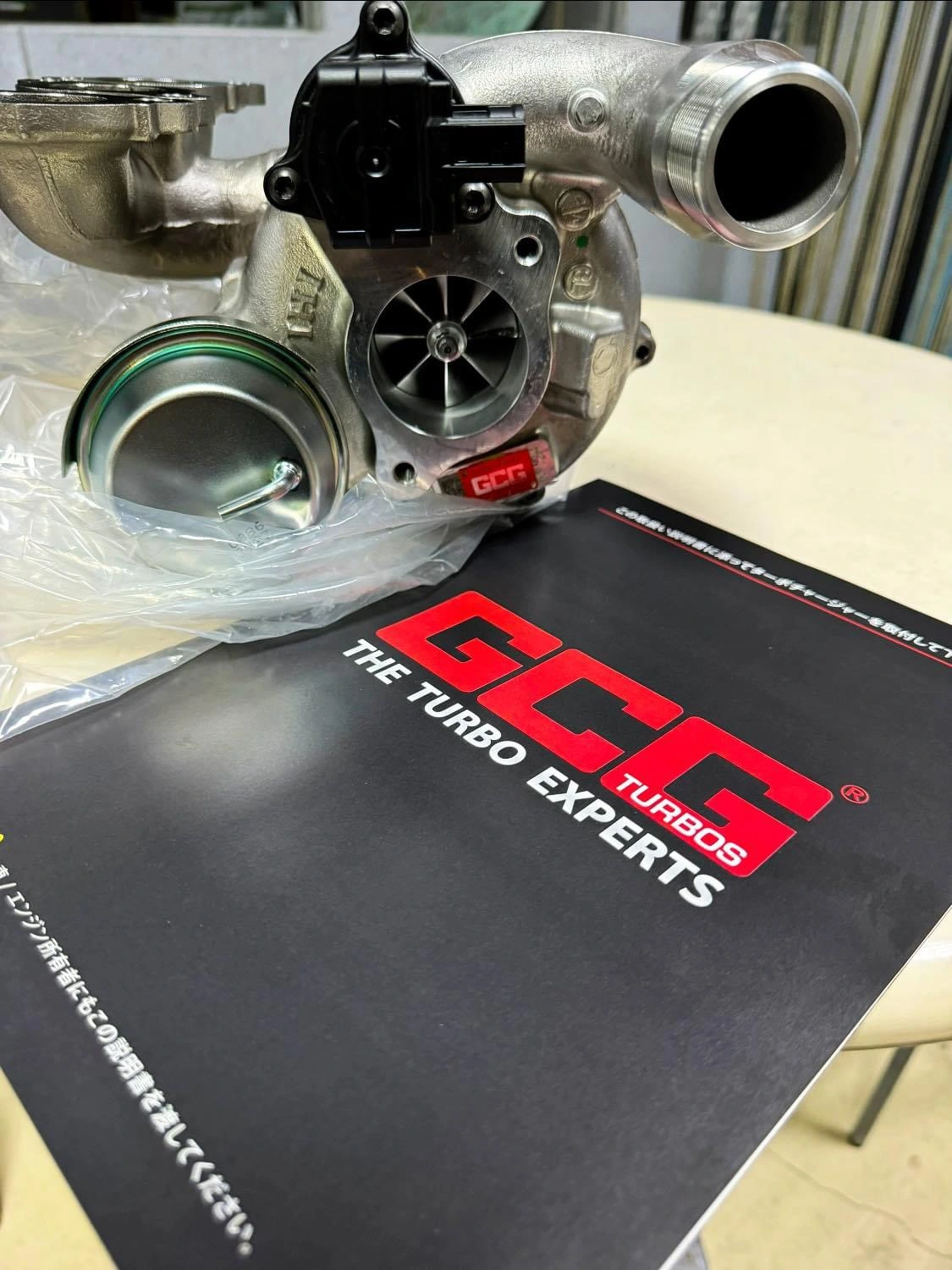

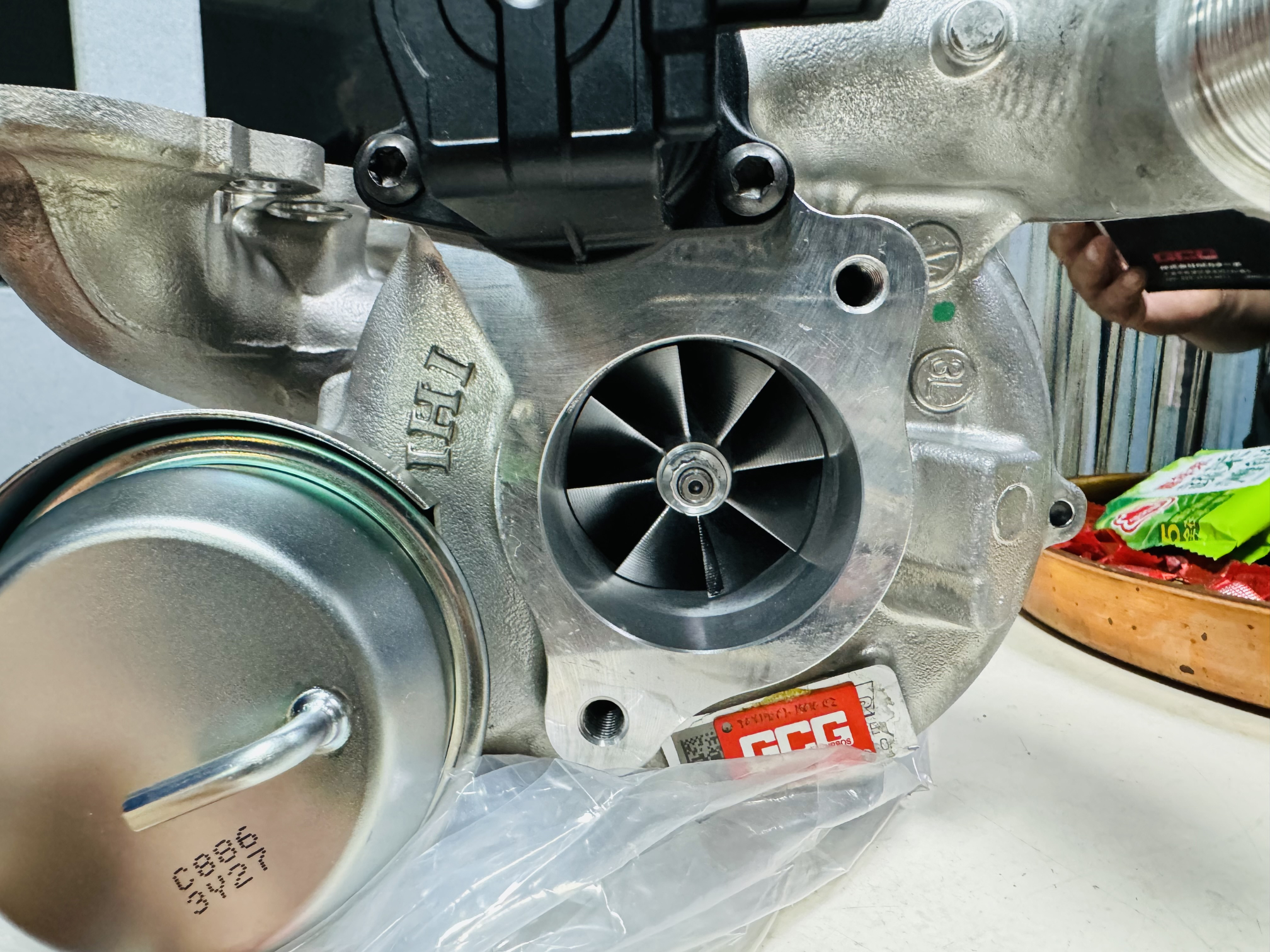

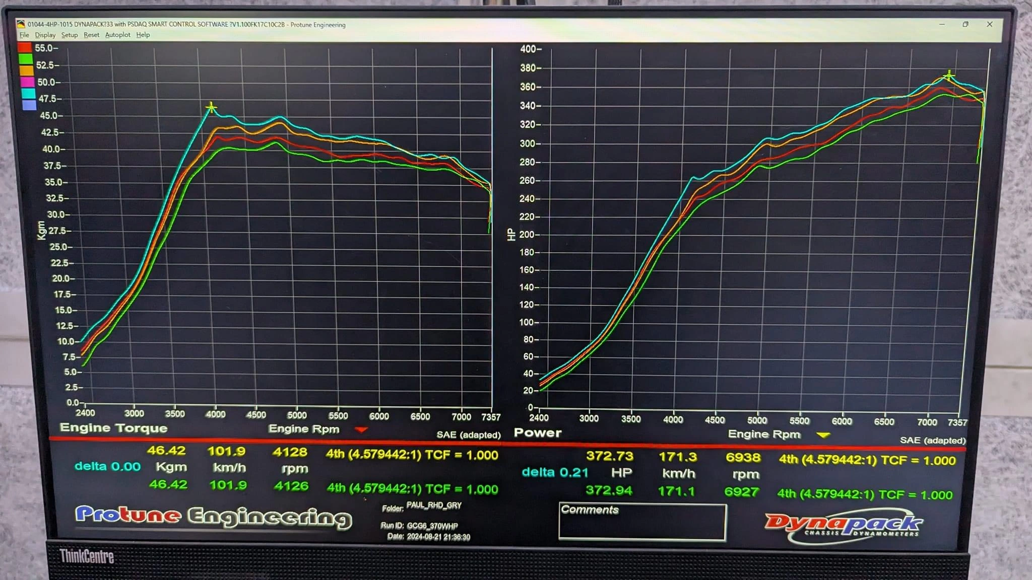

New product fRom GCG turbo japan
It say it hacve new wheel on intake and exhaust side with improve ball bearing , build only from new turbo
i my self use their hybird turbo on my rx7 race car for a good result ,
Wonder how this compare to other ? Most Hybird turbines retain stock exhaust side and stock ball bearing

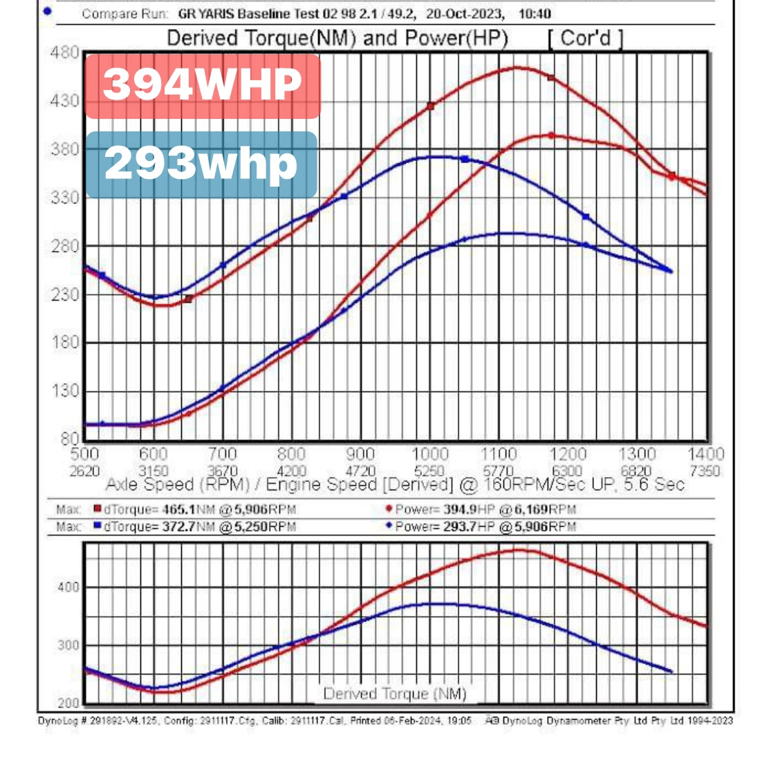

is the graph with same boost setting? impressive results if such. Confess having a perversion for low boost high power engines.

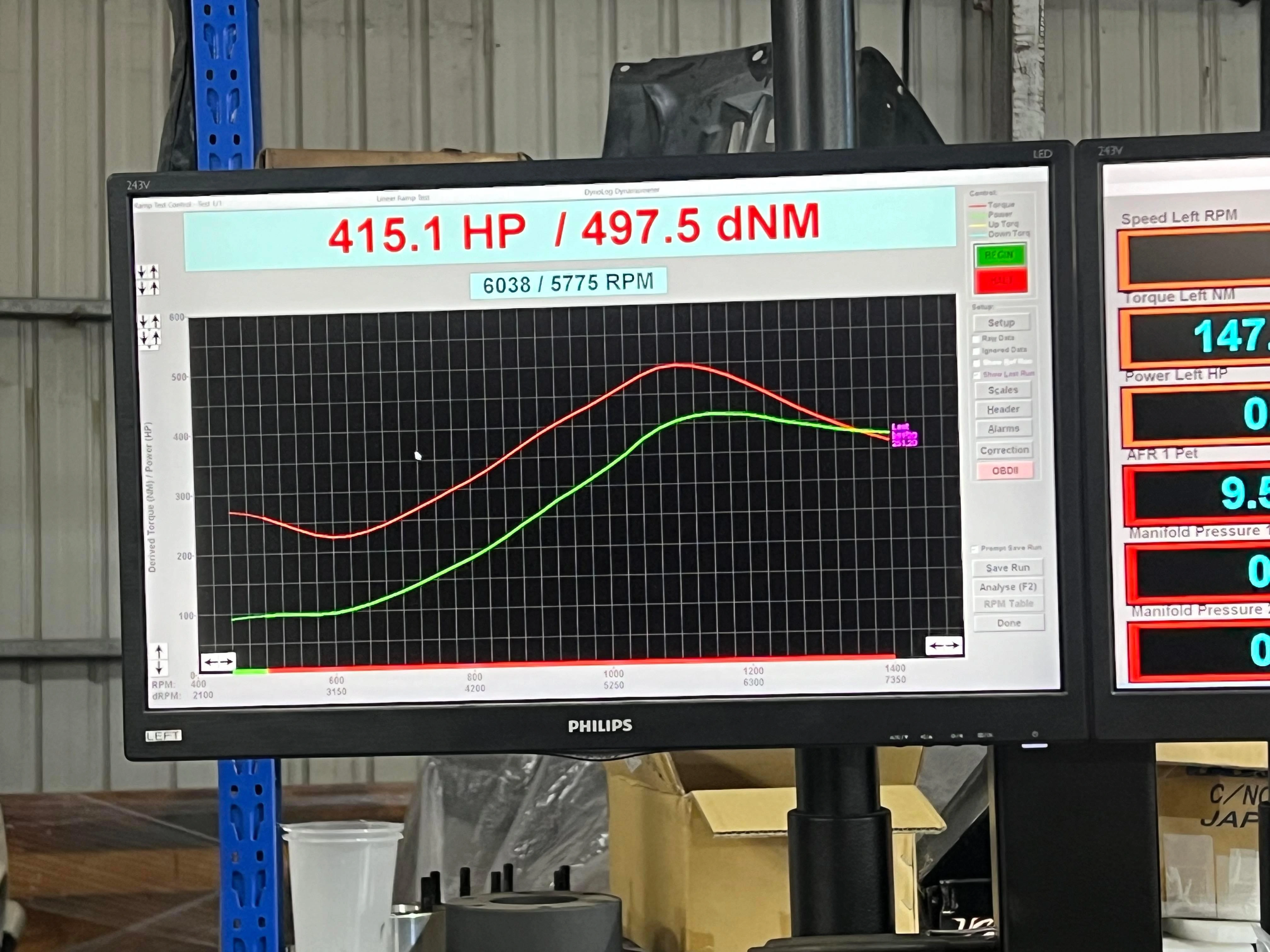

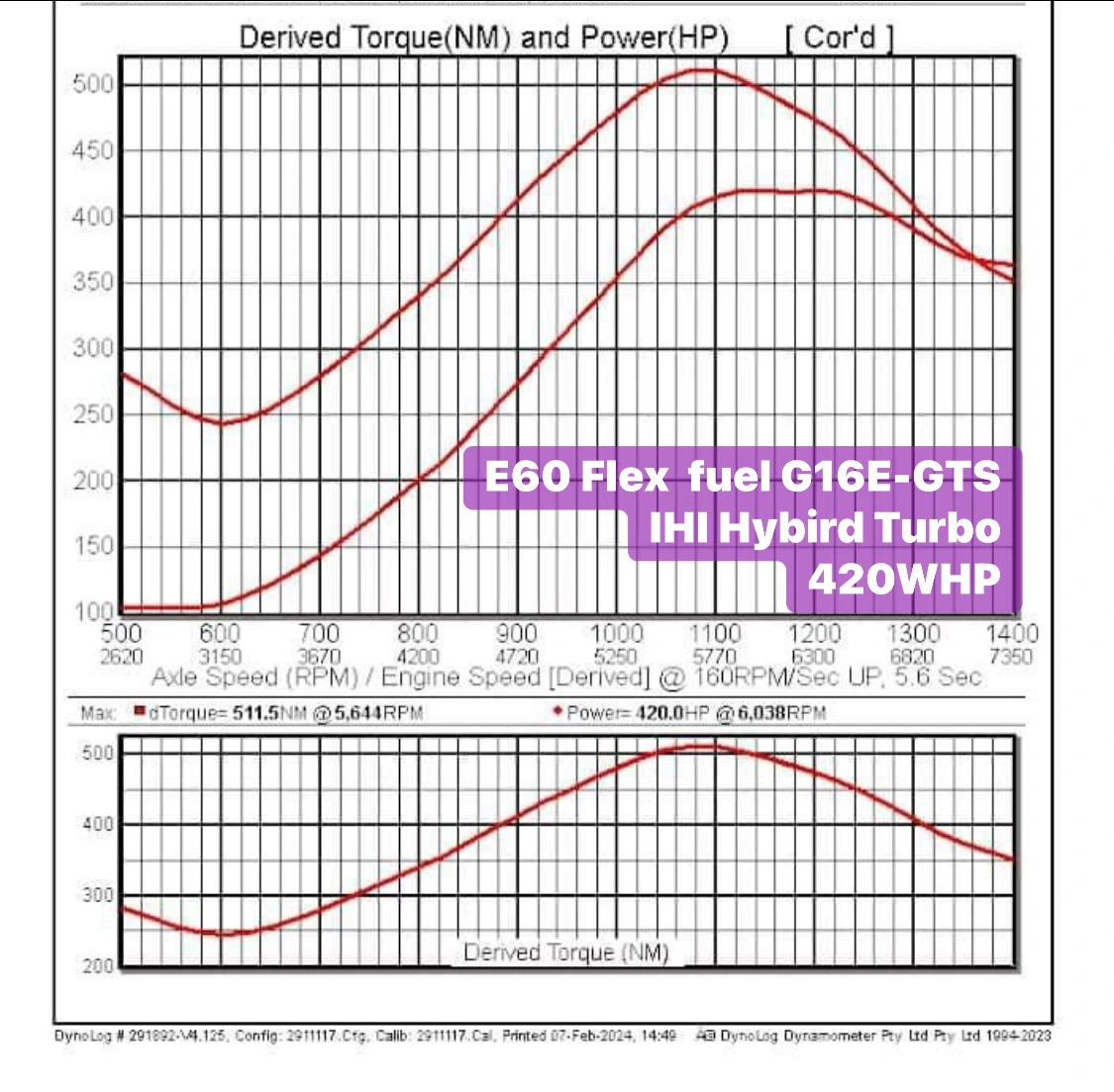

Making over 100whp with pump gas
And same boost level compare to stock turbo
Amazing little engine with right mod
Turbo lag roughly increase by 800rpm
Which is pretty mild for track car consider
U gain 100whp afterwards
Any special reason your torque curves look so strange? Very low at 4000rpm and very high at 6000rpm. Still original engine internals?

What are the specific improvements in the ball bearings? Are they higher-grade materials, improved lubrication, or different bearing type (e.g., ceramic)? Knowing the specifics gives a better picture of their potential benefits.

Is there trade serect ?
But like i GCG is big enough to do correct product
Unlike some new type company
