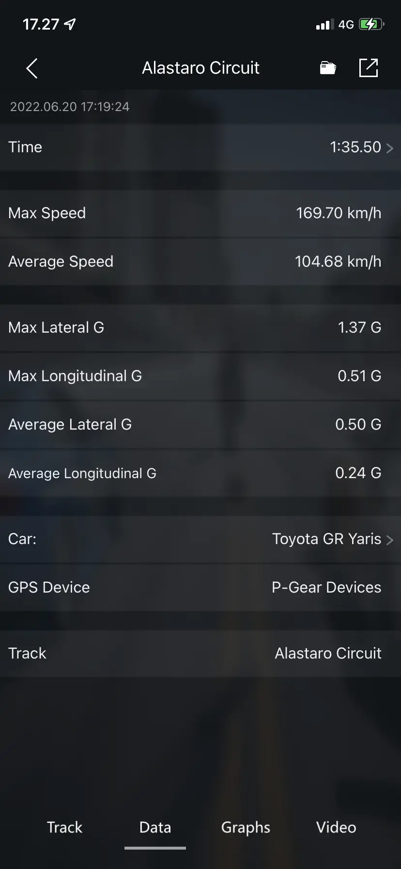

Visited today new faster track. Car overall ok and same issues - on longer turns it understeers like pig so maybe need to check that -3'C degree front camber - was there any negatives in terms of tire wear in street use?
Another concern noted that after two fast laps oil pressure got really low - didn't get much above 2.3-2.5bar mark (was looking the factory gauge so not really precise) - GRC has the limit of min 2.2bar at 3k, but pressure did not seem to get any higher even with higher rpm. Got me thinking that is not enough and maybe should look for heavier oil for track use in summer. Water and oil temps were ok, water did not ever go above 100'C and oils at 120-125'C.
Got the power steering issue usually in two corners on the track, so it was there again.
