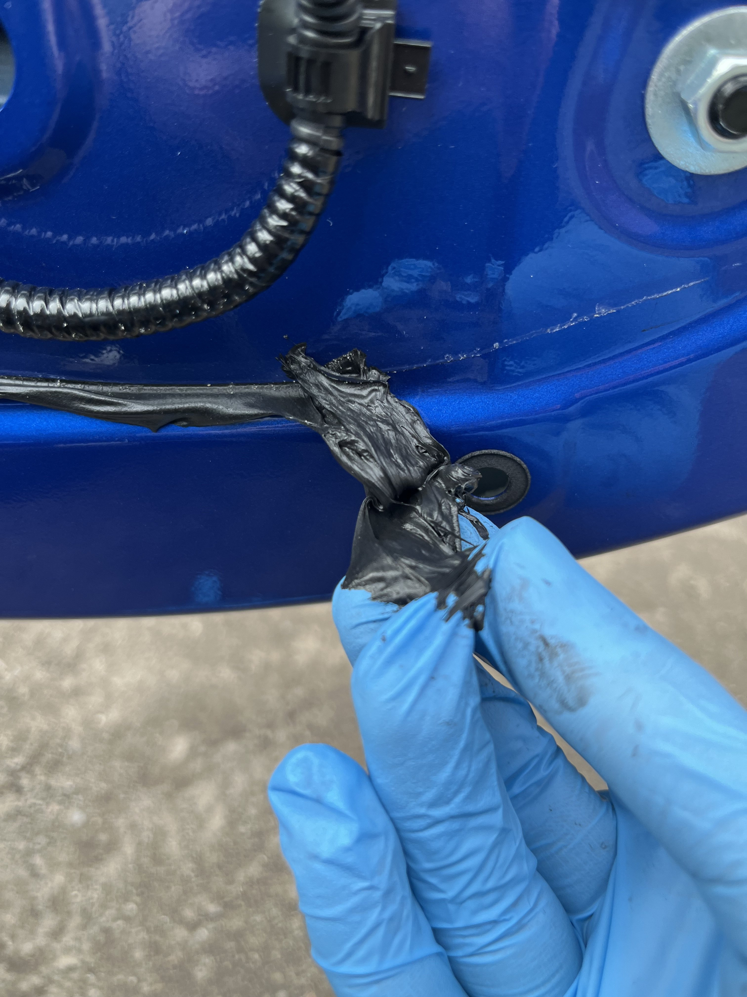

Guys, is this black glue thing (silicon or just glue?) hard to remove? I’m debating if I need some kind of special alcohol to clean it.

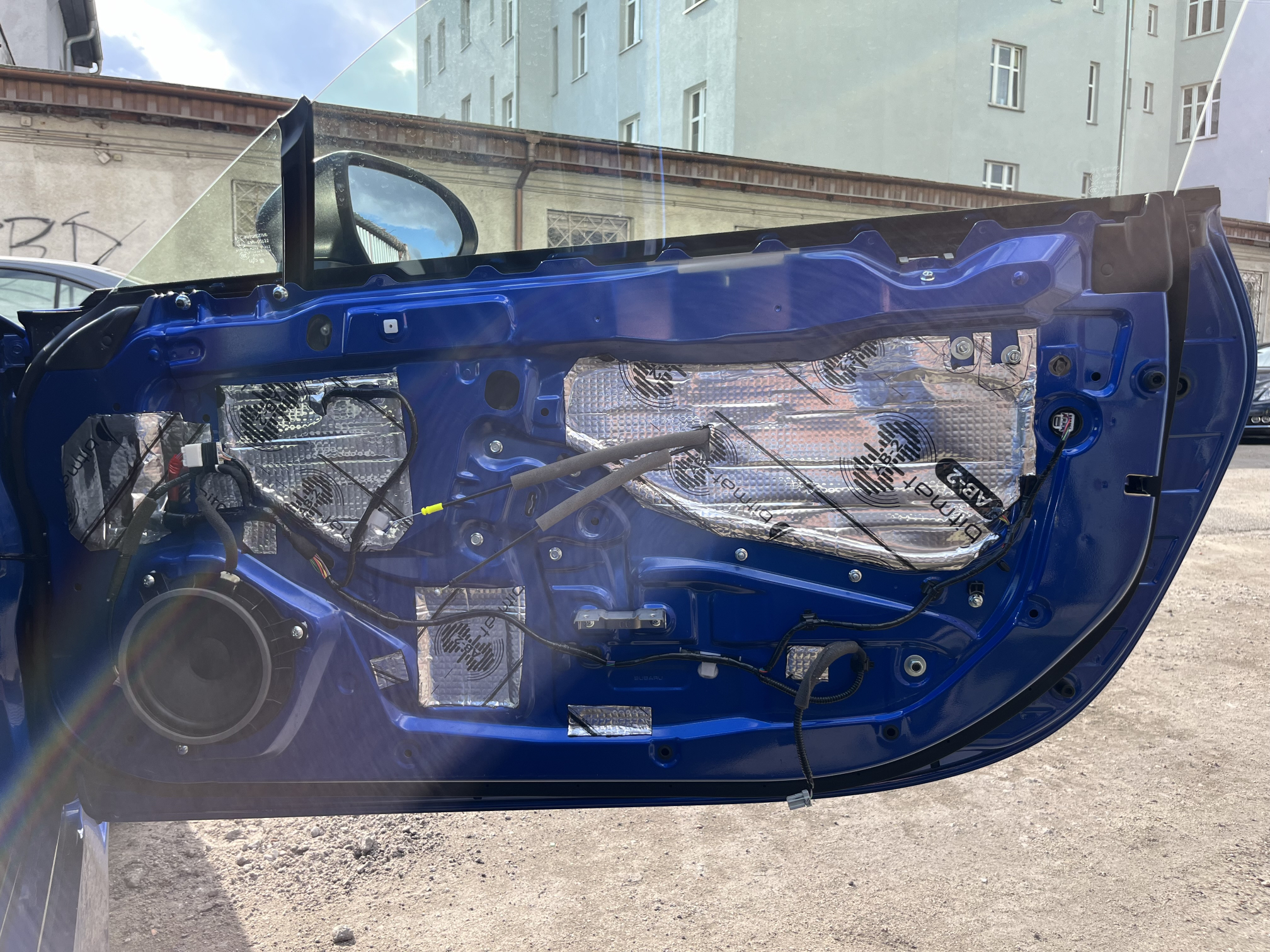

Today I went to garage to play around.
Starting from my observations and inputs.
All spoken on this thread is valid and easily explained. The process is absurdly simple and there is nothing to break. Couple dummy plugs, screws and you are good to go. Tweeters are doable within 15 minutes, I'd recommend doing them "in spare moment" to not add additional time for the doors.
If you are still scared, watch this guy, he goes over the same procedure step by step.
NOTE, Focal tweeters don't need that much of a hassle, just pick adapter and you are good to go.
For people upgrading only audio, total spent time would be 1hr for whole car, it's dead simple. Others, myself included, if you are using mats to deaden the car, it's a little bit tricker. I did it first time and for passenger doors alone, it took me almost 4 hours.
The black glue, holding the plastic... It stretched like a fudge, cheese, sticks like hell but there I a good part as well. You can simply "pull" the glue, and then when it's on your gloves, just use it to get rest of the glue from the frame - you will create "snowball", or in this case, "glue ball" (see my pic with the glove). Afterwards, it's easy as hell, you don't need any tar remover as glue sticks more to itself than to the metal doors.
Take the plastic tools to extract any pins left from door shell, to the metal inside frame. Also watch out for silicone rubber grommets that are attached to the pins - you can easily drop them and miss em when assembling.
I've managed to do only passenger side so can't really tell much about the audio but first inputs - it's noticeable that right doors sounds better :) I'll wrap up driver side and give it a fly.
Lastly, as presented by other guy from UK, 2:29 moment.
If you don't want to add necessary weight to the car, just swap the speakers, I'd suggest buying thick PPF foil and just cover all of the holes. It will weight next to nothing, serve its purpose by stopping the water but you will mitigate the resonating sounds from the foil itself - think about it, you already disassembled the doors, it's one step above and it doesn't require anything fancy, scissors alone will do the trick.
