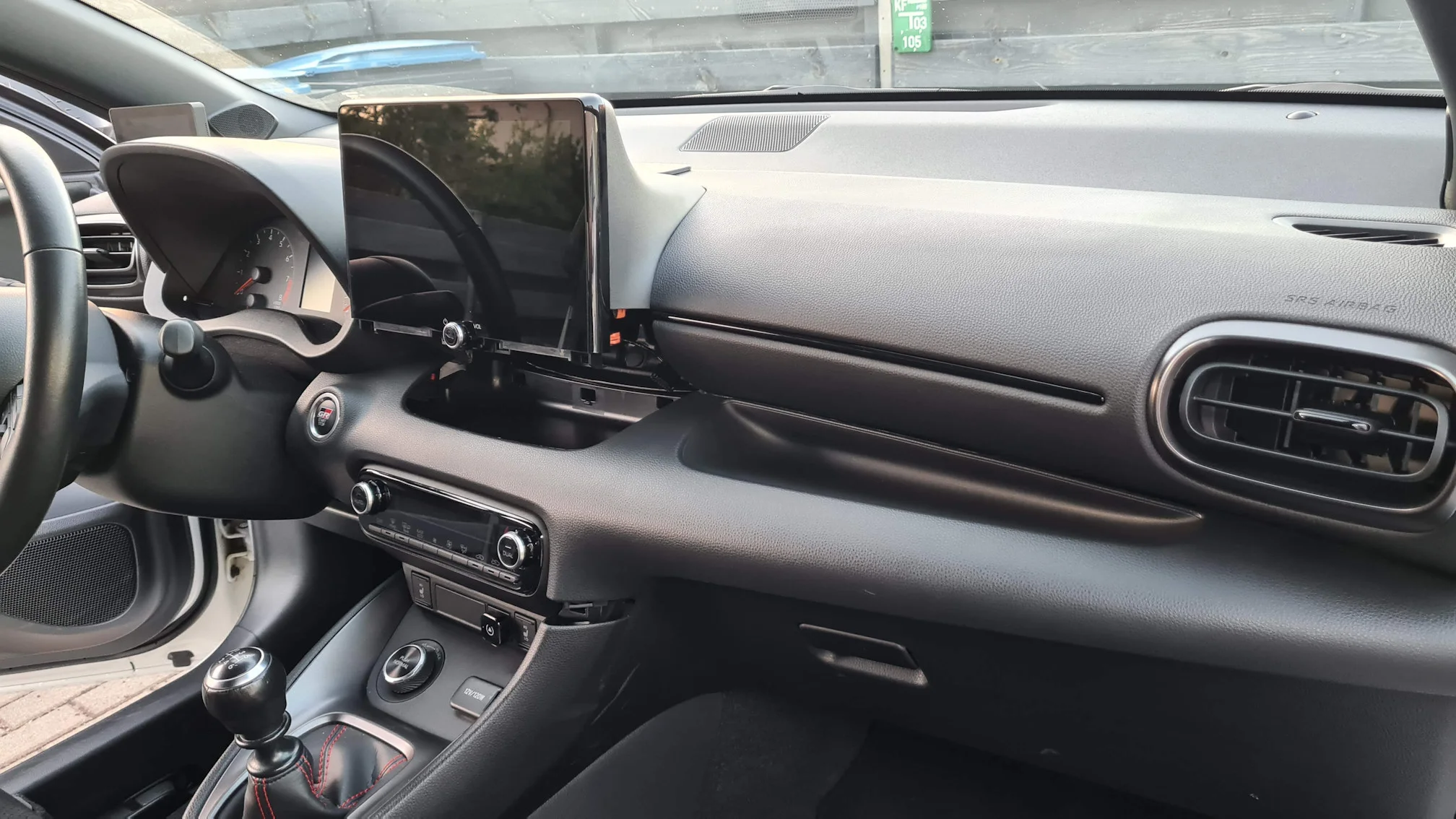

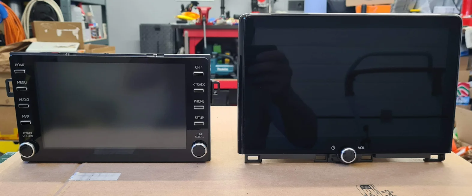

After seeing @yuri1312 's great thread on retrofitting a Yaris Cross Headunit in his GRY, I started wondering if it is possible to retrofit the headunit from the facelifted regular Yaris (not the facelift GR Yaris. As you may know the dash layout remained very similar between prefacelift and facelift Yaris so I think this could make a very interesting project.
Main positives would be:
  • Wireless Carplay
  • Higher resolution screen
  • Retaining the volume dial (instead of the buttons found on the Yaris Cross Headunit)
  • Cleaner look without the useless buttons left and right of the screen
I am a complete noob when it comes to these things so I would love to hear your opinions if this would be possible, what would be the downsides and where to start the research?
Thank you!

Hi GR17, did you continue your researches? Did you find something new? I recently had an experience with the cross unit and I ended up restoring the old head unit. This radio seems much better though.

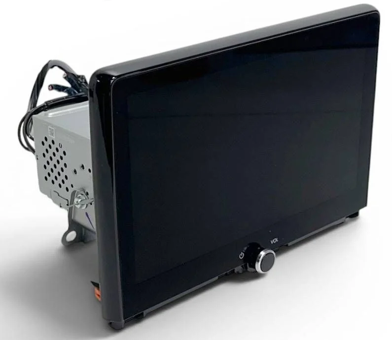

I found some images of the unit on a website but the price they were asking was around 700 Euros which is a bit too high for me. I think I noticed a difference in the ports on the back but those with more experience can chime in if the ports are right for our cars or not:
Here is the link if you want to buy and give it a shot.
I found the same part and also other with even higher prices. The 12V input socket is different so I guess you would have to adapt it with an harness. Also the signal ports seem different to me so I think a swap would be a bit more complicated with respect to the YP031 unit
