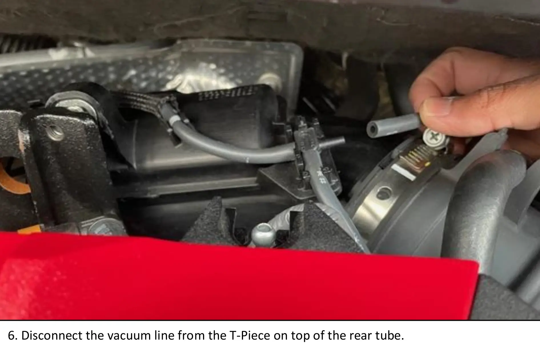

Treated myself to an early Christmas present and fitting an Eventuri intake today :)

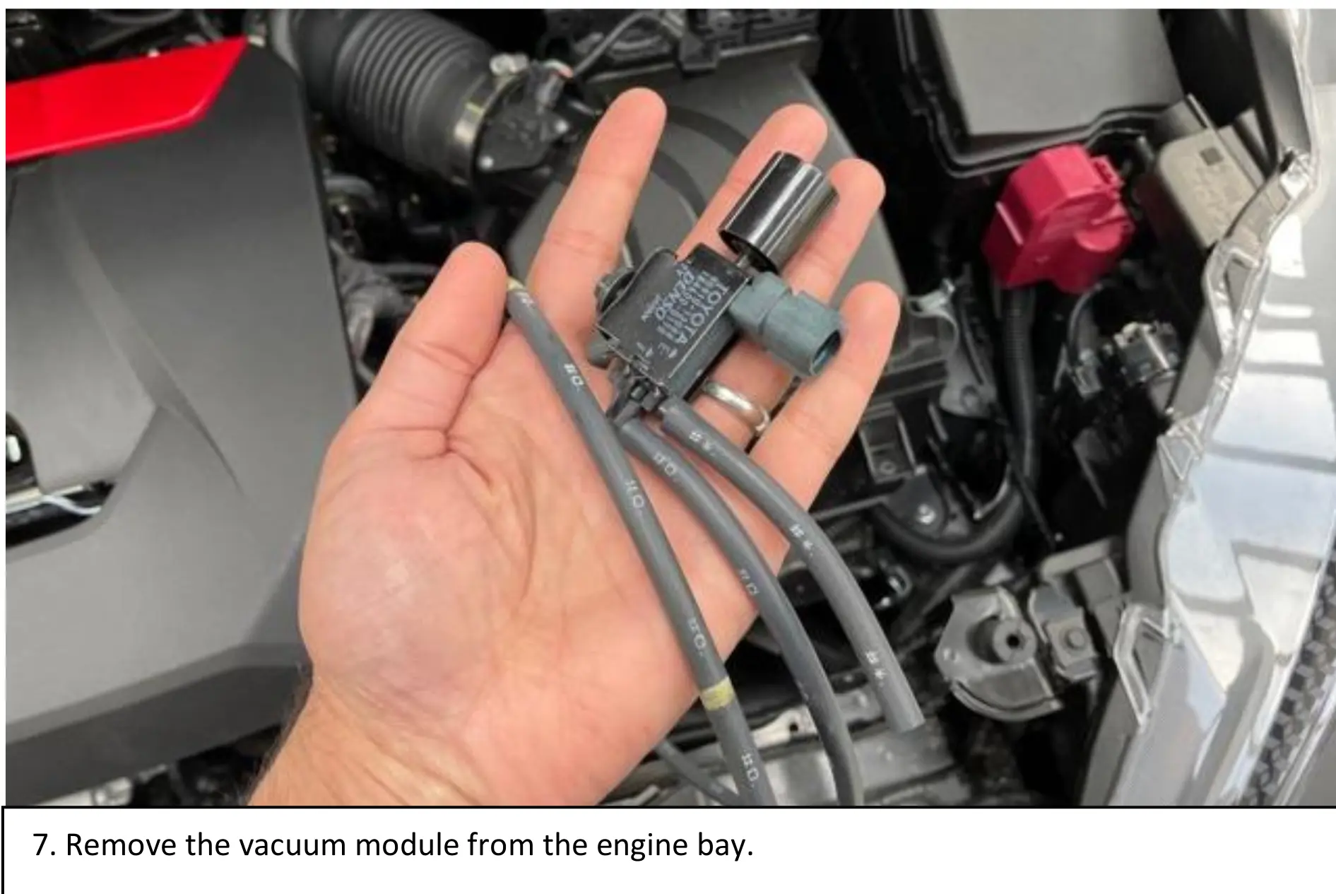

The instructions say to remove the vacuum module from the stock intake, to block off the T junction, and then makes no further reference to it.
Reading around on the Internet though, it seems like I'll get a code if the module isn't connected - so wondering what other have done with it?
Also curious what it's actually doing if not strictly needed?

You do get a code. But you do not get an Engine Light
I have reset the ECU about a dozen times, and it comes back at every startup. You won't know about it unless you read the codes using a scan-tool however

I actually left the vacuum module plugged in and cable tied out of the way, so all good on that front.

The Eventuri isn't cheap, but the design, fit and fabrication quality is first class. In reality it's over engineered in terms of performance potential for the OEM GR Yaris turbo. We're currently working on a full frame turbo/Eventuri intake combination. I suspect the Eventuri will perform really well at higher power levels.
The vacuum module is only relevant when using the OEM airbox. As has been said, this opens a flap on the airbox. Remove the module and vac hoses completely and fit the cap supplied to the T piece (see step 6 photo above).
