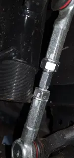

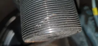

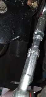

Recently installed coilovers and noticed some witness marks of the end links hitting them when close to full lock. I wish Fensport had noticed this but they didn't.
I tried the verus engineering steering limiter kit and put 3 of the spacers and that wasn't enough, that took about 1/4 turn away.
I did, installed Whiteline front sway bars with their endlinks
I fixed the issue, I raised coil overs ride height 1/2 inch and installed and tightened sway bar end links while car is fully loaded (on the ground). Will lower car more in the future and will install other aftermarket parts such as sway bars, and control arms for front&rear. Right now, I just want the knocking to go away. Will get an alignment in 2 days, hopefully there wont be any knocking noises after…
