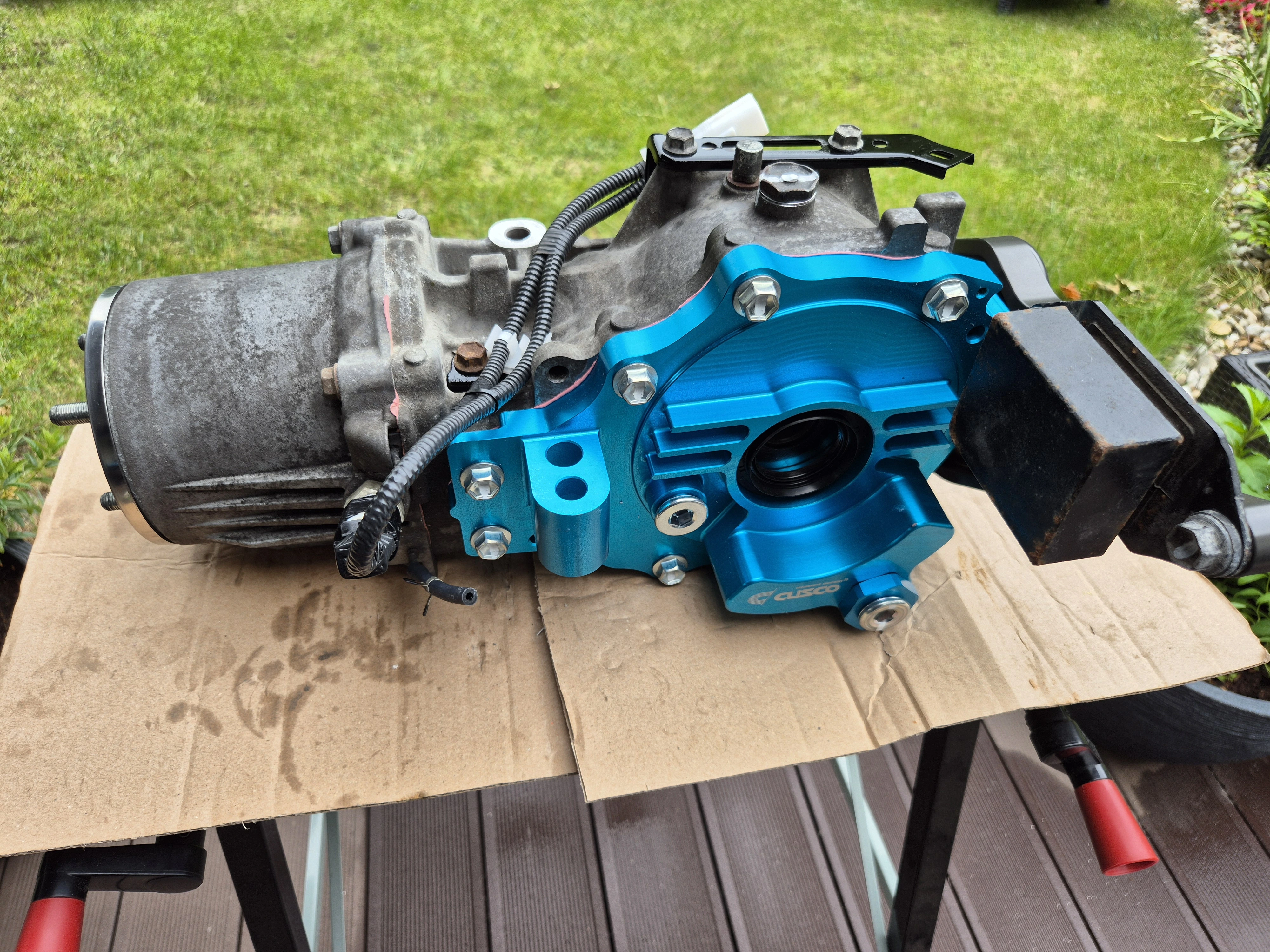

I've fitted a Cusco 1 (1way) together with the "Kalle 50/50 gear set".
Performance-wise it's a very nice improvement. The car behaves much more like a traditional 4x4 and understeers less.
You can step on the gas much earlier and get a nice touch of oversteer.
However I don't know if the set has been installed correctly.
Even after almost 2.000km and two oil changes the Cusco still makes creaking noises under acceleration in curves.
I don't think this is normal!
Has anyone here experience with the Cusco rear LSD?
And, how does it compare to a Quaife rear LSD?
I wouldn't like to return to the OEM torsen diff. ...
Thanks for your input

Not entirely sure if the noise you're hearing is from the clutch plates engaging, incorrect preload/backlash setup, or just not fully broken in yet — but in general, plate-type LSDs are definitely noisier than Torsen-style diffs.
I recently upgraded my rear diff with an OS Giken unit. I'm currently working on installing an equal-ratio transfer gear set, so I haven’t had the chance to test how it feels or sounds yet.
That said, getting the shimming right during installation was a tedious process — but it's crucial if you want the LSD to perform properly and avoid unnecessary wear or noise.
Thanks! The not correctly performed shimming is also my suscpicion. I will have to control it.

Im pretty sure what youre hearing is supposed to be normal.
The Cusco diff most likely has a high preload thats why its so loud.
Torsen diffs are known to be quiet but there are also Clutch Plate LSD's with a low preload that are known to quiet (Drexler for example).
If the bearing preload would be too tight or too loose you would hear it also on the straights not just the turns and the noise would be louder with higher speeds.
Thank you, that sounds comprehensible.
