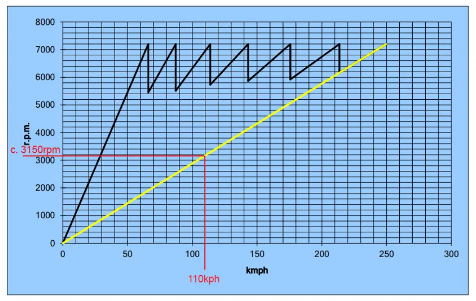

Just wanted to clear up that I spoke too soon, i've ordered the XShift box not the Kotouc. Went for the 12/51 gearing in the end, 7th is a little shorter than OEM 6th but the difference in fuel economy will only be about 2mpg with it running 400rpm or so higher at 110kph. Sticking the info in here until I make a proper post about it which I probably won't but maybe. Nothing like a time traveller coming back in 10 years wondering where one specific bit of info is to fix their car hahaha.
This info was kindly provided by XShift for comparison. Set to 7200rpm to calculate theoretical VMAX and rpm in 7th at cruising speeds. As you can see at 110kph (close enough to 70mph) the engine will be about 400rpm higher in 7th with the XShift but with my current aero setup I have so much drag at high speed I could use the shorter gears and just deal with the approx 15% penalty to fuel economy. when you're averaging about 18mpg anyway it doesn't really make much difference :(
VMAX will come down from a theoretical 286kph to 250kph but I can't remember the last time I went over 200kph anyway so that's fine. Again, with aero drag my 100-200 time is 16s which is worse than even a stock car, my gearing choice has been based purely on acceleration and in-gear punch.

7 speed 12/51 ratio -
