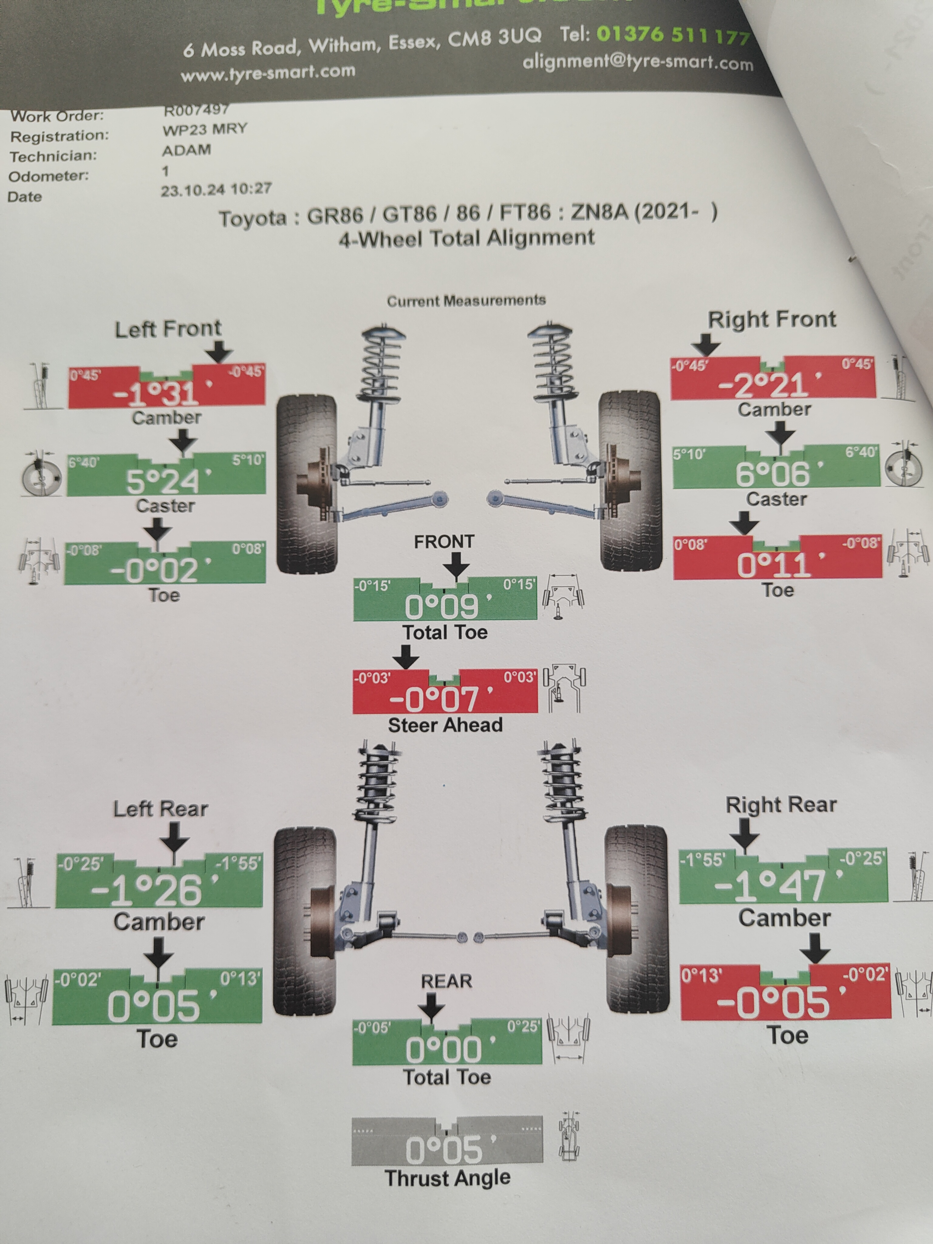

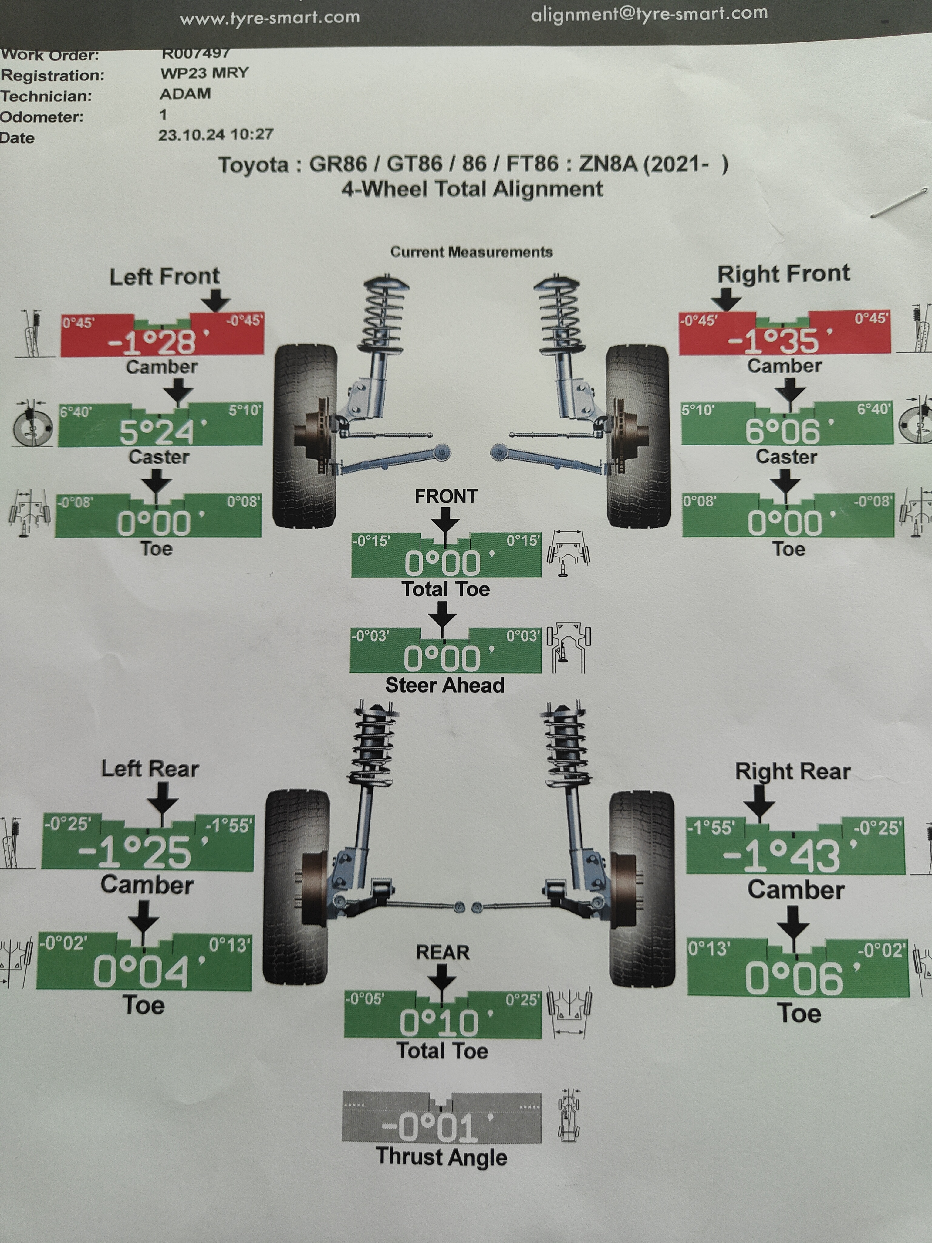

I hada 4 wheel alignment after installing camber bolts. It feels alot more tied down and I've not gone for anything aggressive. The settings from factory were probably contributing to a slight floaty feeling at times. View attachment 32044
